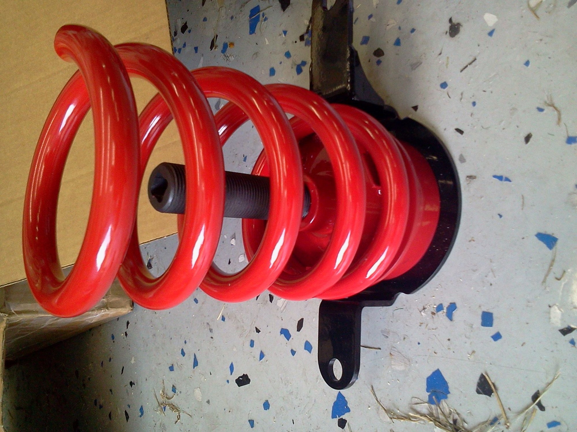

I have Ground Control weight jacks with 800lb springs. The adjustments are a breeze and the ride isn’t too bad.

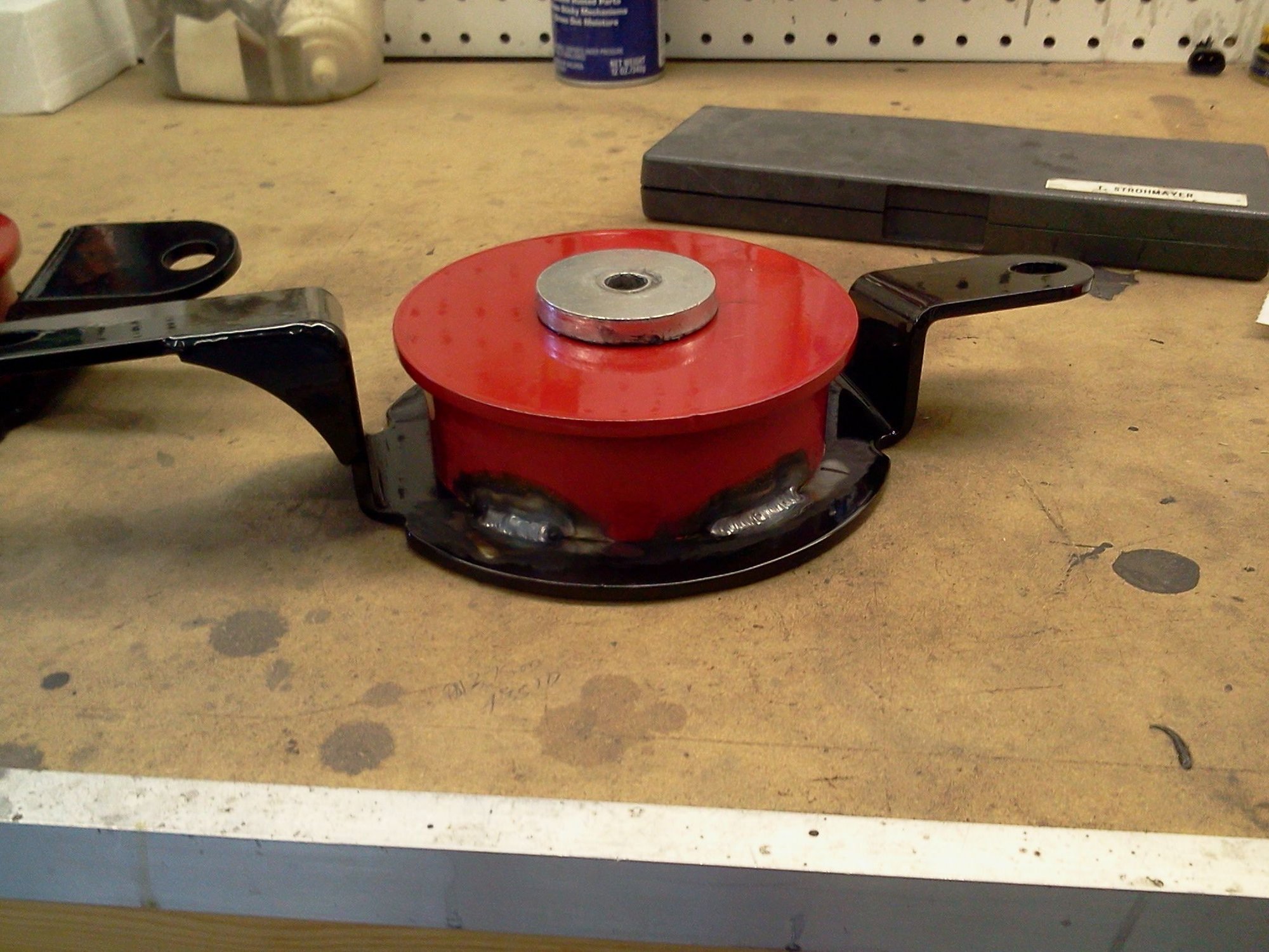

I looked at UMIs and theirs is subtly different. Looks like the Ground control has more adjustment maybe. The overall concept looks the same. I welded mine to the sling perches that came with my UMI k-member.
