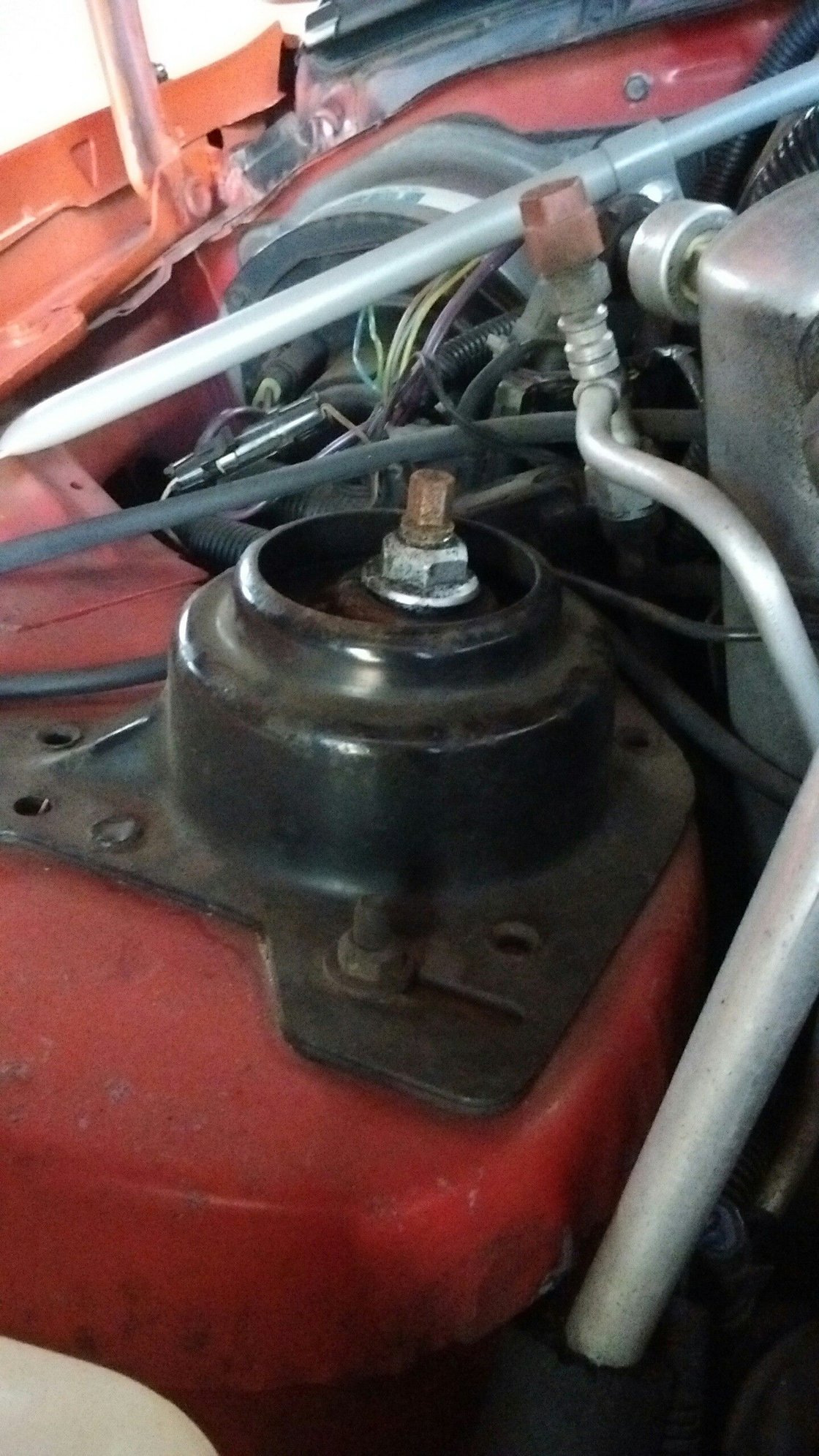

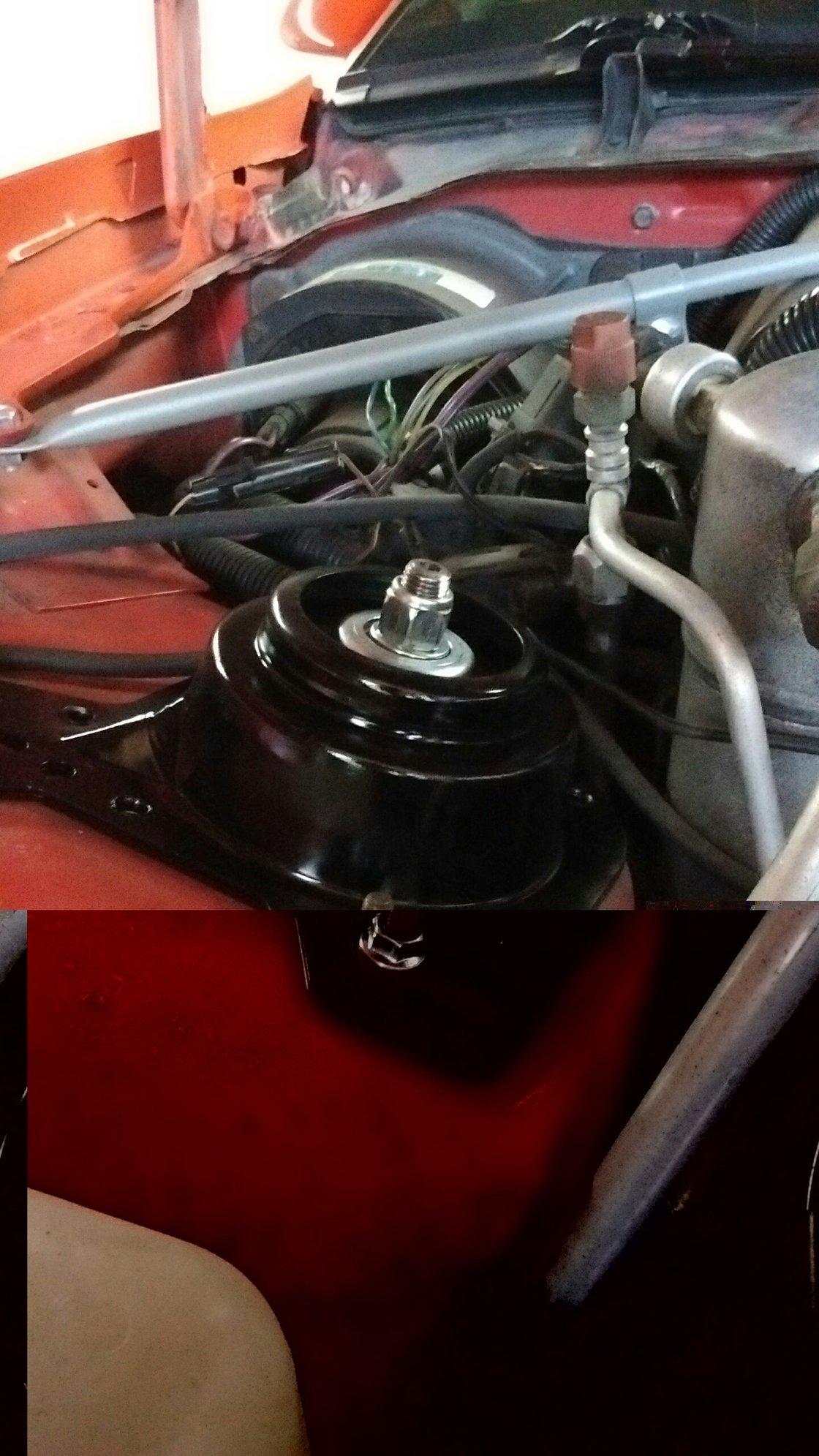

Bad strut mounts can cause a clunk too, the rubber deteriorates and allows play. See how the old one is off center and the new one is on center, it's worth a look if ya haven't already

Great point - I had already done my shocks so I knew those were good - definitely something the OP should check out
sounds good I’ll give that a shot.
