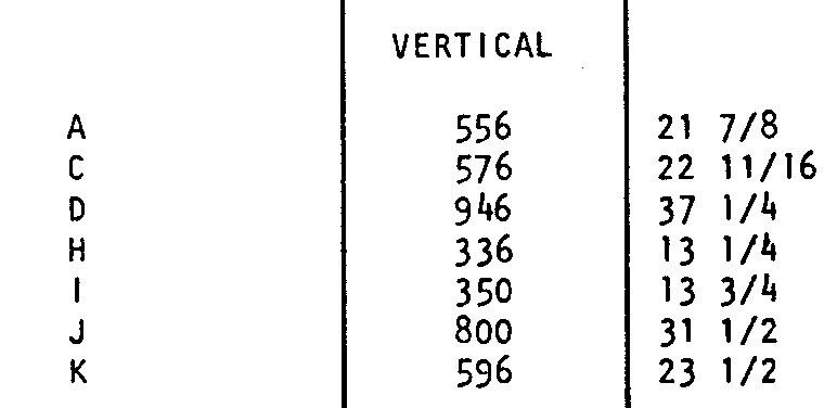

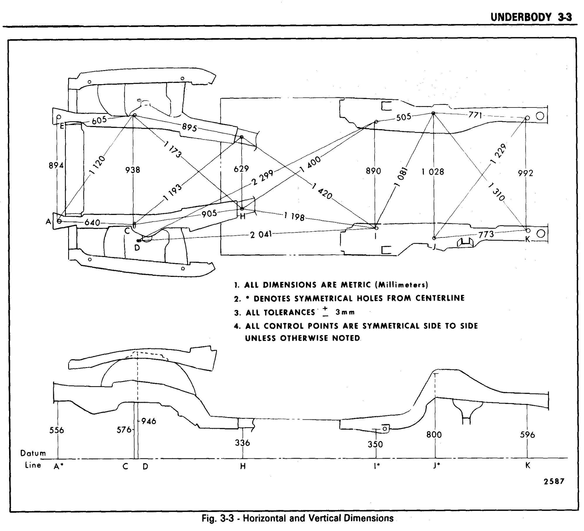

Frame shops notwithstanding, if your unibody is bent like a trapezoid from a collision, it may be that subframe connectors are the least of your concerns.
However, with a nice level floor, and a chassis that isn't mangled, you should be able to determine the measurements in the bottom graphic of the image posted below.
Once you've established that the chassis is "level" to the ground, the SFC's can follow with whatever means you have to get the car sufficiently high enough to work on.

Additional data for referring to the picture above.
