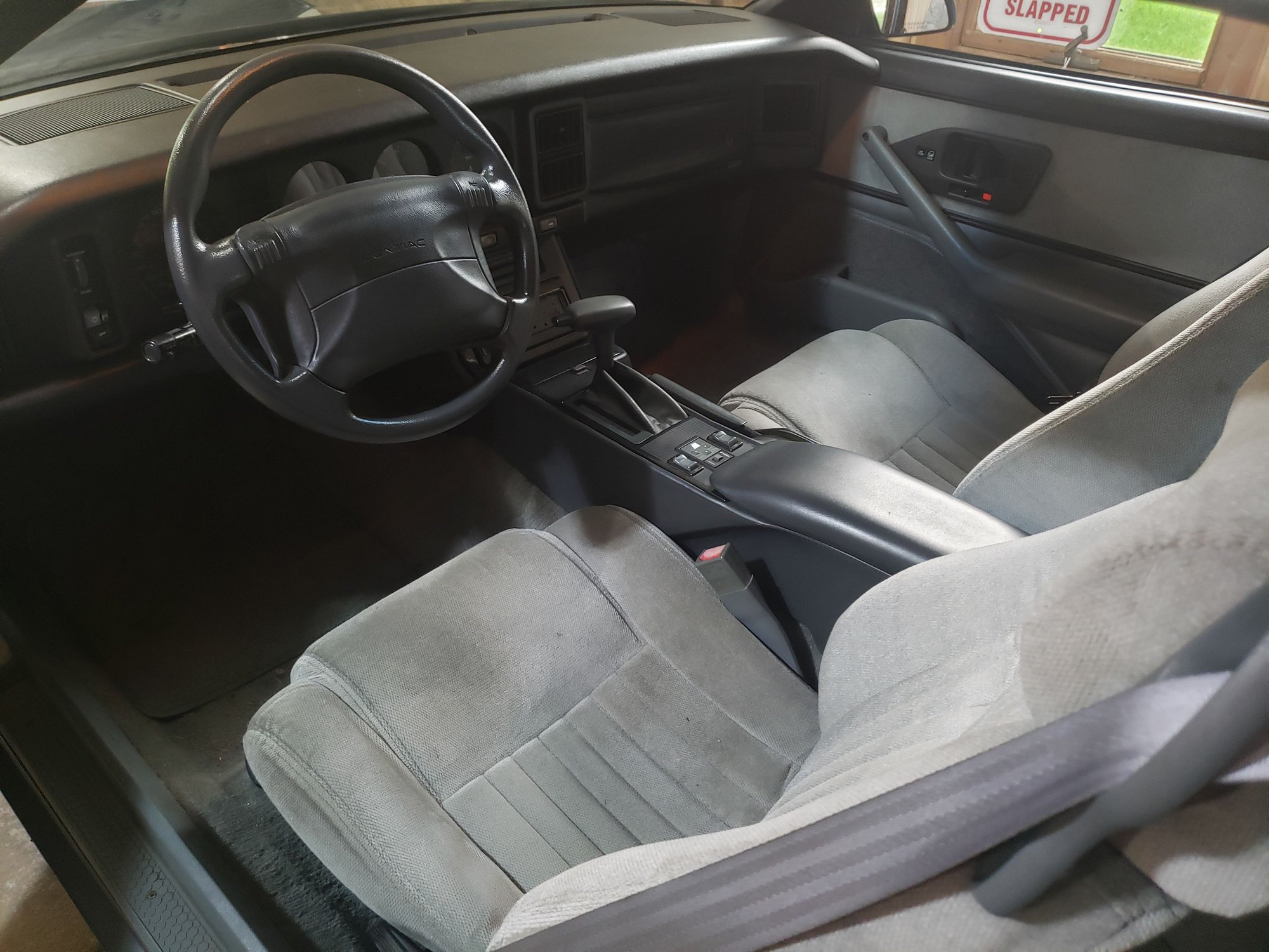

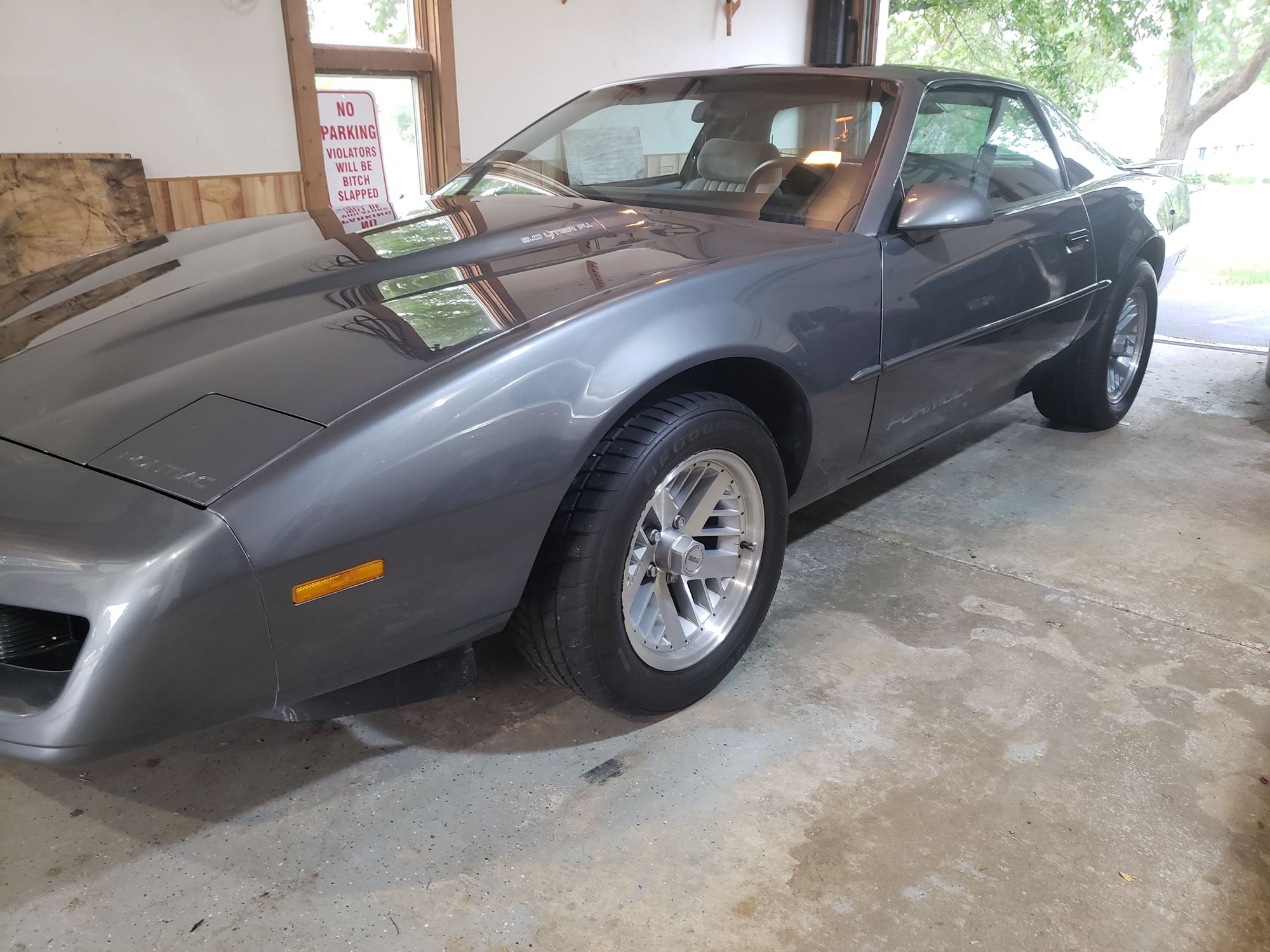

Sorry for the lack of sway bar input (all my thoughts have already been covered), but I demand pictures of this all original 50k mile 91 formula for my viewing pleasure :-) any chance you are considering selling?

here are a few pictures. Too attached to sell her.
wow gunmetal grey too!! beautiful formula, understandable, thanks for the pics!

Great looking formula!
