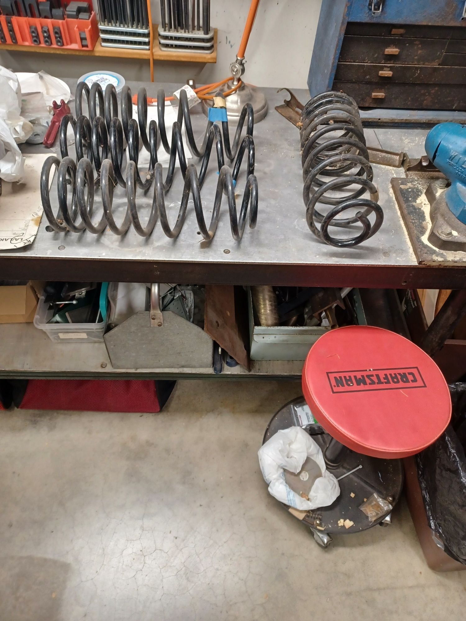

I will give an update of where I at with what parts I'm re-using or replacing. Back in 2000 I bought rectangular boxed lower control arms and a non-adjustable panhard rod, along with Eibach 1" lowering springs. The panhard rod I modified to be adjustable off-car (you had to unbolt one end to adjust). Fast forward to today, after spending much time reading about lowering spring opinions (they're kind of all over the map) for the way I will use the car, and I decided to put the stock springs back in. The car only has~50k miles and was supposedly garage kept and wasn't driven in winter by previous owners, then sat in my heated garage since 2000. Rubber components like spring isolators, and bump stops are in good condition, no signs of deterioration. I was going to try to keep this as stock as possible, but unfortunately, I got rid of the original lower control arms and panhard rod. The lower control arms that were supposedly by Edelbrock (I bought the Eibach springs, LCA and panhard rod used). seemed to bulky and heavy, and the panhard rod wasn't welded perfectly concentric, I decided to by all new matching components. By far Founders Performance which seems to make decent stuff, was the cheapest, so I bought black LCA's, adjustable on car panhard rod and adjustable torque arm for ~$470 for everything. I also forgot until I inspected 91z28 10-bolt I am installing; I had lower control arm relocation brackets from Spohn already welded on. I figured the black 1-1/4' components will blend in under car better than the obvious red ones and provide better performance than the stock components.

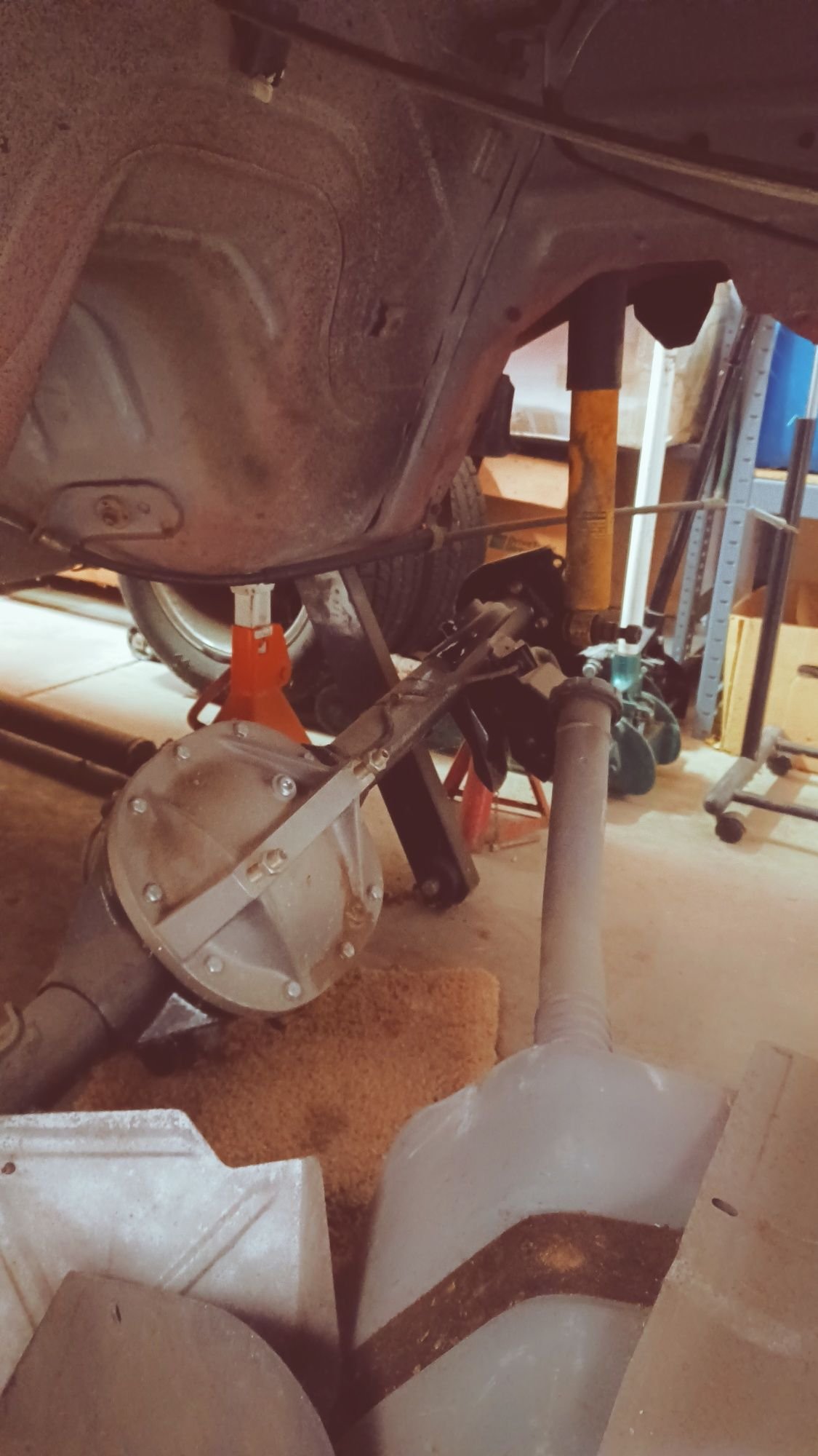

91 Z28 10-bolt, stock shocks, rectangular LCA's
Stock and Eibach springs
