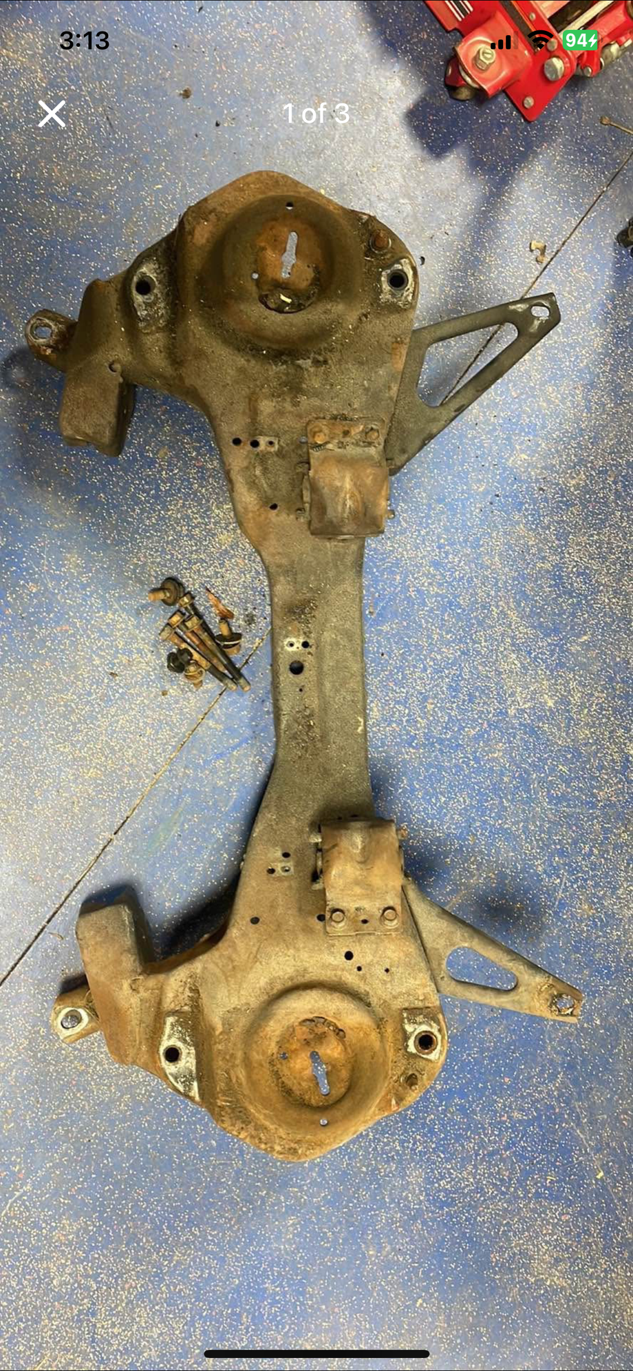

Taking advantage of the triangles and springs disassembled, I will drop the motor cradle. To support the engine, I thought to support it from above but I don't know where to ink the chain? Can a strut under the oil pan be sufficient?
Old Apr 19, 2025 | 09:01 AM
Posts: 28,015
Likes: 2,492
Re: Engine cradle
Bolt holes in the ends of the heads are a great place, using bolts of the right length such that they can tighten all the way up. A carb pad bracket is even easier. Something kinda like https://www.summitracing.com/parts/sum-g1015-1.
​​​​​​​Can a strut under the oil pan be sufficient?
Yes, as far as that goes; but it'll be HORRIBLY in the way.

Work is done!

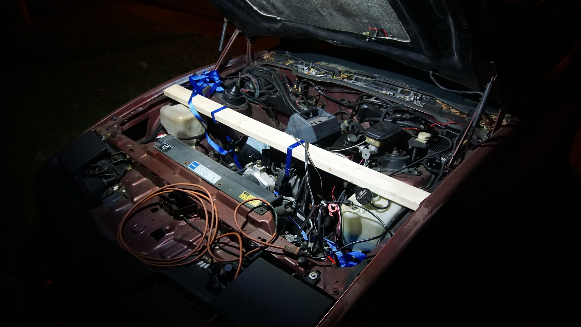

In the future, I cut a 2x4 the length of the space between the fenders, strapped a couple of ratchet straps to the front of the cylinder heads, and I was able to lift the engine off the eventually to install a new K and suspension. It was surprisingly not in the way, and a single strap could have held it, but I liked the security of 2 straps in case one let go

Well I don't know, the image shows up correctly in the edit and in the preview but doesn't in the thread, I can't find any problems in the link and you can highlight, right-click and choose go to and it opens...

Woah TX50, you gotta lota faith in that red stand holding the engine! What happens to the springs as you pull the engine cradle down? Or did you already have those out?
Looks like you were missing the "]" on the end of the link. Here you go...
I just had to drop the front sub frame on my wife's P.O.S. POL-sha Cayenne and I did a similar thing to ^that^, but used the rafters in my garage with a spreader bar to spread the load over several beams. I used a sling around the harmonic damper. Worked good.

Re: Engine cradle

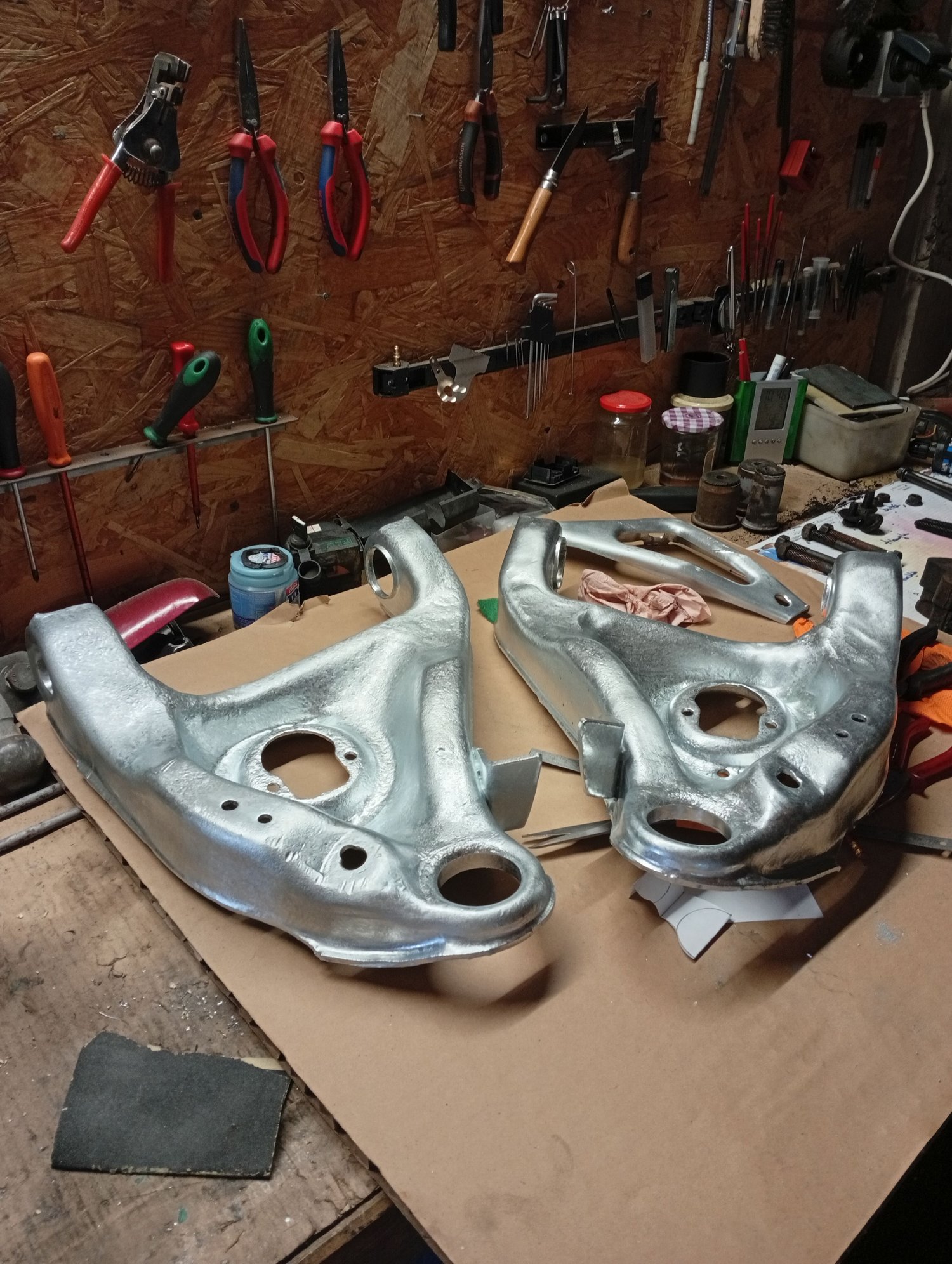

I did remove them before dropping down the engine cradle with an inside spring compressor, Bought 30$, but very efficient!!! I've been kindly surprised of this tool. Next step is to powder coating all parts and put them back to place. Pictures following asap

First step completed! Powder coating this week...

What did you use to clean the K member?

Re: Engine cradle
special treatment by dipping before hot galvanizing
