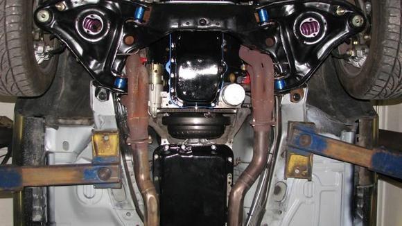

Re: Any Front Control Arms / A-Arms that don't cost a fortune?
Originally Posted by Smykster
this was my next choice, but the Delrin bushings are having me shy away from them. I drive my 3rd gen quite a bit, to work grocery store, whatever. I enjoy cruising around in it and I don’t want an overly harsh ride.
I've got Delrin bushings in my stock control arms. Nothing harsh about the ride. No weirdness transferred through the steering.
