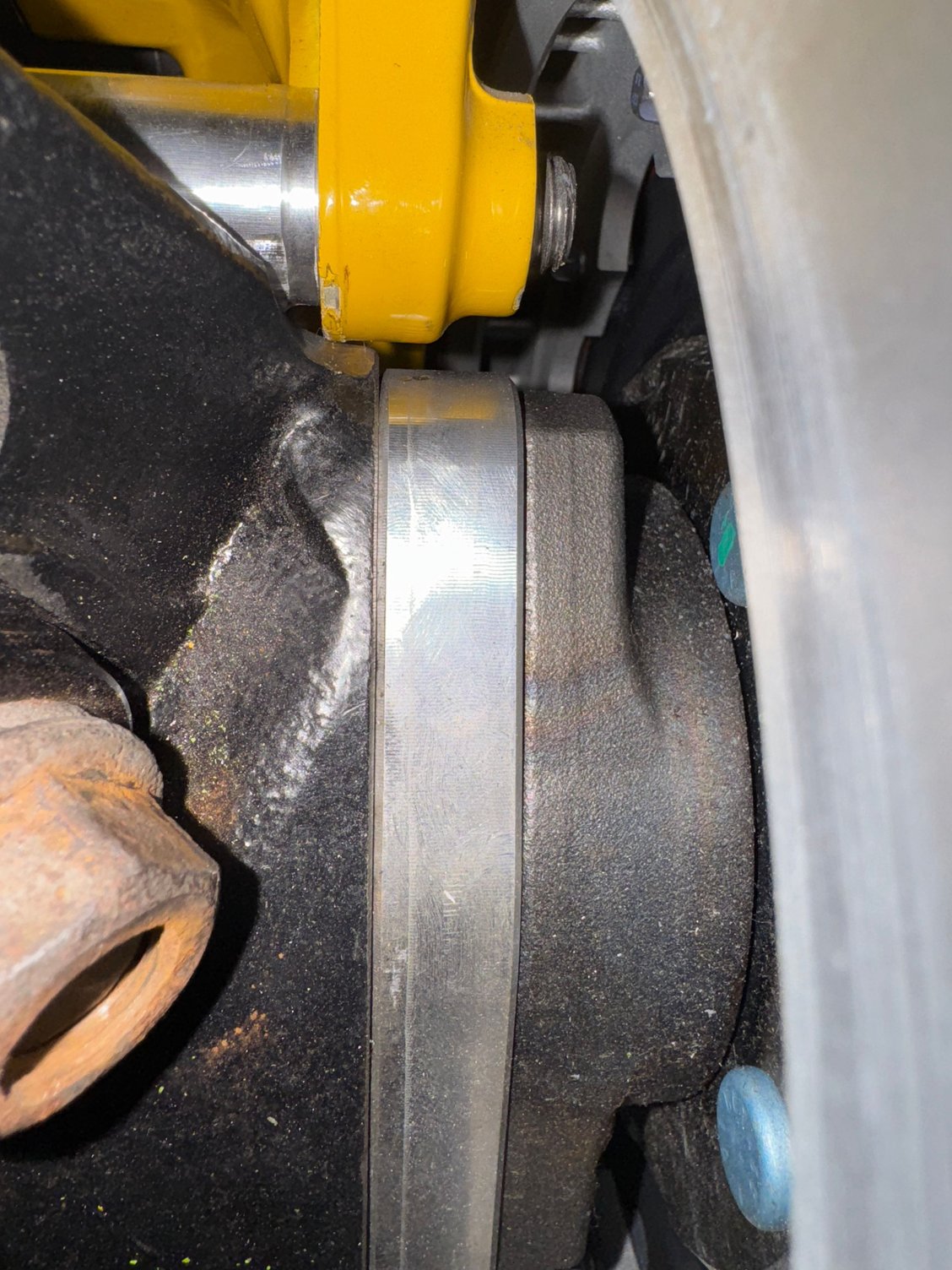

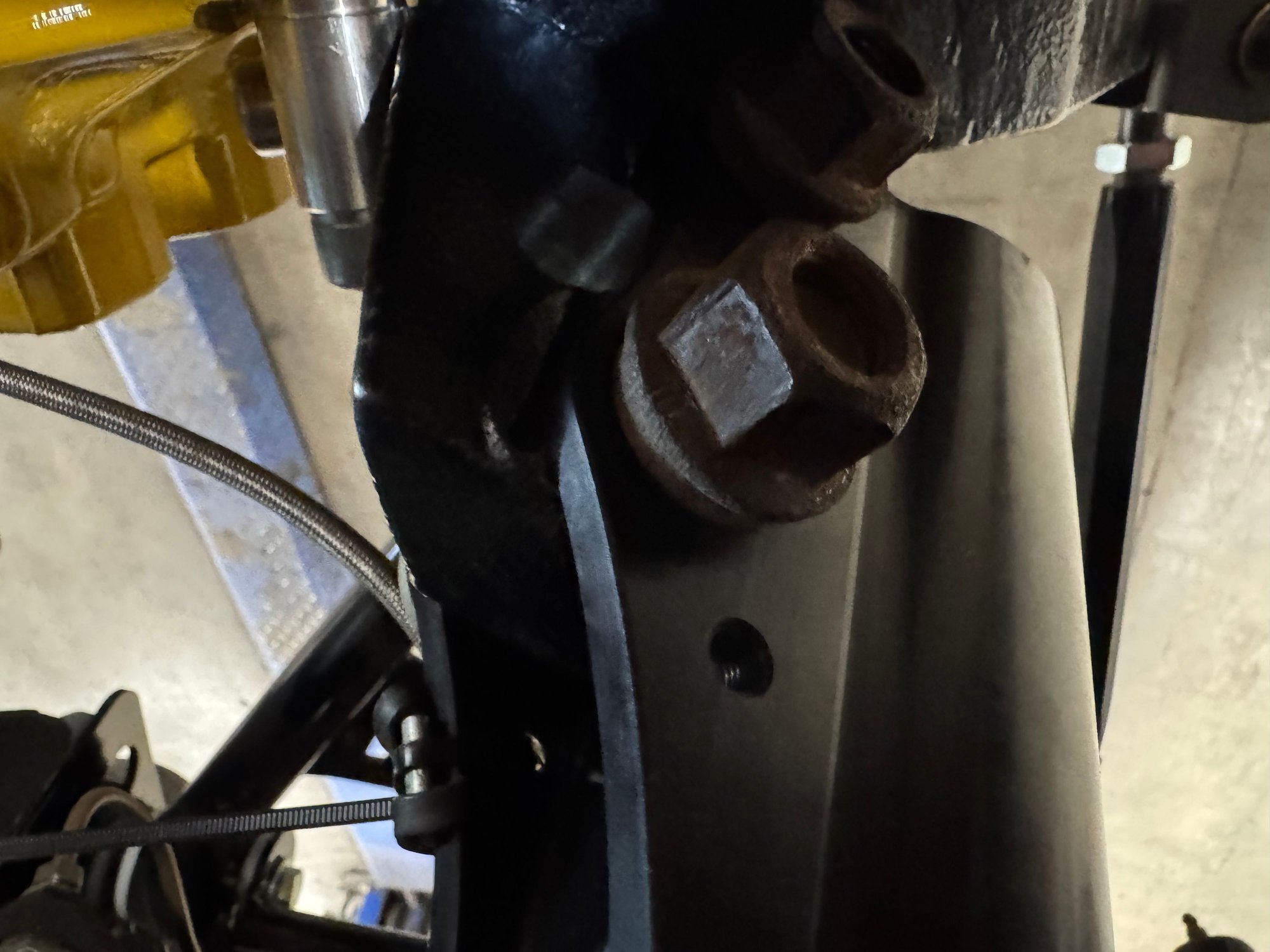

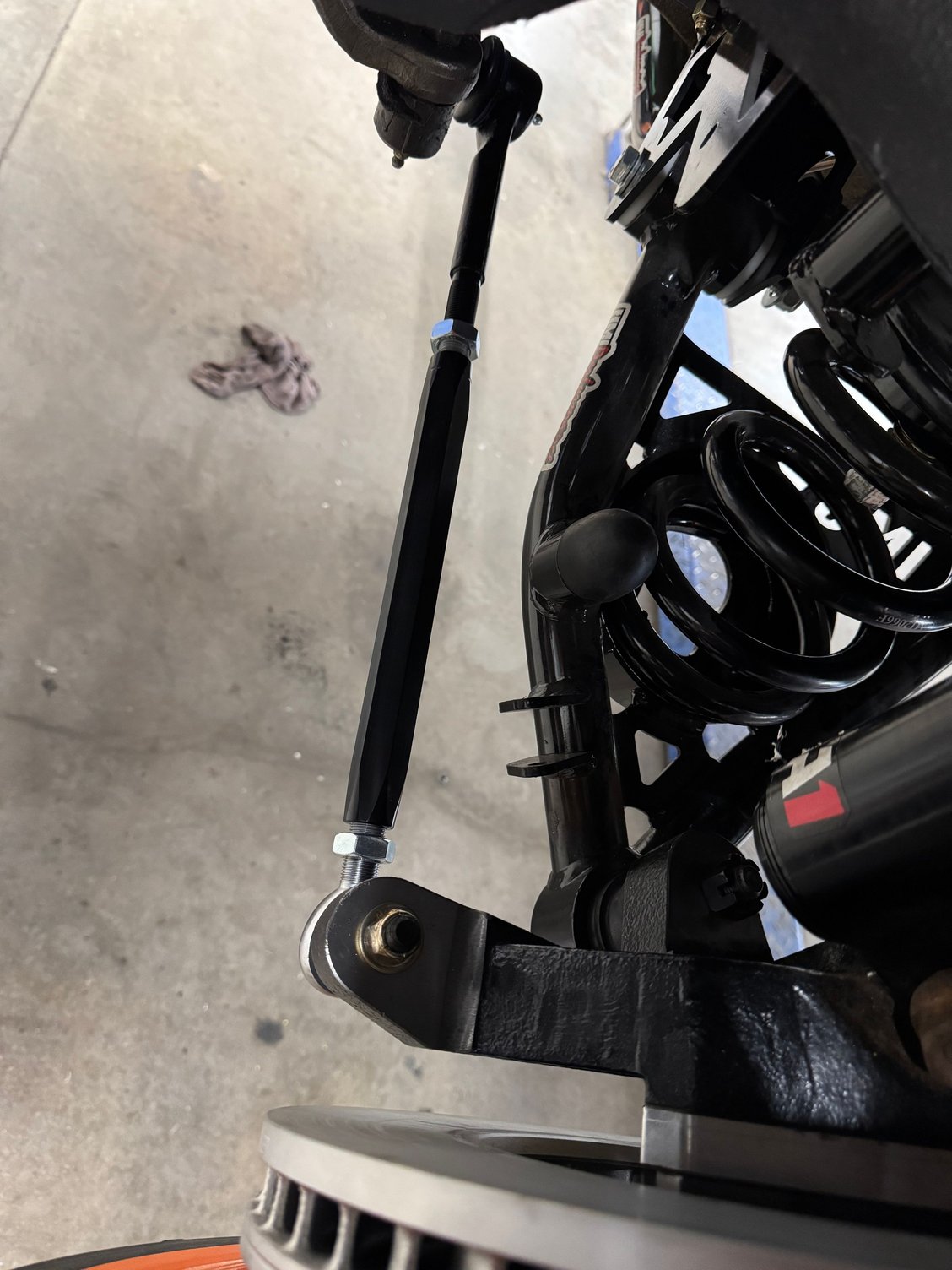

Originally Posted by Chuck!
Mine are on. Couple things -
1. I am using the CTSv2 brakes. I had the center of the rotor hat (two piece) opened up to fit over the C7 hub and it worked despite the slight difference in bolt pattern
2. The stock outer tie had minimal thread engagement so I changed that out for the UMI bumpsteer kit and that worked
3. The QA1 proformas needed ~1/16" material removed at the strut mount area on both sides. Seth said thats basically the only strut they didnt test with, my luck ha
4. Had to remove just a little bit of material around the caliper mounting bracket to clear the CTSv2 caliper
Everything else worked out well. Now I can finally get my wheels made.
Any pics of all these small details, and/or your final install?
I plan on using QA1 struts, so any insight on those would be particularly helpful.

Re: Hawks new spindles
Once you put the strut on you can’t see where the mounting area is shaved but I do have a pic of the caliper clearance and the bump steer. And the c7 hub under some sweet guni wheels ha.
- What is that big orange wheel?
- Are the QA1 shocks adjustable in their mounts similar to the DSE units? Basically can the strut body be threaded in or out of the strut mounting bracket or is it all one piece?
- I will use the bumpsteer kit as you did. Seems like a great solution.
- I won't be using those calipers, but nice to see any issues will be a bit of a dremel job here or there.
Thanks for taking the time to post the images. Can't wait to be at that stage on my build.

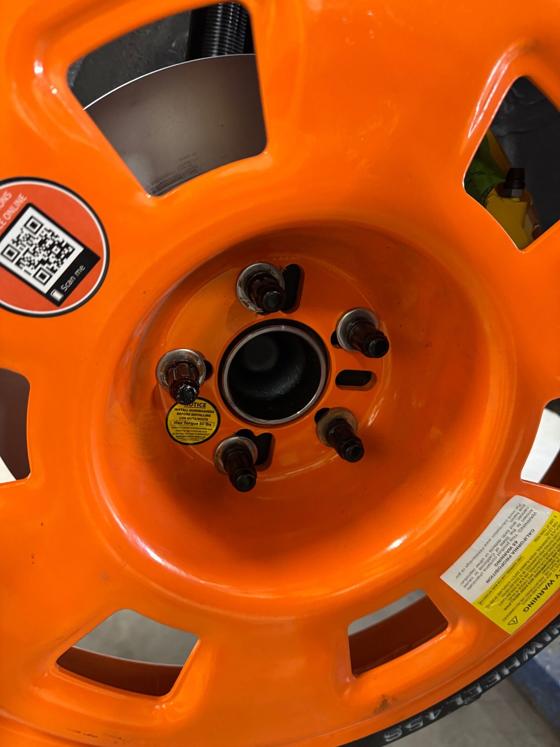

Guni wheels
High end roller wheels common for shops
https://guniproducts.com/product/guniwheel-guniwheel
Damn, thats a skinny wheel. Must be solid rubber tire.
They are solid tires. Again, they're explicitly for rolling around a shop. They have a giant offset to clear even the biggest brakes and a universal bolt pattern to fit a bunch of cars

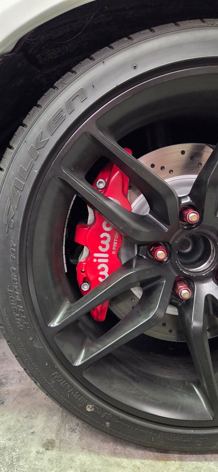

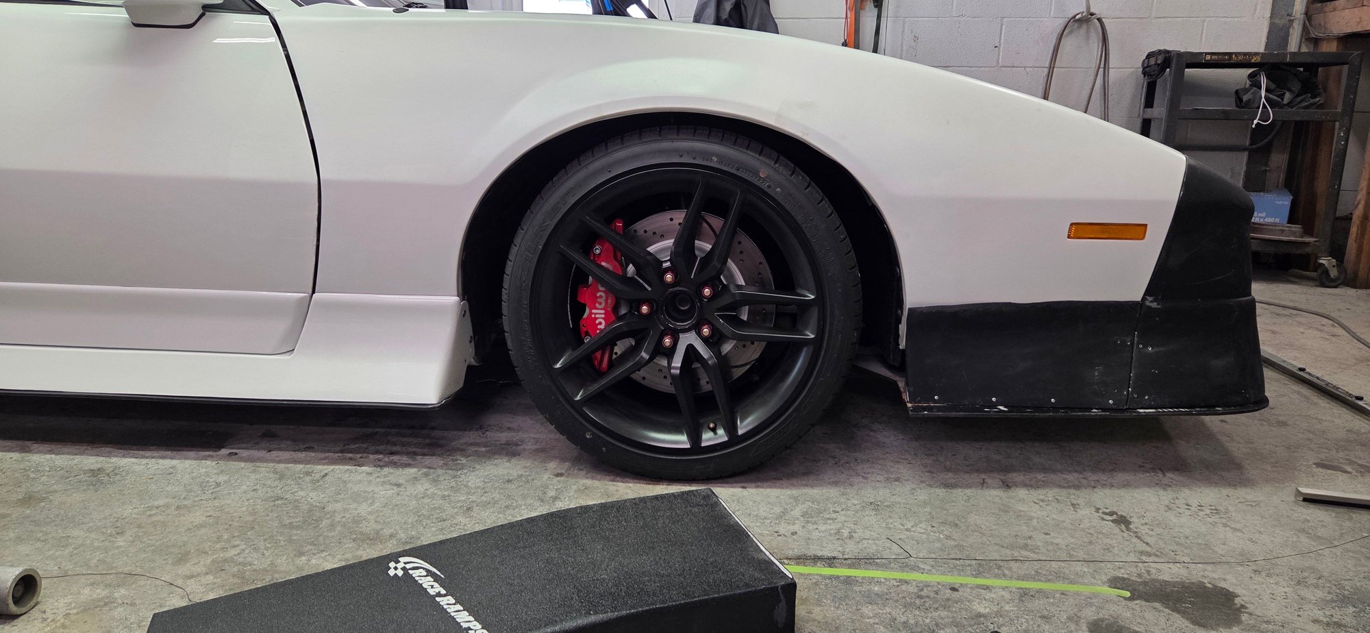

Fyi this Wilwood brake kit for C5 and C6 Corvettes will fit the spindles no mods necessary. These are 18x10.5 OE Replica Wheels.
I did need a longer tie rod adjuster.
Also the strut does mount higher on the spindle than the stock spindle reducing the travel. If you use Viking struts you can loosen the bolts and nuts on the strut mount and screw the strut body down to recover the lost travel.

That's amazing! I just posted yesterday in the brake forum that I wonder if this would work!
I can't state how many hours of time I have spent looking all over the internet for the brakes for my resto mod '91 Z28.
Think this just might fit the bill.
I want a "turn key" solution for front and rear from a single source. Wilwood does have a very proven track record so that is a huge plus.
They also offer various options for rear calipers. Need to sort out what would work on my Moser 12 bolt (that I want to run an E-brake on).
Anyways, thanks so much for sharing that this is possible!

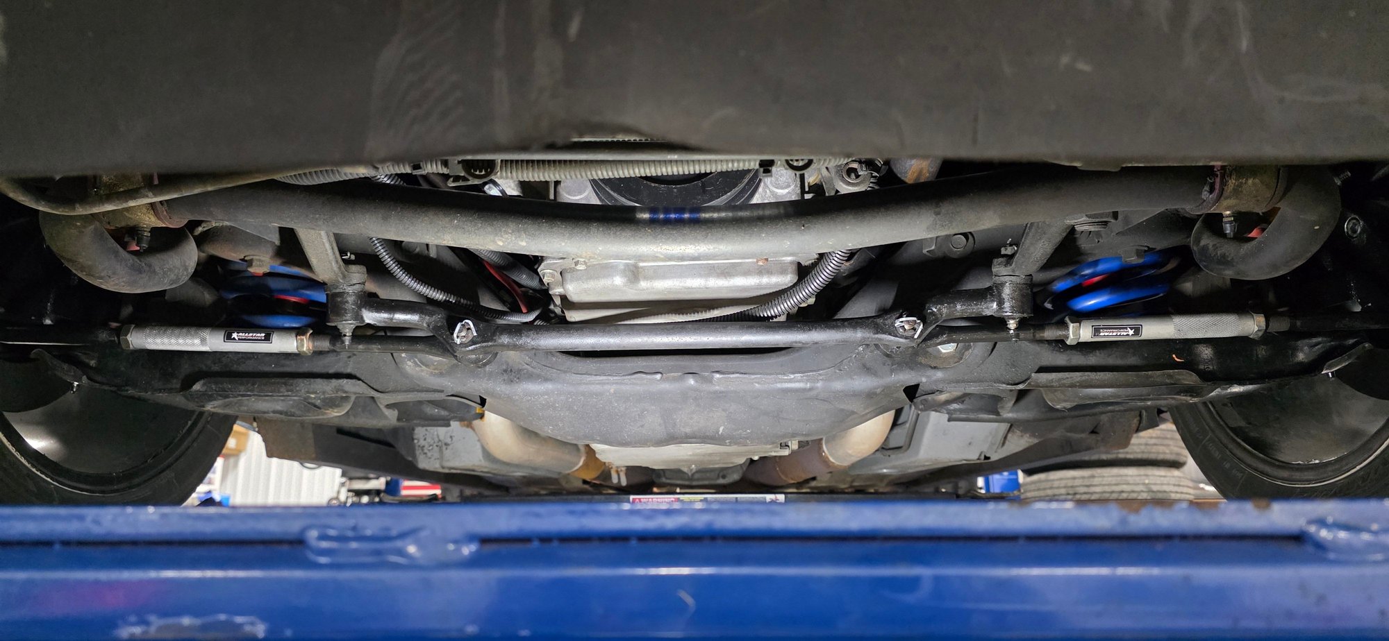

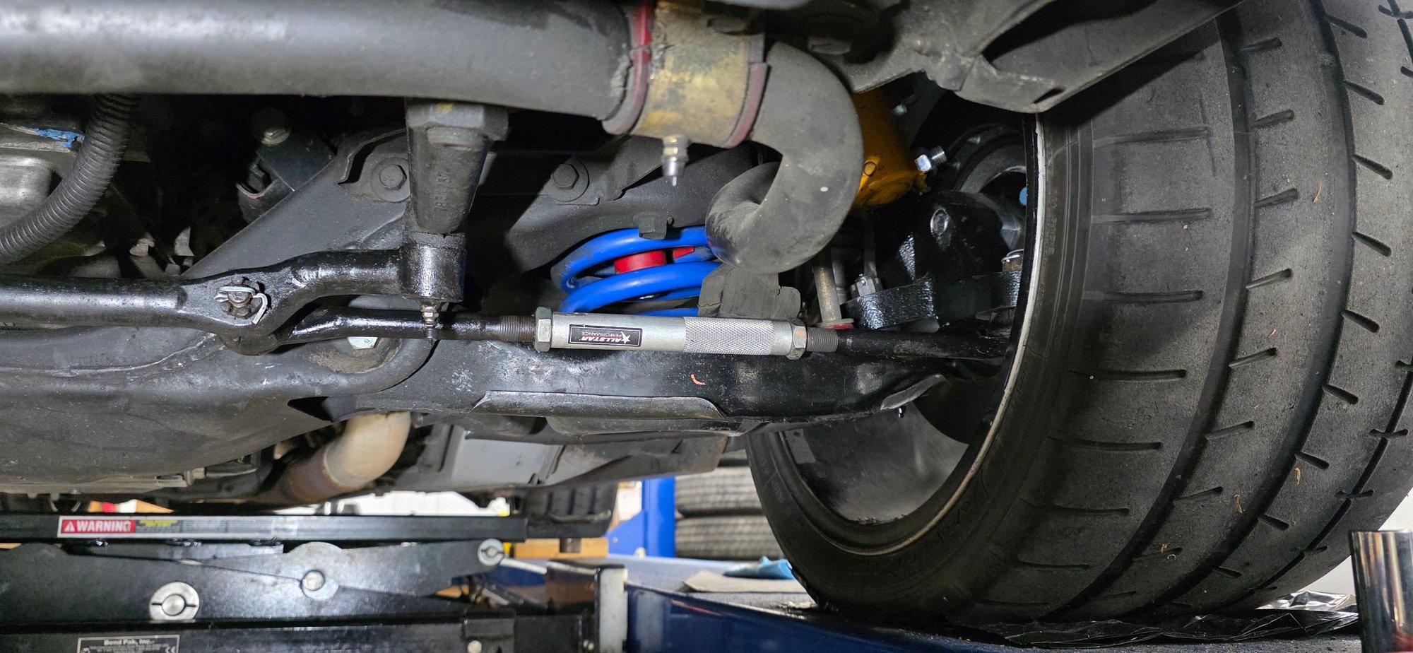

I installed my spindles this weekend and it was straight forward enough. Just a few notes:
-Koni struts are a tight fit, it took some prying on both the flange and holes to draw the 2 together. Im sure others will be the same.
-The car sits LOW now, my jack was stuck under the car. Fortunately I have an old set of Ground Control weight jacks.
-As mentioned, the tie rod adjusters are too short now. I bought 6" aluminum threaded tubes from Summit.
The threaded tubes should arrive tomorrow, I have an alignment scheduled for Wednesday, and hopefully an autocross on Saturday!

Originally Posted by slowTA
... bringing this back on topic.
Great comparison pics. Really shows the difference. Please port more pics once you get the new tie rod adjusters and get the car on the ground. Interested in the final layout, especially when the wheels are lock to lock. Wondering if anything hits or gets close.
Can you share what PN you bought for the tie rod sleeves?
I went with the all-star 6" threaded tubes, 5/8-18. But I would recommend the coleman instead, the difference is thicker wall with hex on both ends (opposed to flats on one end and a knurl on the other).
https://www.colemanracing.com/Chassi...hread-Aluminum

I'm at my alignment shop now and with factory spindles I was at -2.8 camber. Yes, I know thats a ton, but autocross life. With the new Hawks spindles I'm maxed at -1.3 and -1.6 degrees. I modifies my upper strut mounts and the top of the strut is REALLY close to the opening in the strut tower... and master cylinder.
Any one else run into this?

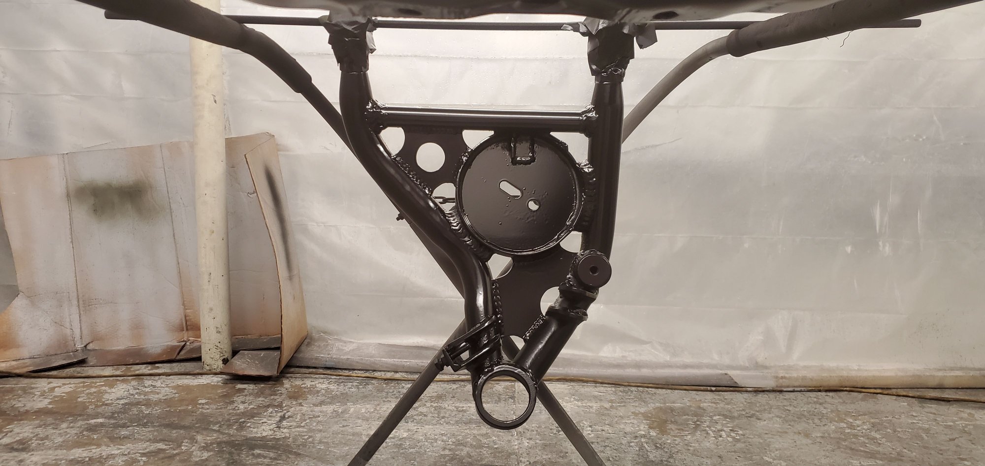

Which contol arms have rod ends? I'll have to weigh my options.
Mine are a modified set of BMR control arms. I cut the poly ends off and welded fittings on for rod ends.
I have never seen that center spring perch. Is that stock on the BMR units? When I check their website they look different.
I ask because my build is about to get to front suspension and I am going to be running RideTech Air Ride, but would love to not have to run stock A-arms.
That being said, the stock ones are what they built the kit for (naturally) so I may keep it stock with upgraded bushings etc.
But since I want to run 15" front brakes from Wilwood I need the Hawks spindle and if it needs more adjustability to get alignment right, then I may need to look into other options.
Guessing street alignments are fine with it, right?
Old Sep 19, 2025 | 12:15 PM
  #136
Dreambird's Avatar
Joined: Feb 2006
Posts: 188
Likes: 9
From: Myrtle Beach SC
Car: 1992 Pontiac Trans Am Convertible
Engine: 6.0l LQ4
Axle/Gears: 3.73 True Trac
Its modified. The spring perch is the standard diameter different manufacturer. The curved part if the arm is curved more to allow tire clearance. The sway bar mount is my own design due to the arm 2" wider it needed to move. As is the steering stop I'm the back which is adjustable. Also I made all the internal bracing for strength.
