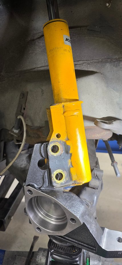

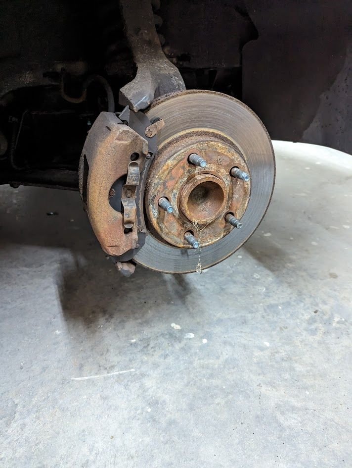

Originally Posted by 84 1LE
Funny, its on the home page, but when i click on order now the page only shows "1LE" style set-ups. Anyone else getting this or is it just me?
Nope

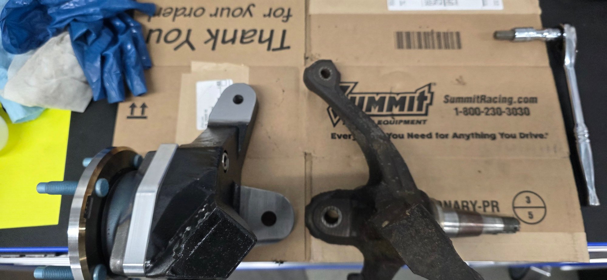

Re: Hawks new spindles

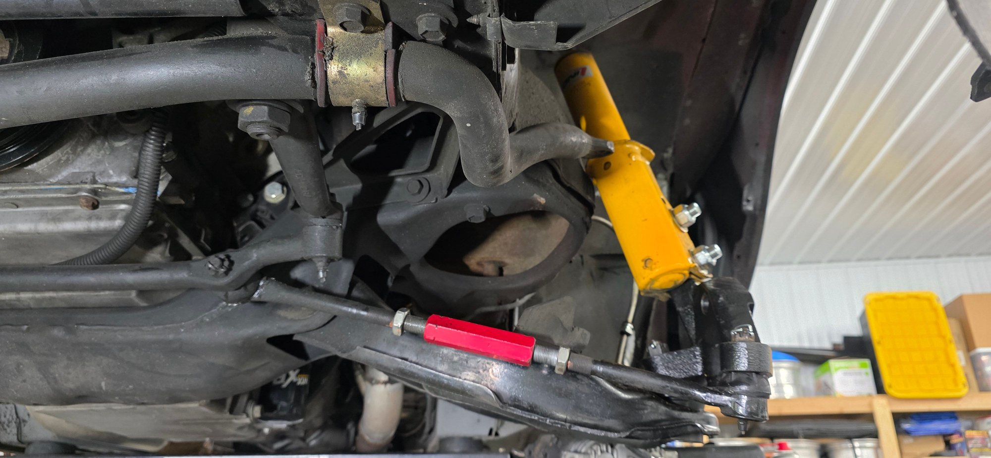

Originally Posted by slowTA
... bringing this back on topic.
I installed my spindles this weekend and it was straight forward enough. Just a few notes:
-Koni struts are a tight fit, it took some prying on both the flange and holes to draw the 2 together. Im sure others will be the same.
-The car sits LOW now, my jack was stuck under the car. Fortunately I have an old set of Ground Control weight jacks.
-As mentioned, the tie rod adjusters are too short now. I bought 6" aluminum threaded tubes from Summit.
The threaded tubes should arrive tomorrow, I have an alignment scheduled for Wednesday, and hopefully an autocross on Saturday!
Thanks for your feedback! I'm discussing the changes with the shop helping us produce these. We are told according to the CAD models there should be no changes to geometry aside from the shorter steering arms.
This seems to not be the case and I'm looking into that. I did notice the ride height difference on my car when I installed the spindles and when I mentioned this I was told there were no changes that would effect this.
I'm glad to know I'm not losing my mind lol.
I am also running Koni's and did not need to open them up any for install. They were snug but it was nothing a tap with a mallet couldn't get lined up.
I have the ProForged Tie Rods and Adjuster on my car.

slowTA's Avatar
Posts: 659
From: Clifton, NJ
Car: '88 Formula
Transmission: T-5... in need of slight rebuild

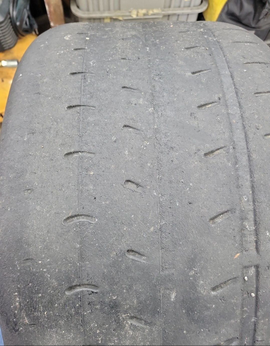

Yeah, the lack of camber is a bummer.
I noticed the passenger side was a tighter fit than the driver side.
Look at my pics higher up and you can see the axle center lines and strut mounts are both much higher. At full droop the strut now hits the spring pocket where there used to be a small gap. That could be due to the extra droop or the strut mount being in a different spot.
The car didn't handle bad even with the lack of camber, but it would be so much better with all the camber.

Are you guys using the Proforged outer tie rods and adjusters that are listed for our cars on their website?
Or are you using something else. I remember reading that longer units of each were needed.

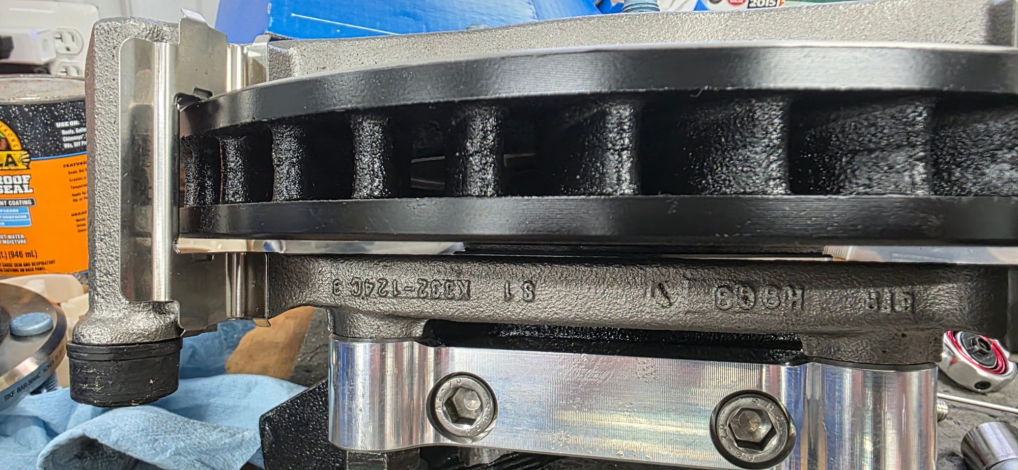

Old Oct 10, 2025 | 09:42 AM
  #166
slowTA's Avatar
Posts: 659
From: Clifton, NJ
Car: '88 Formula

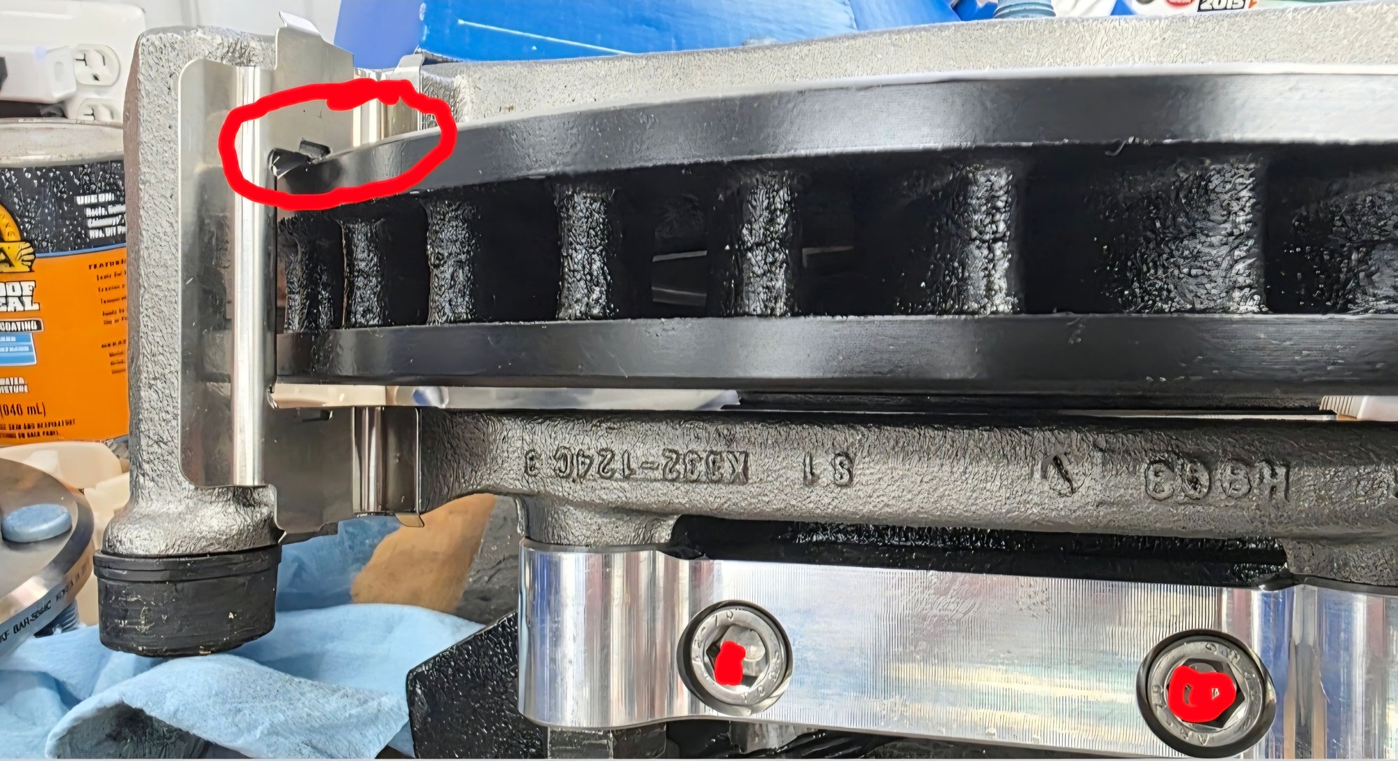

I'll post thes pics again as they're a page back now.
I'm not sure how much the spindles lowered my car as my jack was stuck under the car and I started dialing up the weight jacks before measuring.
Also, to close the loop on my issue with the rotor touching the caliper bracket... there's just enough 'slop' in the bolt holes on the C5/C6 adapter that if you run the bolts down the caliper bracket can go on crooked. So to install correctly keep the adapter bolts loose, pull the adapter outboard as you snug up the bolts. It's just that little extra room needed to center the caliper bracket.
When I assembled them on my workbench gravity pulled them the wrong way.
Old Oct 10, 2025 | 10:09 AM
  #167
Firechicken82's Avatar
Joined: Aug 2021
Posts: 1,276
Likes: 361
Car: 82 TA
Transmission: Magnum f
Axle/Gears: Ford 9 w 4.11
in the second picture, the centerline of the axle looks further back in relation to the ball joint centerline on the hawks vs stock. I'm assuming that's the position it's in the pic? It looks like it lowers the car a solid inch.
not trying to nitpick. Just info gathering. These seem like an awesome idea.
Old Oct 10, 2025 | 10:32 AM
  #168
slowTA's Avatar
Posts: 659
From: Clifton, NJ
Car: '88 Formula
It doesn't look like the axle centerline was moved back compared to the ball joint. Maybe its the angle of the pic.
I don't understand your explanation about the slop and rotor hitting. Could you add more detail? I am not sure what you mean about gravity pulled them down the wrong way. I think I am especially stuck on understanding what is "crooked".
Your early adopter insights will be invaluable for people purchasing in the future (Like me).

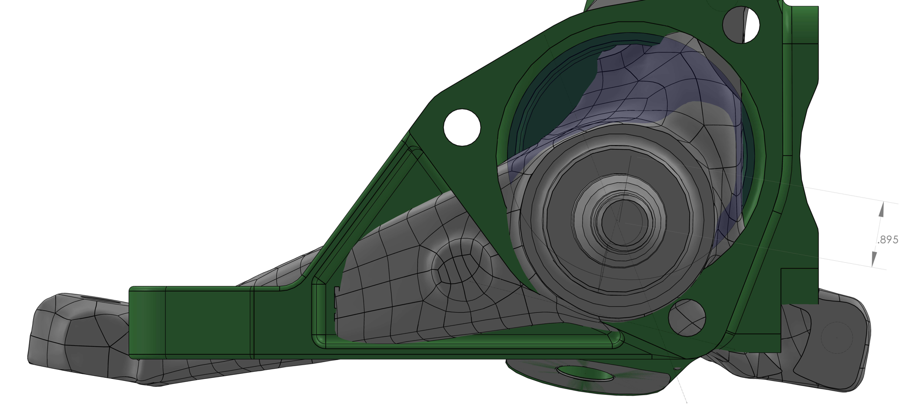

Finally getting some answers back from the manufacturer on the ride height. We compared the CAD model of these new spindles to the CAD model of the previous 1LE spindle we offer and it does lower the axle centerline about .895".
I'm not sure how this was missed, maybe in the communication of possibly doing a standard AND a drop spindle version of this part but what we ended up with this round is the "1 inch drop" version..
That was NOT supposed to be the case. We were expecting to receive a stock ride height spindle originally.
I did test fit these on my personal car (the black RS shown above) and noticed the car seemed to sit lower but when going over this with the manufacturer we were assured the dimensions were all the same in regards to this issue.
As soon as I have more information on if a "stock height" is still planned I'll update you all.
As far as the camber difference. I am still waiting on an answer for this and will continue to update you guys with what I find.
I say all this to be as transparent as possible. I will be working on getting the online descriptions updated to reflect this as best as I can.
For those interested in the comparison here is a screenshot of the two different parts and the axle centerlines of each.

Fantastic update. Thanks for the transparency.
Think a lot of people will welcome the slight drop.
(mechanical engineer here)
Looks like the CAD models are mated via concentric mate and a planar mate to the ball joint. Nice.
Do you (or anyone else) have any concerns about the tie rod attachment being at a different angle? I know it is shorter.

And what about the higher mounting point on the strut? Whats up with that?

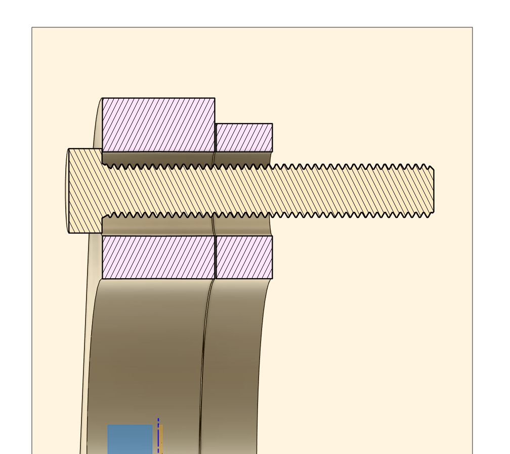

The bolts with the red dots hold the adapter to the spindle. The holes are oversized a hair, no more than you would expect in a typical bolt and hole assembly. Unfortunately, there's just enough room to let the caliper carrier touch the rotor where circled.
I said gravity pulled it down because in this pic the apindle is laying on its back with the studs facing up. This pulled the adapter down. The fix is to lift the adapter as you tighten the bolts or if you're doing it on the car, pull the adapter outward.
Crooked... the adapter can get bolted on skewed, in this pic one side up and the other down.

you could also put a thin shim (washer) between the caliper and the adapter at the bolt mounting location between them to space it further out and center it... that is typically how willwood kits are actually set up to make sure in the end the caliper is centered on the rotor
This was a great explanation to what you were describing before. Thank you for the clarification.

Having ghosted this thread for the past couple of months. Was super excited to learn of the actual product that was coming out. Almost couldn't believe they were bringing out a part that solved so many of the original spindles problems. Had my finger on the buy button a number of times, but never committed. Now my car is not a street car, nor is it a high dollar specific race car only. AutoX, Rally Cross, low buck endurance racing, fun cheap stuff. Invested a lot of time in optimizing the existing platform with some aftermarket upgrades that we can fit into the the racing we do. The spindles ( and bearings ) have always been a weak link.
3rd Gen front suspension IMO
Roll centers already below ground, Lowering the car with stock geometry makes it worse Lowered spindle BIG plus
Bearing wear. We bring to the race and change the front bearings every weekend, C7 bearing set Dream Come True
Shorter tie rod arm. Clears my rims better with bump steer kit Will make my Turn One 10/1 steering box even faster
Loss of Camber. Unacceptable These cars have zero camber gain to begin with. Having spent numerous hours getting as much camber as possible out of this suspension. ( increased the slots and strut hole in the towers, notched the strut mount on the master cylinder side , and few other things ) I refuse to give up as much Camber that has been referenced in this thread. A quick read of any of the race suspension threads on this forum will give you how important this setting is.
I applaud the transparency of Hawks to admit to the spindle height difference. I am begging them to fully disclose the actual geometry of this new spindle. I still want to purchase this part and know of at least 3 or 4 other who do. Its got to be on a cad drawing somewhere. Modifying a suspension is always full of compromises . You take what parts you can get, make, buy and make the best educated choices. I just can't make myself go from 6.5 degrees of camber to the suggested in thread of 1.5 degrees

Um -6.5 camber?
I hope that's a typo ha ha.
Realistically around - 3.5 is the ideal number based on my testing.
Pic is a old A052 at -3.5, damn near perfect wear.
1/32in tread across the whole tire.
Same goes for the Hoosier A7s and re71rs I've run.
Interesting, I feel my eyeball calipers have been validated
Personally, I'd prefer the current drop spindle design over a stock height version. Stock height may not even be feasible if the hub flange drops below the BJ pad plane. Such is life when updating old designs

to be honest, those spindles have some major flaws.
for street cars you'd likely never notice, but.
1. they limit camber by a lot, about 1/2 the factory spindle making camber beyond -1.5 unlikely. race 3rd gens usually run -3.0 to -3.5
2. they have a 1in ish drop (that's fine), BUT it also pushes the wheel center towards the front of the car. the drop is fine, but try to stuff 315s with a more foreword wheel center is an issue.
3. the changed steering arm is likely to cause havoc on bump steer. but also speed up fast boxes to something unreliably fast. 10:1 or 8:1 boxes would likely not be drivable with 1/3 turn to full lock.
4. the mounting of the hub is the biggest issue. because the bearing hub isnt supported inside the spindle, it's likely to snap those 3 bolts off of any large load were put on it. like some 1.3-1.4G turns at a fast rack
the hubs are spaced out from the spindle with a 6061 spacer. but that spacer isn't indexed. so that hub is gonna move around and eventually go to SNAP city.
5. no provisions to run the ABS wires so us ABS users would have to drill holes somewhere to feed wires through.
6. the spindle itself is SUPER heavy, not really a bad thing from a strength aspect, but unsprung weight is bad.
that spindle is a cool idea. But it seems like the engineering behind it is rather flawed.
I sent some pics to a Formula1 engineer and he agreed with the issues I mentioned above.
for a street car, you'll likely never have issues on anything I mentioned.
but for us Autocross and road race guys, it's a hard no.

A couple question:
2. Doesn't it look like the wheel would get pushed backwards, not forwards?
4. This is my largest concern. If no spacer is used does the bearing sit inside the hub and load transfer thru more than just the bolts? Or by design is there a gap?
Old Nov 3, 2025 | 11:00 AM
  #189
Pocket's Avatar
iTrader: (24)
Joined: Jun 2005
Posts: 8,122
Likes: 362
From: NC
Car: 91 Trans Am
I can chime in on a few
1) I wonder if offset strut to spindle bolts would help there. OTOH, the more the angle is corrected, the less tire can be stuffed under before hitting the strut
2) The wheel would move rearward slightly
Assuming the hub CL moves along the 5* caster common to 3rd gens, it's .078". Barely anything
3) F/R movement on the steering arm affects steering ratio and ackermann/anti angles. The shorter arm will make a slow turning factory box act like a faster ratio and hit the turning stop on the control arms before the boxes internal stops hit. A quick ratio box will become pretty twitchy at speed being even more quick ratio'd. This is a benefit for rack conversions because the spindle doesn't need as much as much linear travel at the arm. I haven't found a R&P to match the stock 3rd gen's 7.1" of steering travel
Someone like Dean will need to explain how that movement will affect ackermann and what conditions/purposes it suits
Up/Dn movement affects bump steer. The up/dn position seems to be basically the same as stock, but should be checked regardless since the frt is lowered from the hub placement. Standard bump steer tie rod kits should still work
4) That would require a FEA report supported by real world destructive testing. Being aftermarket parts, it's highly unlikely to happen at the price point for these spindles
I wonder if Seth would instead do a stress analysis on whatever CAD program he's using and share the force numbers/FOS. Should only take a few minutes on the computer vs the above
5) Target market. There's only a handful of owners that would ever need that. If a few minutes with a drill will do the job, I'd say close enough and move on

The FB post was me.
#2 is the opposite as the new spindle moves the wheel center Aft not foreward.
But the point is the seems like really lazy engineering. The fact that Hawks didn't know that the wheel center was moved to such an extent.
I kind of tells me that they either outsourced the design of the spindle to someone else, or was using an incomplete spindle design. Then just sent it to full production.
But I'd say the Hub mount mechanism is by far the largest issue.
I made a quick 3d model to explain the issues here.
The specs are exaggerated to make it more clear.
But without having the bolts indexed you're putting a massive amount of strain on them with that spacer setup.
That means that Hub can move in up and down on its own. Putting massive stress on just 3 bolts.
will a street car on factory tires ever have a problem? Most likely not.
Maybe if you do the casual autocross on big tires yeah you could probably get away with it.
You pull 1.6 g's in a banked turn at the track, then all of a sudden you have a wheel flying off.
just my 2 cents.
A formula 1 engineer that I know 3D scanned the original spindle and plans on making his own Billet spindle.
I'm excited to see what he comes up with.

I never had any issues with sticky weights on OE gta wheels. Even with my old 1LE set up. How much bigger are the 4th gen brakes?
With the hawks 17" gta wheels and c6 brakes, not so much. The calipers knock off the stick on weights. Due to caliper/wheel clearance. So the weights are installed closer to the outer rim edge (dynamic Vs static balance).
If you search going back 20 years on here lots of people say the GTA wheels don't work with LS1 brakes without spacers. There are also two versions of GTA wheels, forged and cast. So that may matter as well.
I'd be interested in these hawks spindles to convert to rack but I have no desire or need for larger brakes, and I'd like to keep the GTA wheels.
