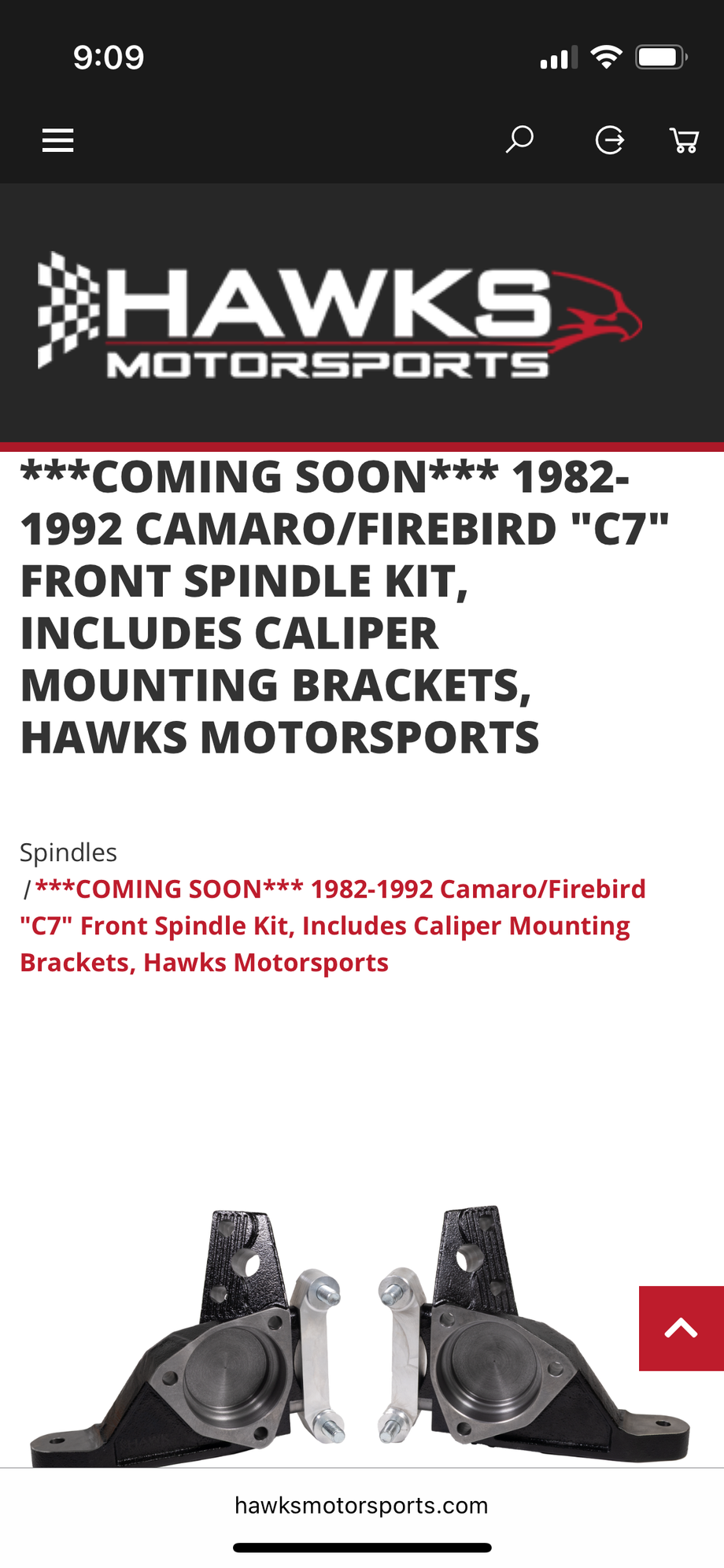

Looks like hawks is coming out with a new spindle for the 3rd gen’s!!

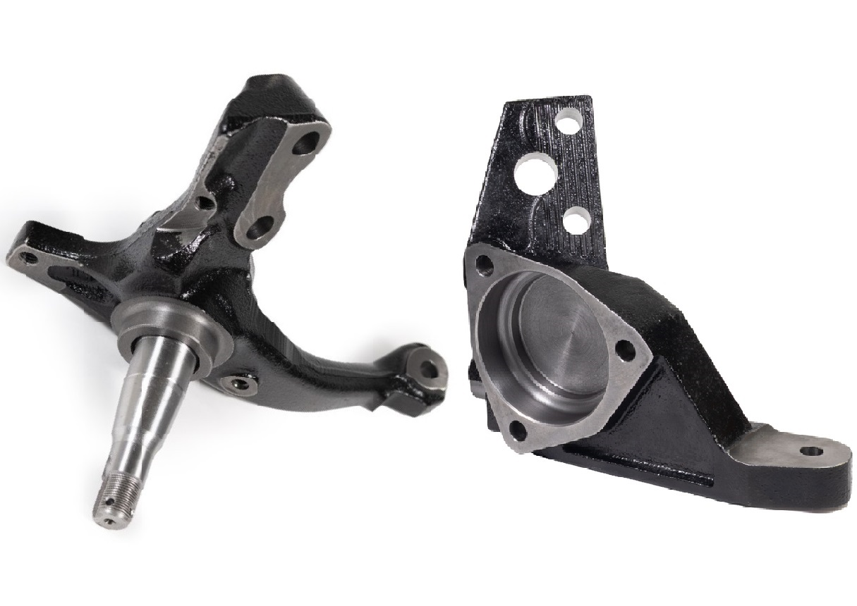

They're designed for 3rdgen geometry, wheel offsets and strut attachment. Caliper brackets are modular, bolt-on, changeable and available for all common brake upgrades, which means people's existing upgrades, whatever type they are, should swap over to these.
All the details and a lot of pictures are in the listing. Some of the pictures require the written details to help understand what you're seeing. And some of the details require pictures to help make sense of what you're reading. But it's all there, including that the hubs are NOT included, so figure an additional $300-$500 for a pair of hubs.
1982–1992 Camaro & Firebird C7 Front Spindle Kit | Big Brake Upgrade | Hawks Restoration Parts

Looking at the website listing, there are different brackets for different brake upgrades, and it lists all of them, including LS1, C5 and C6 Std and HD brakes, so based on that, all signs point to yes.
When ordering, I'd guess there will be a dropdown menu from which to choose the brackets for the type of brake upgrade you already have or want to install.
That should also mean if you want to change to different brakes in the future, then you probably go back to the site, or phone, to order just brackets.

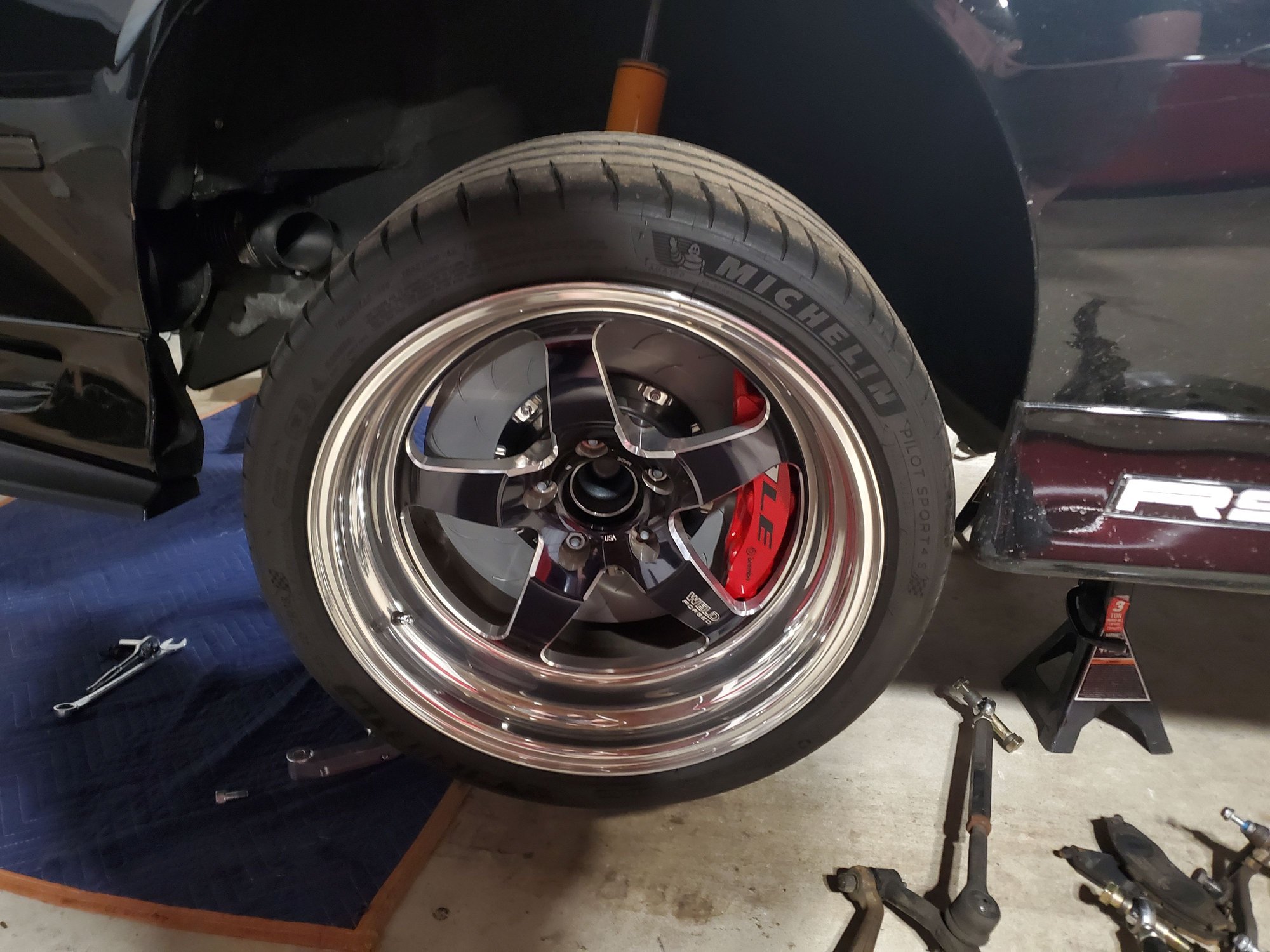

ive emailed 'bruce' at hawks and asked him about my wheels and what will fit
he said the spindles are about 30 days out and "13 inch bear kit will fit"...
im going to reply to find out with corvette stuff will fit, as i dont want baer parts on my car.
picture is my 91 gta with 17 hawks wheels

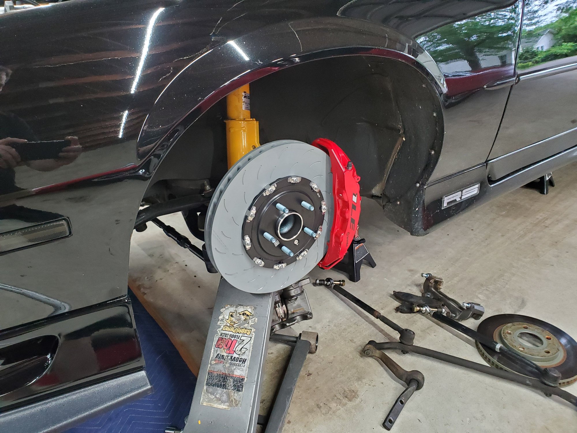

Is that steering arm shorter or just trick photography?

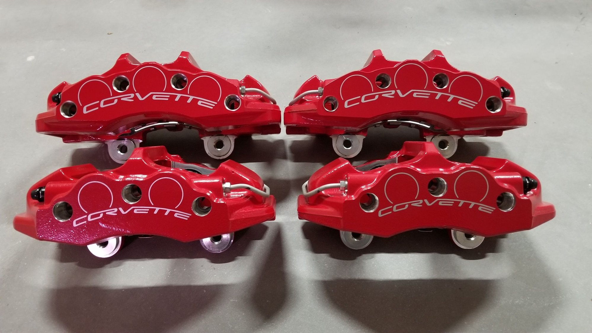

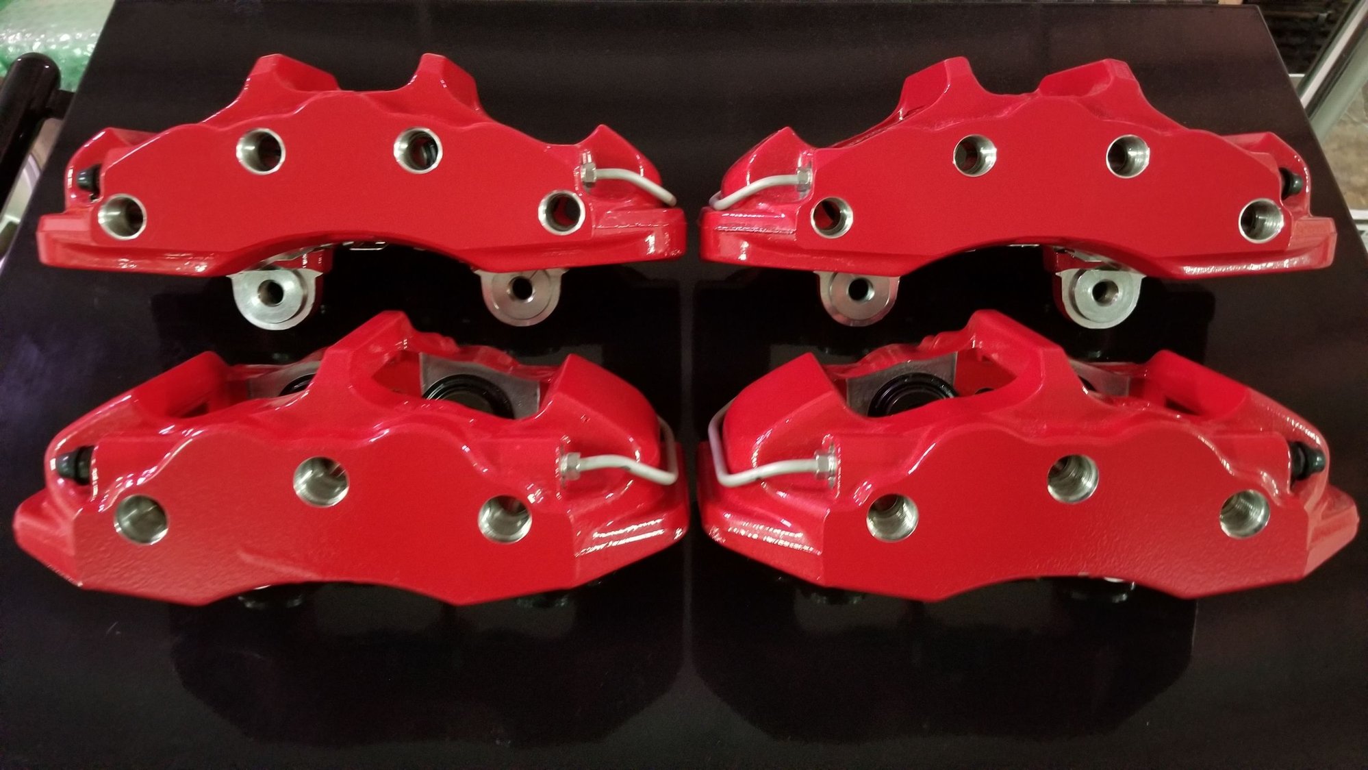

GM calipers: 3rdgen 1LE (front and rear), LT1, LS1, C4, C5, C6 HD (same as Cadillac XLR/XLR-V, GTO 05/06), and C6 Z06 are all PBR, made in Australia. C6 ZR1 is where GM made the switch to Brembo, and I believe C7 and C8 are Brembo too, which is Italian. And a search shows Baer still made in the USA.
