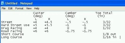

I definitely got the factory specs. Oh well. I guess I could always do it again. Looks like the specs Reid posted for the street take road crown into account.

Yeah there's good info in that thread. I remember it, it gets quoted alot.
My usual recommendation for "specs" is sorta somewhere between the "street" and "hard street" settings in that chart, and broadly in agreement with it, as you probably saw. Some cars though won't even go that far before they run out of adjustment range. There's more to it than just handling though; for example, increasing the positive caster, which DRASTICALLY improves the "center" feeling that's so NUMB with the factory settings, moves the wheels rearward in the wheel wells visibly, and also makes them rub the wells just in front of the bottom of the doors. Toe & camber setting interact to affect tire wear significantly: setting up more negative camber without adding some toe-IN, will wear the inner edges like eating them for lunch, just like the factory's STUUUPIDITY eats the outer edges. Some tires make all of that worse than others, butt it's inevitably something that often happens, and people bitch about, regardless. And yes, road crown is DEFINITELY a factor; the way they build roads in some places, like Houston for example, need ALOT more caster and camber split with the right higher on both, because of that. There's really no such thing as "perfect" "one size fits all" alignment, butt carefully matching the settings to the external conditions and the user's preferences, can make a car much more pleasant to drive.
Post up your "before" and "after" settings, including rear measurements (obviously there's no "adjusting" that, only measuring it), and we can help you see what needs to be done. Besides just ignoring the factory's IDIOTIC "specs" and setting it up to something that makes actual common sense instead.
