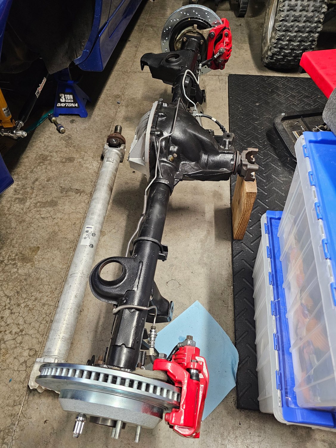

@LLCooLM495 Thanks for coming back to this. I actually just finished the swap after multiple hits and misses with brake lines. If my passenger side brake line hadn't completely welded itself into the axle tee, I would have just modified the factory lines. The lines I first posted were returned, and I got the stainless lines from Inline Tube for factory drums, and figured I would go ahead and modify them. Was able to bend the longer passenger side to make it line up with the 4th gen hoses on the calipers. But shortening and re-flaring the driver side proved difficult. I wrecked a Harbor Freight flare tool (returned) and couldn't bring myself to buy the high dollar flare tool for one brake line. I ordered the lines that @LAFireboyd posted above, but those still didn't fit without re-bending, especially the driver side, since they're made for rear mounted calipers. So I ended up with a stainless passenger side and an OE-steel driver from the disc brake kit from FireBoyd, since I knew it was be easier to deal with than stainless. Knowing what I know now, I should have just got some Ni-cop and did them all myself. But I have a spare for each side if I ever need it. I believe I ordered the 1460mm e-brake cables so fingers crossed, that's not an issue. Hoping to get the upgraded rear end slid back in this weekend!

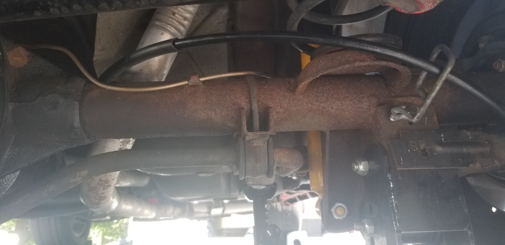

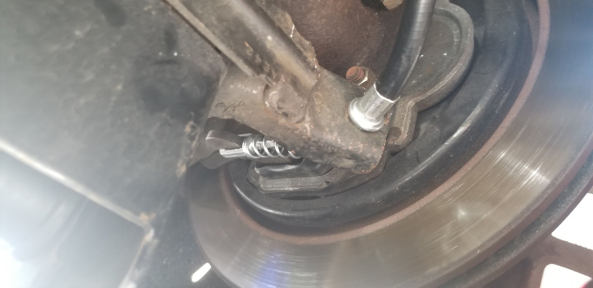

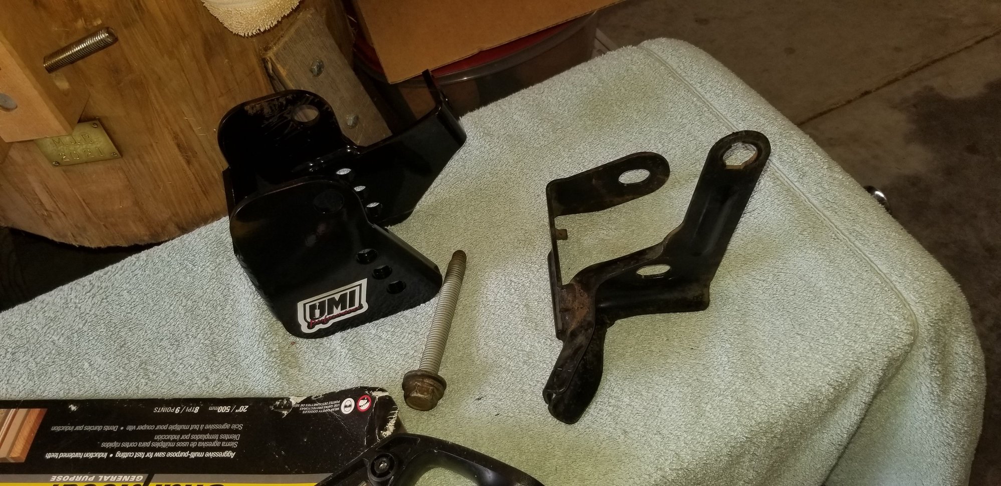

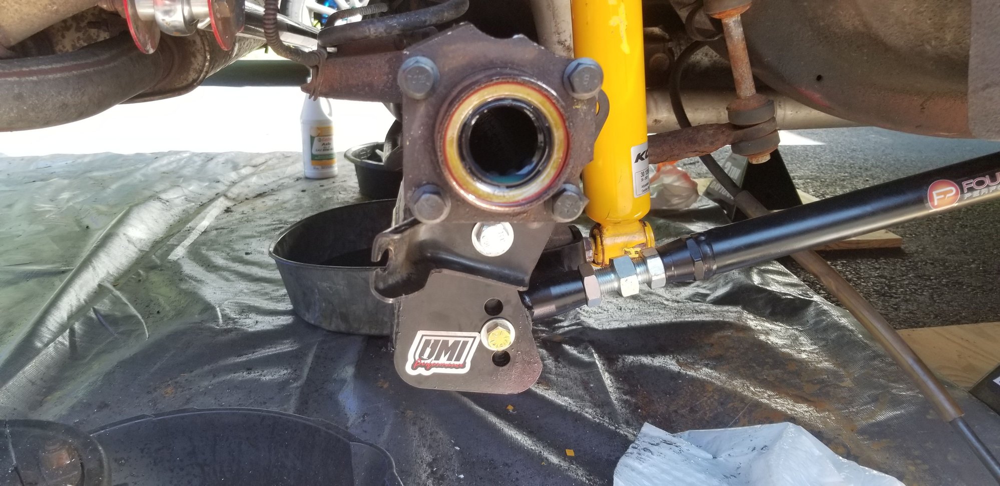

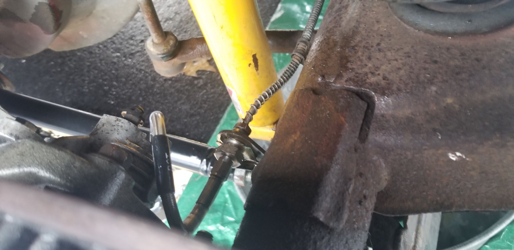

Right on! Sorry you had to go through a couple different lines, but glad you got a setup workin! I was able to double check after I got home from work, turns out I actually used the AC Delco 18P1104 cables, the 1444mm ones... 1460 would def still work, might just need to route it differently. Looks like you arent usin the 4thgen hose/ cable brackets, so you woulda needed slightly different routing anyways. I've found some images from the install, here's some that show those 4thgen brackets I mentioned. Gotta drill a hole in the LCA shell to make room for a lil tab on those hose/ cable brackets, but they made the mounting go just like factory. Not completely necessary, but figured I'd show how they fit up on a thirdgen axle now that the images are gone from that original swap guide. Hope the final install goes well for you!
Heres what the pass side bracket looks like off the car. Theyll mount up the same with or without the LCA relocation brackets
Here's what the pass side bracket looks like off the car. Slight edit, as you'll see in the 4th pic, I did have to cut the far side of the bracket off to fit the LCARBs. The locator tab keeps it in place, haven't had an issue after a year of daily driving.
Drivers side with the 4thgen bracket
Driver's side with the 4thgen bracket
Pass side, the e-brake clips into that tab right under the axle flange
Pass side, with one of the e-brake cable eyelets from a 4thgen
Cable installed in the 4thgen bracket
