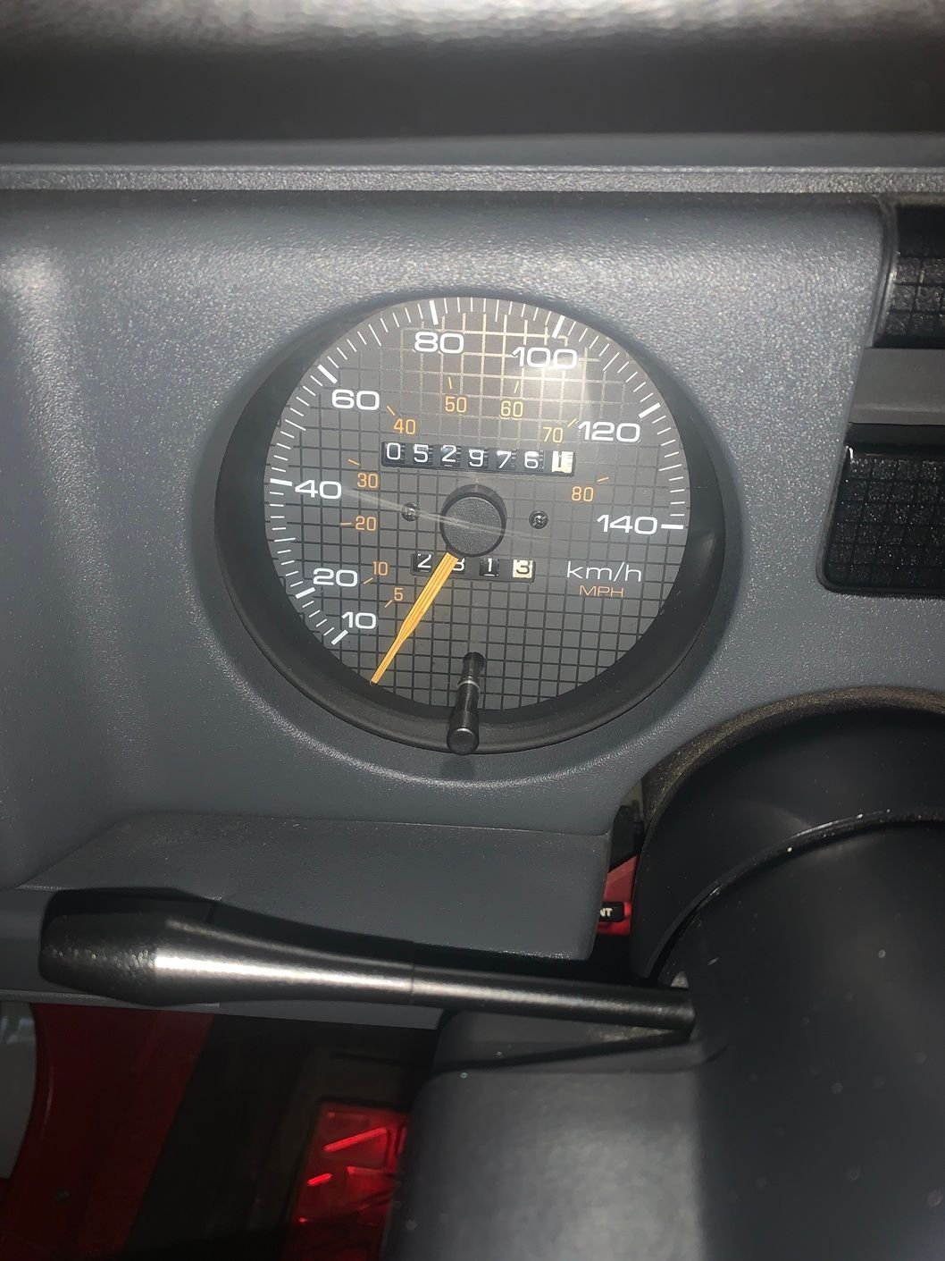

The most obvious place to look is the odometer as my car at least came with an odometer that read up to 999,999.9 kms. I'm not sure if the milage odometers are the same.

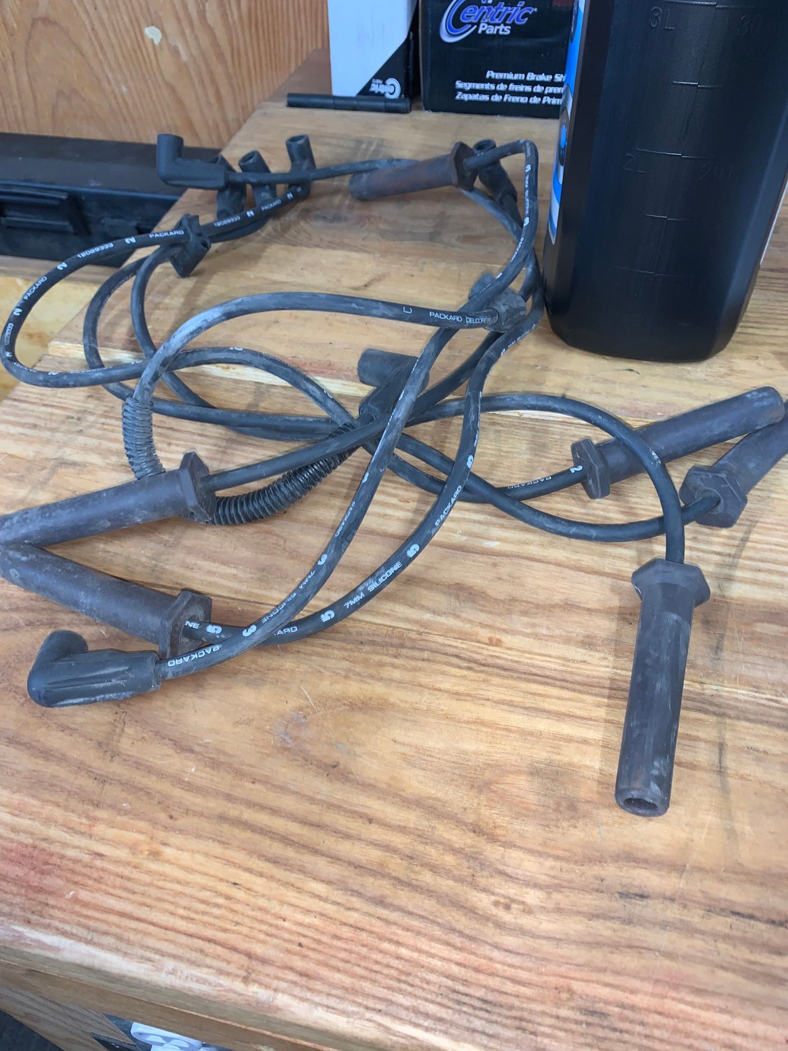

Spark plug wires are another good indicator as the original wires won't likely last 160,000 miles.
These are original in 1986 2.8L V6 Packard 7mm wires.
Old Oct 26, 2025 | 02:00 PM
1986_IROC-Z's Avatar
Joined: Jun 2016
Posts: 85
Re: Yellow Delco Shocks - HELP
The second place I would look would be the gas and brake pedal wear. This is what 56,000 Kms or about 35,000 miles looks like on an original GM brake pedal. Notice very little wear on the left side of the gas pedal or on the right bottom corner of the brake pedal.
Thank you.
Sadly, GM put 5-digit odometers in the 1983-1989 cars. Someone can correct me if I'm wrong, but 1982 Camaros for the US did have a 6-digit odometer, and then they switched to 5 digits the following year for US models. The US Camaros didn't regain a 6-digit odometer again until 1990 when they updated the cluster and added an airbag for the driver. Just like the IROC didn't get a 145mph speedo until mid-1986. This '85 I'm looking at still has its factory-correct 85mph speedo.
