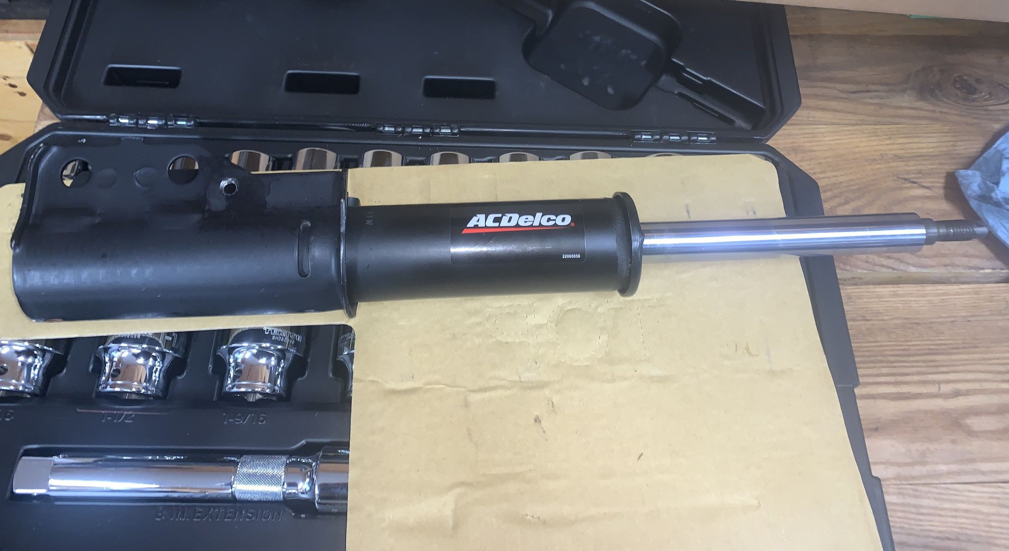

Monroe Struts
Just installed Monroe struts. My WS6 struts bit the dust. The front end is definitely sitting higher. Hopefully it'll settle down in 500 miles...
