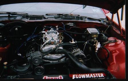

I think this is the one. I used a 65" belt for this.

what about your AC.. and can u just buy say a 65" belt at like auto zone

Well, I have lately removed those two things. But, for Cali you should probably keep them around.
That is what I did at Auto zone. I just said I need a 6 groove serp. belt that is 65" long. The first thing they wanna do is find out what car it's for. That is funny. I usually give them the answers they want. I said a 90 RS camaro with a 350. They said that car didn't come with that motor. I said I know.
I think that is funny that they lean on that computer so much. You have to explain it to them usually but they will have it.

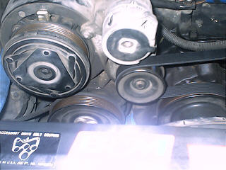

You can also run it like this. I have mine ran like this.

Ok lets try this again.

Yeah, that is a different water pump I think than mine. I don't know what years they are different but some waterpumps flowed opposite of the norm. I don't know if mine is opposite or yours is but, that must be the case here. Good point though. What year is your car?
what size serpentine

All 3rdgen serpentine setups use a reverse flow water pump. If you change the belt routing such that the water pump no longer turns the opposite direction of the crank, you will need a standard rotation pump.

My car is a 88 which I believe was either the first or second year for the serpentine setup. The belt is a DAYCO from advance part # 5060820 so its a 82'' belt.
both of yalls setups turn the water pump CCW. the crankshaft turns CW, stop and think about it for a second. only thing is tbi305camaro setup looks like it would have more of the belt "on" on the pulley...

Yeah, you are right. I was totally confused after that. I had to draw mine on paper before I could get this straight. Brain Fart! Would the grooves be different? Looks like his water pump pulley has the smooth side of the belt on it. True?

yes true.. same as how it is with the full size serp
