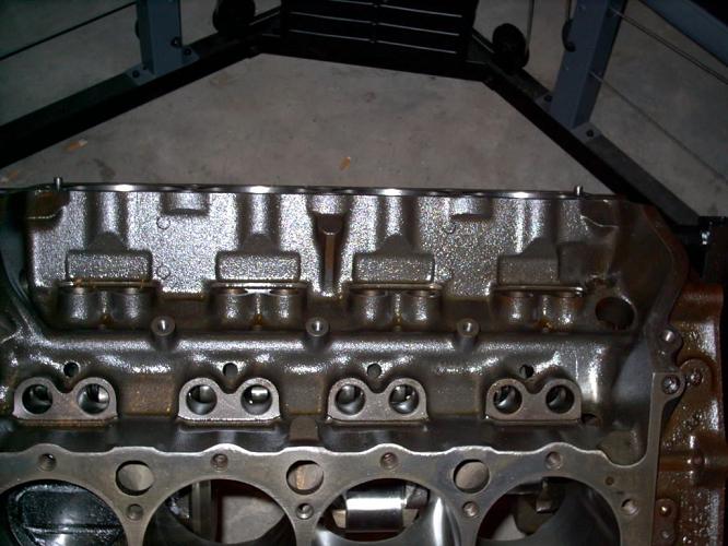

Originally posted by iroc22
Not really, you will need to take the intake off to see if there's roller lifters.
If you pull the rockers covers and shine a flashlight through the oil return holes between the pushrods, you'll be able to see if the retainers and big "spider" thingy is there.
Even if it isn't you should be able to see the center of the lifter valley and see if the block has the provisions for the retainer, plus you'll see the "notches" that give clearance for the retainers on the sides of the lifter valley.
Here's a pic of the hole you'll be able to look through.
Attached Thumbnails TBI LO3 engine q's-tbi-heads-pushrod-slot
