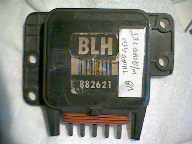

Originally posted by chevypower
RBob,
What does BLH stand for? Also what years are the in(I thinking all computered carbs)? I have the 8746 ECM. What did the 7747 ECM come in? Your talking about the ECM's forceing knock(this is the first I've ever heard of this) for diagnstic, why do they need to do this? Will the 454SS module work or not? Does the BLH module work like the LT4 module does in my '97 Z28? I'd really like you to tell me more about ALL this.
See attahed pic. Then links:
https://www.thirdgen.org/techbb2/sho...k+AND+force%2A
Attached Thumbnails ESC Module that could lower knock count, are they out there?-blh.jpg

I have the ANRZ module now. If I use a BLH module can I use the knock sensor thats in the car now?
Old Dec 13, 2003 | 06:35 PM
RBob's Avatar
Posts: 18,432
Likes: 234
From: Chasing Electrons
Car: check
Engine: check
Transmission: check
Yes, just change out the ESC module. A junkyard shouldn't charge more then a few dollars for one.
