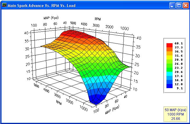

I want to say that unless he's got his fuel/spark tuning he's not spinning but bogging down real bad. I know that with my stock tune I cant get my tires loose at even 2200 which is where my stall is. Power wont come on until about 3000 rpm and stays strong to about 5500. Thus yeilding 2.4 60's and thats with tubular lca's, relocation brackets, phr and a posi. Again, we're both looking at big gains in our ET's if we can get our 60's down to about 1.9 which is where I think I should be on street tires.
edit: rereading this post just do what Pablo said. Id start with giving it spark under 2500 rpm though.

If you have pretty tall gears your timing and fuel below 3000 will really effect your 60'

I know what you mean. The times are pretty disappointing to me. I'll just keep doing the tuning and try to dial it in.
I would still like to do 3.42 gears, intake, drag radials, and a torque converter. I'm hoping eventyally all of that will get me to low 14's.

Thats a shame man beautiful car. im not very tech savy with the whole windall and all of that but ill tell you what man that motor is starveing for fuel it seems youve got heads cam ect on a stock intake and tb thats a weak point and also a posi and say 3.73's will rocket your car into lower e.ts. Also go to a mechanic buddy of yours and get him to check out you tach and if he has the tools to get your speedo and tach calbrated well thats if you have a buddys whos a mechanic and also you should get into all that chip burning on your own a guy halfway across the country cant tune your car properly man its a hands on deal and also i see you have a 305 tpi car what made you descide to want to hook up a LO3?
Old Jun 22, 2004 | 01:32 PM
azvolfan's Avatar
Joined: Feb 2002
Posts: 2,308
From: Avondale, AZ
Car: currently thirdgenless!!!
I had already started doing stuff to the LO3 by the time I got the 305 tpi. So I just kept going.
As far as the chip tuning. I'm dabbling but progress is slow. Very confusing.

This may help shed some more light on any performance issues your having...
heres the spark table and PE spark adder table

As far as teh spark table goes (subtract 20 from all values to get actual advance), it looks like you have around 42 degrees at cruise and a total of 32 degrees at WOT. While this isnt bad for some motors, it may be too much for your 305. The CC are smaller and it probably could stand to have less timing at WOT. Also, if you have more then 0&#176 of initial spark advance, youll have that added in as well. For example, if you have 6&#176 of initial SA, the youll have 26 (from table) + 6 (initial SA) + (8 from PE SA adder) for a totoal of 40&#176 of timing.
Also, if you look in the '100 kpa' column, youll notice that the values level out at 2000 rpm. The area where it plataus is called teh total SA. 2000 rpm is too early to bring in all your spark advance, your better off having it slope up to the peak ammount of spark advance at 3200 rpm. Id start with 10 degrees in the 400 rpm, 100 kpa column, and 25 degrees at the 3200 rpm, 100 kpa column and have all teh other values slope up to the peak. In addition to this, zero out the slope and PE spark adder tables.
What this will do is smoothly get all your timing in by about 3200 rpm. I have a graph to better illustrate this.

Originally posted by 25THRSS
I thought the computer had no input on AF ratio at WOT?
Im getting there Cant fit it all into one post.
Ok, if you look at the 100 kpa area of the table I posted, you can see how the timing smoothly ramps up to its peak at 3600 rpm. This is a vac advance distributer style curve that I made up today so I could go cruising in the mild weather (havnt used the car in almost a year). Works well, but its still funky in some spots. One thing you dont want to do is have too much timing too early. Even if it doesnt cause detonation, itll result in elevated piston temps and reduced power from pumping losses. You want the fuel mixture to be done burning by the time the piston has come several degrees past TDC. Too early, and the piston has to compress a hot, high pressure mix of spent combustion gasses. This takes some experimentation to find.

Overall, Id start off with around 30 degrees of advance in the low map cruising areas and a total of 25 degrees at 3200 rpm at high load. Gradually keep increasing the timing untill the motor feels its best/turns the best track times. Once you get to this point, you dont need to go any farther with the timing. The key is to run as little timing as possible to maximize the power output.
EDIT: also make sure you set the initial timing in your prom to match the actual base timing. Otherwise, the timing in the tables wont match your actual timing.

As for the fueling, thats sort of a mess. It looks like lots of extra fuel has been added to cover up the excessive ammount of timing. Each of those VE tables are added together to get the overall VE. There is more then 100% ve specified in some areas. In the stock ecm, 100% is the max allowed so basically the injectors are being run at 100% dutycycle to give the max fuel output. The PE afrs are the desired air fuel ratios that the ecm targets. Since the ecm cant measure the airflow directly it relies on the VE tables to construct the pulsewitdht for the injectors. I highly doubt that the actual AFRs would match those. It would probably start out around 11 or 12:1 and get leaner as the rpms increased. As for tuning the tables, youll have to do this experimentally. Basically either with the BLMs or with a WB O2.
I dont expect you to absorb all this at once but I can tell you that there is certainly room for improvement

I'm gonna have to read that about 100 time but looks like the first thing I need to do is set base timing in prom to 6* so the spark advance table is consistant with the engine.
Next I change the values in the 100kpa column to gradually go from 10 to 25. Currently they start at 35 and go to 46. Now you said I need to subtract 20 to get my actual spark advance. So if I want it to go from 10 to 25, is that actually 30 t0 45 on the table due to the 20 I must subtract?
What about the other columns? Should the 400rpm row, which will be 10 in the 100kpa column, gradually work up to 10 as the kpa increases? The same with the 3200rpm row, what should it start out as if it is working up to 25 in the 100kpa cell?

Also, I assume these values are my actual values from the bin I sent you?

Those where just alot of thoughts I wanted to throw out there. All that was the super condensed version. Theres no way to cover it all in a thread. And yes, those values where from your prom. Its not a bad start, but still it obviously needs some improvement since the car is down on power. My thoughts are too much timing and fuel.
The first thing Id do is make sure the base timing is set to zero degrees. Leave it there for now untill you actually go to work on the timing. Next you can start off with the small things like constants and stuff to get into actually burning your own proms.
The next thing to do is concentrate on the fueling. TRAXIONs article on part throttle tuning is very good. I recommend you read it and then re-read it. Its for tpi but its still just as applicable to your setup. Once you have the fueling down, then you can work on timing. After that, then its all the little tweaks that make the car run good.
Take it slow and search and read the info over on the prom board. Itll take some time to really learn how to tune so take it one step at a time.

OK. I'll work on the fuel first before I mess with the timing. The shop that burned that chip set base timing to 6*. I can try backing it off a bit.

The timing in the chip isnt set to 6, its set to 0. The computer subtracts out the initial timing so that the timing that is actually at the distributer is whats in the tables. Right now the computer thinks there is 0 degrees of initial advance. You have around 40 degrees of overall advance at WOT by the time you get to 2000 rpm.
Thats just way too much for your motor. Hell, its too much even for my smog 350 with cavernous combustion chambers. The fuel is probably done burning before TDC so your just heating up the pistons and wasting power.
Tommorow, you should back it down to 0 degrees and see how the car feels. Disregard what the ALDL says. Even if there really is no knock, its not an indicator that the timing is right by any means.

Ohh wow this is the custom "tuned" chip we have been waiting for. This pretty much confirms our guesses to what was wrong. You can see that if you add the two fuel tables together your completely maxed out at 100% by 3200 rpm. So your ecm doesn't add or subtract any more fuel after that point. My guess they saw that your car was lean and just kept adding fuel trying to fix it. When in fact they were out of room in the VE tables, and probably the injectors as well. This is where you need to start tuning, you have major fueling issues. My guess is your way rich down low, which is why your 60' times are so bad and why they added so much timing down low, and your going lean up top which is also holding you back.
As for timing, set the actual dissy advance to what is in the chip that way what you see in the chip is what you get, also you can set the "main spark advance bias" to zero that way what you see in the main table is what you get. Just zero that adder then subtract 20 deg from your main table then it will be much easier to look at. When your learning it's easier to just keep it simple.
May I suggest a new thread be started here for the chip tuning part of this project. I think it would do alot of people good to see how it's done on a step by step basis. We'll talk you through the basics of getting started and show actual tables from your chip that way people can see exactly what your changing and how it effects your car. I think it would be very helpful for the undicided TBI guy who wants to get started in chip tuning but can't take the plunge.
