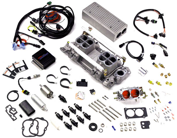

Attached Thumbnails LO3 experiment.  What do you want to see?-c-documents-settings-kenneth

I second the roots blower idea. Go with the holley tbi truck kit and make it work. If not, get a real cam, some aluminum heads like the L98's or maybe even the trick flows, through they are expensive, high CR, nice exhaust, etc. I could go on, but you get my drift.
