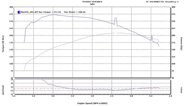

Well,
The 4th annual CascadeCrew dyno event was this weekend, the car FINALLY got on the dyno without major problems. I cut it very close, as the new computer got here on wednesday and dyno was saturday. Luckily, everything worked out.
So here are the numbers.
N/A -- 208hp / 272tq
I still need some work in a few places, there may be a few more ponies in the tune, as you can see my AFR dropped at 4600rpm for a second, then started to lean out above that, it should be an easy fix, and probably worth a few more ponies.
Nitrous -- 293hp / 400tq (another nitrous run, I actualy went 440tq because I got on the nitrous earlier)
Looks like the nitrous still needs some work. I had a few things going on here, 1) I think the jetting is too rich, the jetting I got from holley was for stock TBI, with my raised fuel pressure I probably need smaller jets. 2) It was a cold day, and I have no bottle heater, so my bottle pressure was probably a bit low.

A/F was getting a little scary there on the Nitrous runs, my butthole would have puckered up a little... mean torque none-the-less.

Yeah, not sure what the deal with the AFR is on the nitrous runs, But I also need more pump shot looking at the NA runs
