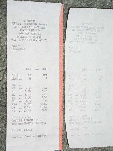

I don't seem to have that timeslip online. I do have a 13.7 @ 104 timeslip uploaded though. I'll dig through all my timeslips and try to find that one, and post a pictures.
http://www.cascadecrew.org/John/timeslip.jpg
I have a bad run doing a 14.5 or something at the 1:00 here.
http://www.cascadecrew.org/video/PIR.wmv
I think I run a 13 something at about the 3:50 mark in this one. The videos are REALLY low quality, you might be able to hear the announcer to hear the times.
http://www.cascadecrew.org/video/DynoRacing.wmv

For the record, I did something similar years ago and ran the same times. Some of you were around when I built a 305 with ported H.O. heads, 214/224 cam, edelbrock 600 cfm carb, torker II single plane.. and all the other bolt ons.
I ran nearly exactly the same time and mph as this guy. 13.65 at 104 with a 2.1 60 foot on nitto drag radials. I had wheel hop and pump shot issues (i needed a double pumper) I have the timeslips to prove it too. My highest mph was 104.97 on a 13.7 run
So his run is perfectly plausible though about as far as you can get from being an "L03 with bolt ons"

^ I remember that run Pablo, this was when you were having problems with the throttle body puddling fuel into the intake, or something to that effect, and you swapped to the carburetor. Don't get me wrong, I know that there are 305's on this forum that are running even better times than that now, it's just his dynamic/static compression levels in which has me wondering.; 8.7:1 to 9.5:1 is a tremendous difference in power....

I probably have a copy of that timeslip, and a virtually identical run to match it but IIRC Pablo's 60' was a bit better than 2.18.
So to the OP, whats this 89 RS weigh? And it has more than 250rwhp if it runs what it does.
