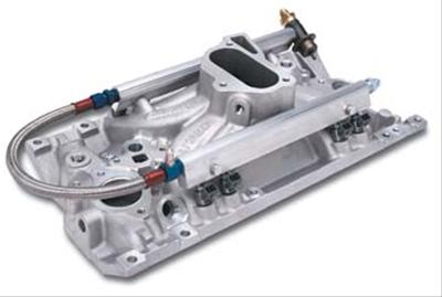

Just so you guys know I am still thinking about this thread...I found this and it looks interesting...I don't know if I have ever seen this before and not that I am considering getting it but I was looking at it mostly because if its design....
http://www.re-racing.com/store/produ...ducts_id=11015
If you have any thoughts about using MPFI with a lone TBI on top...feel free to offer up any ideas or input you may have.

Oh yeah your right I know...all my initial questions have been answers but I am pondering different variations...Its been nice finding stuff to look at and compare... that's all.
There's some interesting things I have been finding....this one does exactly what you talked about jwscab...I wish I could see an up close shot....
http://www.howellefi.com/shop/custom...13&cat=0&page=

yep, that's pretty cool, just pricey, which is going to happen when they sell you the whole package.
you could also buy an elbow and run a Ford throttle body, an LS1 throttle body, or similar style monoblade TB's, which may be cheaper than a 4 barrel, and lends itself well to supercharging.
