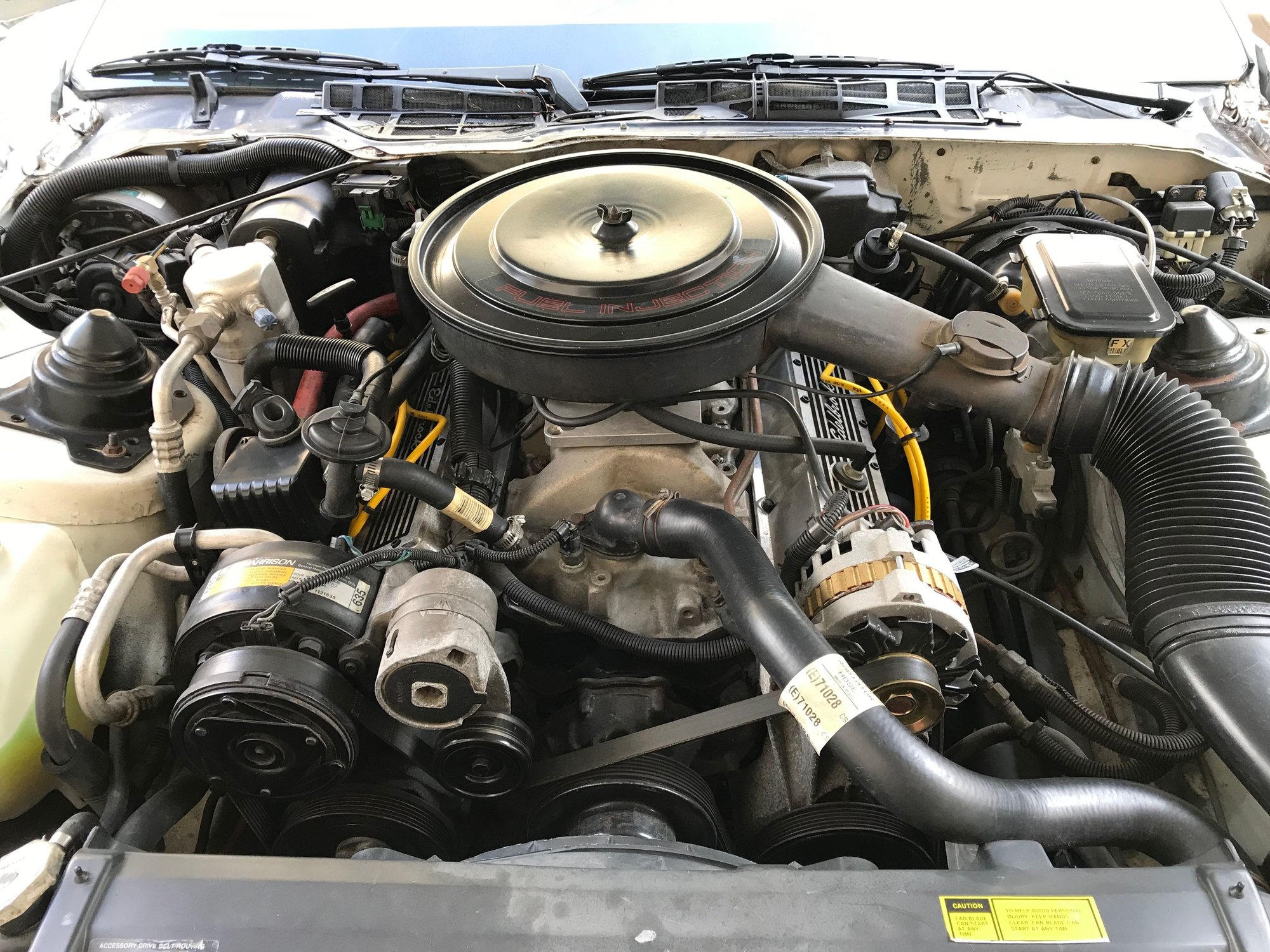

I was wondering if the below item/link was a direct replacement to the stock air cleaner lid to a TBI set up? Would this lid allow me to keep my stock 12" round air filter element?
The reason I'm considering this is I did replace my 305 with a 350 and I have a cowl induction hood that would allow fresh air to be drawn in thus, in theory, provide additional cold air for the intake for a higher flow requirement.
https://www.knfilters.com/66-1202-x-stream-top-filter
Has anyone ventured down this path and willing to share their experiences? Any lessons learned you'd be willing to share?

A Cowl induction hood allows a LOT more air flow IN-&-OUT of the engine bay compared to a stock hood that's sealed along the cowl,... & ( I think / I'm guessing ) there's even more air flow thru the engine bay when the cowl hood is vented.
I used a full-sized version of the "X-stream" lid for a little while when my ride was still Carb powered. Pretty sure that I've still got it kicking around somewhere,... IIRC it's 14". My cowl hood is vented & I never noticed any issues; or noticed any 'seat of the pants' improvements.
I just noticed you've got a plate under your TB,.............. reminds me that I've still got a TBI spacer plate too; IIRC that thing isn't supposed to do anything for the 305, but it's supposed to make a difference with a 350ci.

That setup you linked is for the car/truck air cleaner with a taller filter. If you run the matching truck air filter it'd all bolt together, but the added 1" of height might rub the bottom of the hood.
Helped a buddy put the typical 14" open element filter and K&N lid on his TBI car. It made more noise, and the perception was slightly more power, but it was going from the stock paper setup to a much more open setup. It looked cool, and made more noise. It takes more than a filter to make a TBI 305 faster.

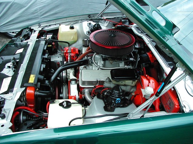

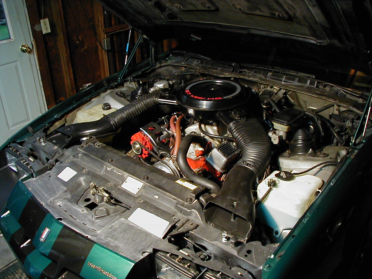

Good to point out there's a difference between a "cowl induction" hood,... and a plain ol' cowl hood. VERY few Thirdgen cowl hoods are actually "induction" anything; usually just a raised cowl to gain a little room under the hood for a high-rise intake and big air cleaner. Air cleaner-to-cowl induction seal on an actual cowl induction hood = very important; hood-to-body cowl seal on a regular cowl hood = meaningless.
When I used the X-Stream air cleaner I also used a K&N sub-stack. All that stuff was installed after an stock LG4 to professionally built 350 HP engine swap, so if I lost a pony or 2 due to turbulence,............ I sure didn't notice. ( I also didn't use JUST a filter-lid on a stock air cleaner.) I wanted to leave the GM stuff but what was working 'just fine' wasn't good enough in my case.
I paid to have a well known local 'carb guy' jet the Carb but the engine always ran pig-rich so I wanted as much air to pass thru the carb as possible. I replaced the factory HO air cleaner and truck 350 air cleaner lid with an X-Steam lid & a K&N 14x3" air cleaner. Pulled-in WAY more air than the HO air cleaner could ever hope to. ( so significant, you could smell the obvious difference before and after swapping the air cleaner stuff.) The engine still ran a little rich,.. but MUCH leaner than it was.
