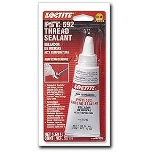

Using thread dope on thermostat bolts is rarely a bad thing--depending on the chemical used. SOMETIMES the bolt hole actually breaks through to the coolant passage, in which case either Loctite 592 or 567 are miracle workers. If the bolt hole does not break into the coolant passage, I'd prefer anti-seize to thread sealer.

Originally Posted by IndyL03
struck the jacket
I have to decide if the manifold needs to be swapped
