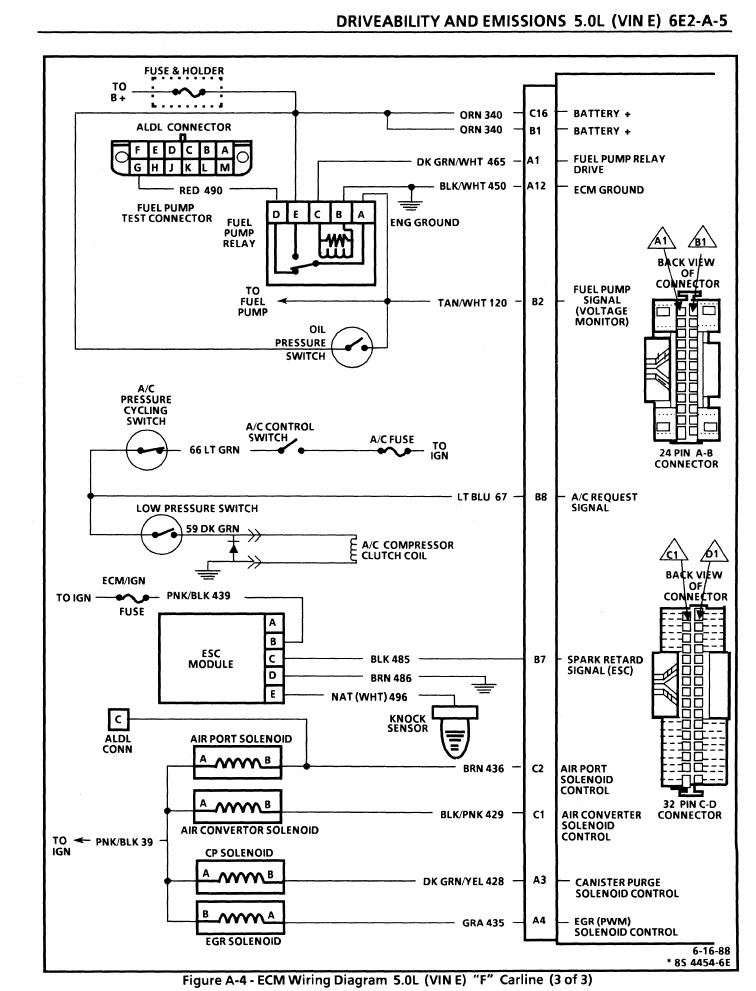

How do I check ECM voltage and grounds?
terminal B2 for fuel pump voltage
engine grounds on back of cyl. head
Attached Thumbnails Start issues, CODE 13, 22, 44, 54! Dear god, help me!-ecm1.jpg   Start issues, CODE 13, 22, 44, 54! Dear god, help me!-l03-engine-wiring-lt.jpg

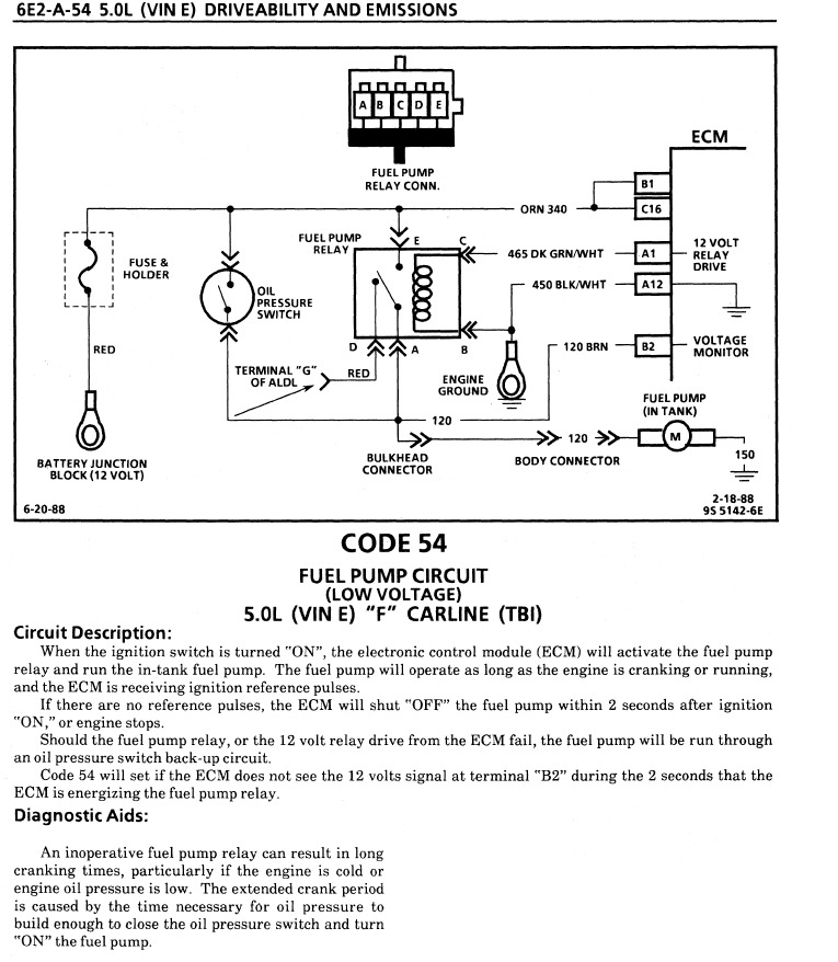

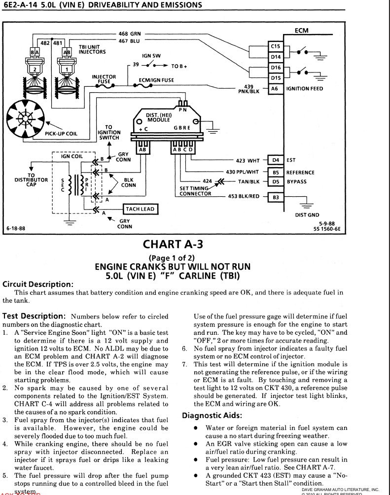

Crank but no start troubleshooting charts
6E2-A-15 box 1 - code 54 set, use code 54 chart.
Attached Thumbnails Start issues, CODE 13, 22, 44, 54! Dear god, help me!-chart-a3-1.jpg   Start issues, CODE 13, 22, 44, 54! Dear god, help me!-cahrt-a3-2.jpg
Old Jun 20, 2013 | 05:57 PM
Zed/28's Avatar
Joined: Jan 2013
Posts: 58
From: So Cal - El Cajon
Car: 89 Z
Axle/Gears: 10 bolt 3.23
Re: Start issues, CODE 13, 22, 44, 54! Dear god, help me!
code 54 charts
i would clear up the code 54 first and take it from there.
Attached Thumbnails Start issues, CODE 13, 22, 44, 54! Dear god, help me!-code-54-1.jpg   Start issues, CODE 13, 22, 44, 54! Dear god, help me!-code-54-2.jpg
