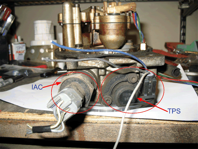

Matt
a) Checking TPS by itself - removed from TB (lets be clear - it is not a cab since there is no venturi) or even if TPS installed on TB.
Parts identification below
Since you have '91 you have a late model TPS like the one in the photo above. To verify TPS functionality requires DVM. If you can get pig tail from Junk yard (like it is shown in the photo) measuring TPS resistance between its terminal is much easier. Poking inside socket well is a royal PITA while trying to get a good contact. If you get a pig tail measure resistance between pins A & C (Gray and black) should be around 6 kOhm, pins C and B (black and blue ) will vary depending on throttle shaft position from about 1 kOhm to about 6.5 kOhm.
2) IAC = Idle air Controller. It is best to leave it bolted to TB. The way to verify if it is functional is force ECM into diagnostic mode by jumping Pins A & B of ALDL plug located on driver side. With ignition on ECM will force IAC into a fully extended position. You'll hear IAC click continuously while the jumper is in (while ignition key is in run position). You should see IAC pinticle head protruding through the air by pass orifice just above TB attachment bolt (11 o'clock).
3) ECM = electronic control module. This is a computer which monitors and controls EFI functions
4) ICM = Ignition control module. This part is mounted inside dizzy and provide points functionality.
