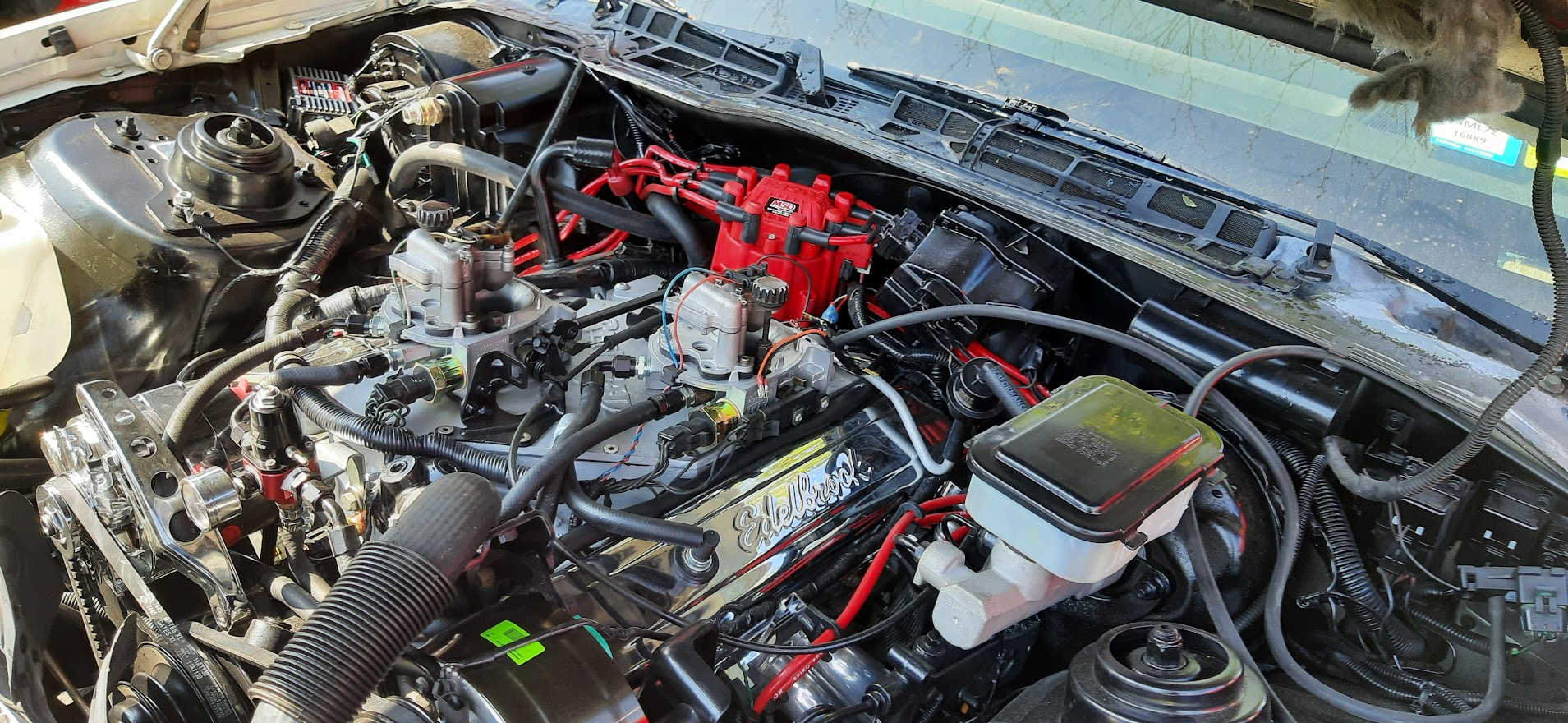

Old Sep 27, 2022 | 04:50 AM
  #59
KITT1983's Avatar
Joined: Mar 2008
Posts: 2,943
Likes: 20
From: Boston, MA
Car: 1983 Pontiac Trans Am Daytona 500
Engine: Crossfire 305ci V8
Transmission: Jasper 700R4 4 speed Automatic
Axle/Gears: 3.23 limited slip/posi
Re: 350 crossfire injection motor build
any good free picture hosting sites ?

I need help with ebl flash tuning I got the lc2 wideband o2 installed
Old Sep 27, 2022 | 08:32 AM
  #61
84 4+3's Avatar
Joined: Sep 2021
Posts: 93
From: NJ
Car: 84 vette
Engine: L83
Transmission: Dougnash 4+3
Axle/Gears: 3.08
What do you need help with?
Old Sep 27, 2022 | 08:33 AM
  #62
DynoDave43's Avatar
Posts: 4,844
Likes: 926
From: MICHIGAN
Axle/Gears: 10 Bolt 2.73 Open
None that I know of, or trust not to go all "photobucket" on my later. When ownership at the bucket when crazy, holding images captive for insane new membership fees, I switched to Flickr. Costs me a few bucks a year, but is very stable, and I have unlimited space.
Have you tried this thread here?
https://www.thirdgen.org/forums/diy-...uning-ebl.html

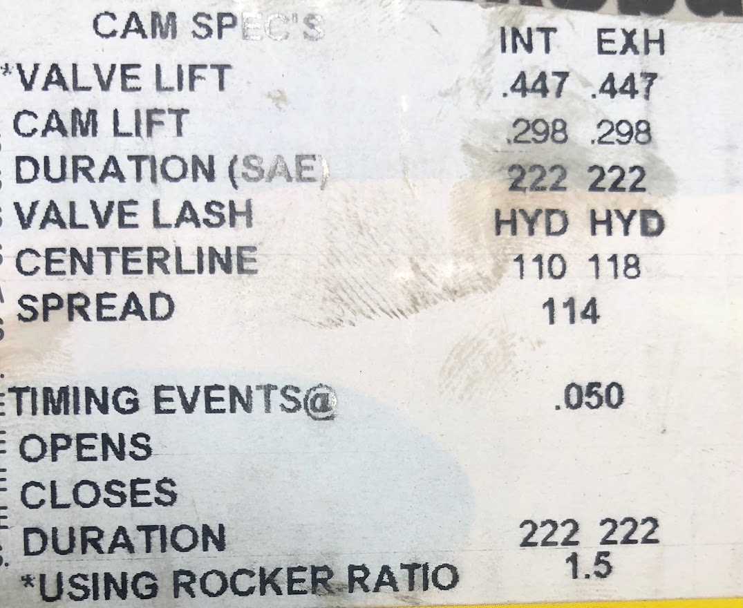

Holy WAYBACK machine! Isn't this the old Crane FIREBALL 296 camshaft?
Looks more like an aftermarket clone of the 350 hp 327 grind. Which is similar to the L82 grind I had in a TBI 305 with 081 heads long ago. Those cams are happier around 11:1 then they are at 8.5:1.

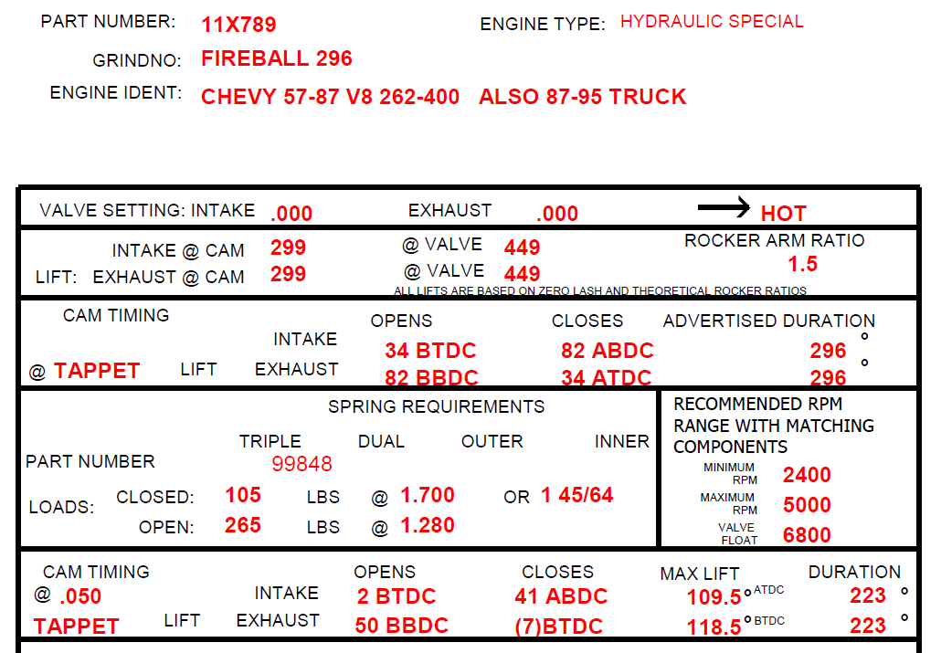

so how is my cam
hows my cam thats close to it

Here is a generic description for your camshaft: (from Elgin) Look at E-903-P
Range C (Hydraulic: 210° - 225° Effective Duration)
(Mechanical: 220° - 235° Effective Duration)
Fair idle quality with lope. Good mid-range torque and response in 2400 - 3200 RPM range. Operating power
range 2000 - 4800 RPM. Good fuel economy cam with correct equipment. Good choice for light towing.
Compression 10.3 to 1 or less. Will work with stock or slightly modified engine, stock automatic or manual
transmission. Recommended spring pressure 110 lbs. for valve on seat; 280 lbs. for valve open. Axle ratio
3.70 to 1 or higher is best. Recommended for mild bracket racing.
