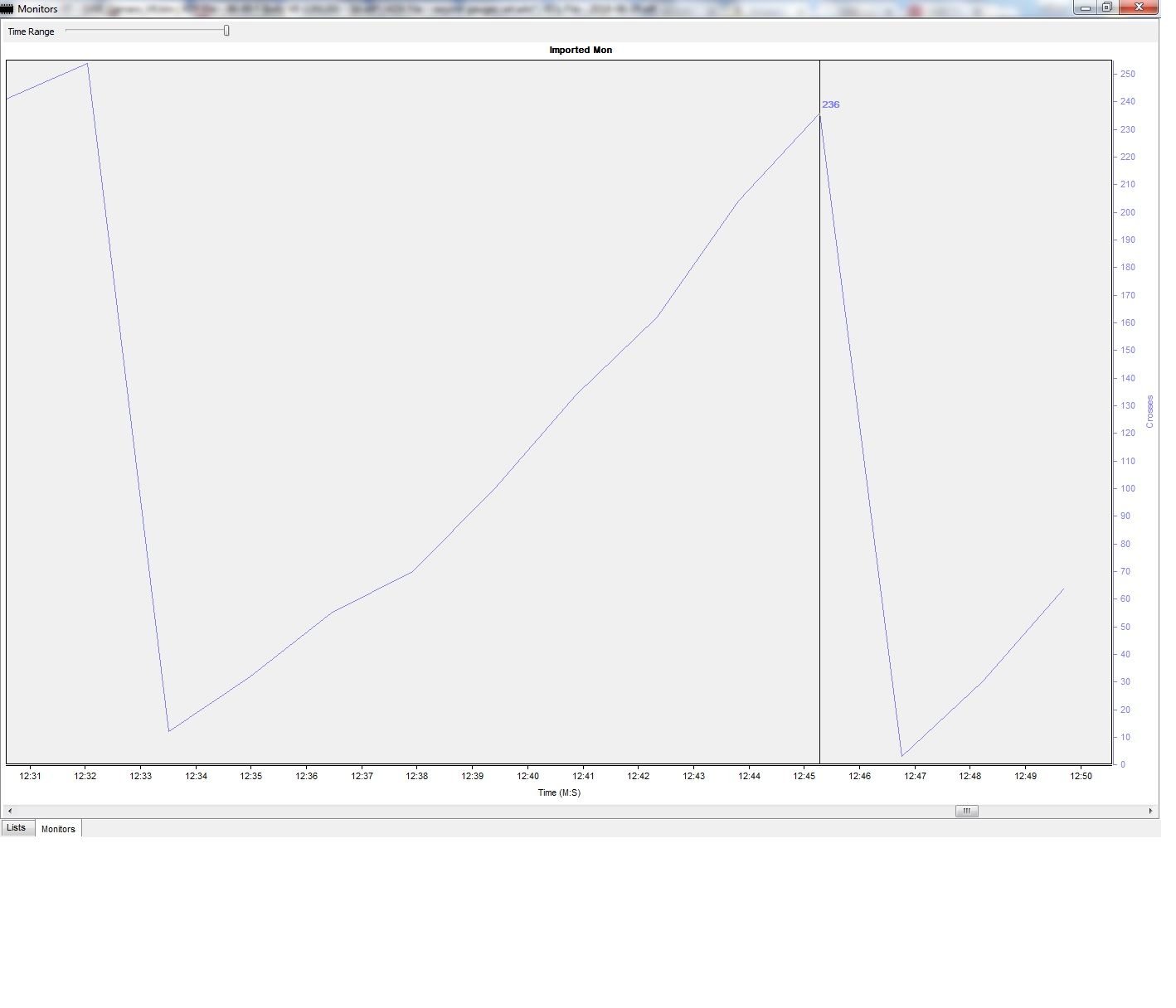

I played around a little more with TunerPro today.
Viewing a datalog from an arbitrary recent run, it looks like TunerPro is reporting crossovers based on about a 15-second interval.
Here is a screenshot of the "Monitors" tab, set for monitoring only O2 crossovers. There may be some way to change the monitoring-interval, but I haven't figured that out yet. Probably if you go into the "scalars" or some such in the menu, you can change the available monitoring interval for crossovers. There is a "time range" slider at the top of the graph which will allow me to select a LONGER montoring-interval. You can see I have the slider pushed all the way to the right, go give the shortest possible monitoring interval.
Anyhow you can see how the graph-line starts low, and then progresses upward until whatever point TunerPro wants to restart the count - in this case about every 15 seconds. I guess a smooth upward arc is indicative of an O2 sensor that isn't cutting-in and cutting-out, or just simply dead or disconnected.

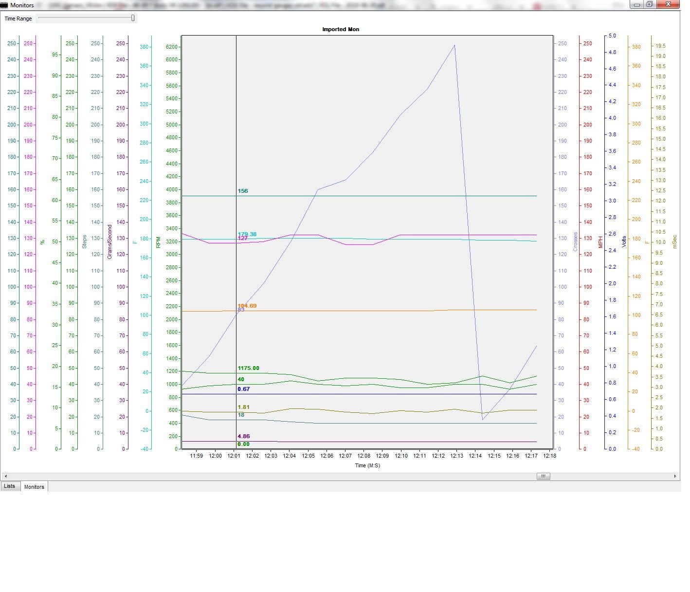

You can go crazy, and show all inputs on the graph if you want.
Maybe helpful for pinpointing how the ECU reacts a when specific sensor is reporting something that just can't be (or shouldn't be) right.
