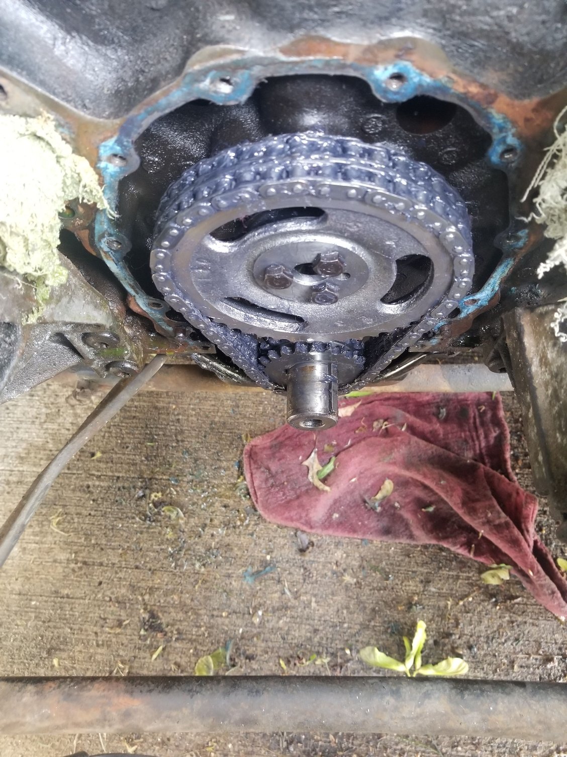

Old Apr 28, 2019 | 11:20 AM
92RS-HeritageEd's Avatar
Joined: May 2015
Posts: 674
Likes: 23
From: Ohio
Car: 92 RS / 90 IROC-Z
Engine: 305 / 350
Axle/Gears: Non-Posi / Posi - Both GU2 - 2.73
Re: L03 Timing Chain Replacement
I don't know exactly what i'm looking at or for BUT more blue gaskets and black rtv at the corners where the oil pan is...
If I thumb either side of the chain like a guitar you can hear the "slop" is it called? Is it supposed to be super tight with little to no movement?
Old Apr 28, 2019 | 11:29 AM
Tuned Performance's Avatar
Community Influencer
iTrader: (95)
Posts: 16,925
Likes: 1,016
From: Mile High Country !!!
Car: 1967 Camaro, 91 z28
Engine: Lb9
Transmission: M20
You can measure the chain deflection. Regardless your in there just line up the timing marks and install the new chain. Soaking the chain in oil isn’t a bad idea. You might also look at the front of the cam for cam I’d marki. Someone has been in that engine just to reaseal or maybe a rebuild or cam swap.
Old Apr 28, 2019 | 11:51 AM
Joined: May 2015
Posts: 674
Likes: 23
From: Ohio
Engine: 305 / 350
Lined up, tried checking for "slop" here, the right side won't budge, the left side is like a loose bike chain. Is there a way to keep it from moving while applying the ratchet?
Old Apr 28, 2019 | 11:59 AM
iTrader: (95)
Posts: 16,925
Likes: 1,016
Engine: Lb9
Transmission: M20
Depends on what rotation you moved the engine what side would have tension on it.
do you have a impact ?
The bolts should only be around 20 ft lbs in torque. You can always put a wrench on them and shock with a hammer. Or put a piece of wood between the cam and crank gears to illuminate movement.
just don’t get any debris in the pan.
As for your other post with the 880 casting. This could be a 350.
You will have to look at the block casting behind the drivers side head.
It will say 5.0 or 5.7L.

Minor setback, I can't get the 3-jaw puller to seat, while I hold the washers in place and try to turn the bolt. Might need to buy a gear puller or take a mental break and give it another go.
UPDATE: Went to Harbor Freight and grabbed a Gear Puller set and still can't get the crank gear off. Is there a secret way to remove it?

It’s a press fit but it’s not pressed on real tight. You can always heat up the gear with a propane torch.

In every YouTube video I could find the crank gear came off with a 2 or 3 jaw puller but I still can't get the crank gear off. It's like the tighter I crank the pull-rod against the washer vs the crank gear pulling off the crank wants to turn so I keep stopping. This is extremely discouraging for a noob...
Is there any other option safer than a torch?

Make sure the key that keeps the gear from turning on the crankshaft isn't somehow preventing the gear from coming off. The propane torch IS the safe option, IF (big IF) you're giving up on pulling it cold. After that, it's a matter of splitting the gear with a hammer and chisel, and nobody really wants to do that. Too easy to mess up the crank snout.
In MY shop, I'd screw the crankshaft damper bolt WITHOUT THE BIGASS WASHER into the end of the crankshaft, grease the threads of the 3-jaw puller's forcing screw where it goes through the puller body. Put the 3-jaw puller back on the crank gear, . The forcing screw plugs into a cup at the bottom end--either a cone or a flat surface depending on what you're pushing against. Use the cup that has a flat surface to push against the bolt threaded into the crank.
Hit the bitch with a 1/2" drive impact wrench turned up to "11".
Done.
If you don't have an impact wrench (shame on you!) LOCK THE FLYWHEEL somehow, as you turn the pressure screw of the puller. A flywheel turning tool, held by a helper so that the flywheel can't spin in the direction you're turning the wrench/ratchet would be fine.
But, yeah, if that doesn't work...warm the gear with a propane torch, reconnect the 3-jaw puller, and see what happens.

I've tried at least 3 more times, all fails. My impact wrench wont clear the radiator and onto the bolt, when I tried the torch the tip of the torch started glowing red so of course I bailed, safety first. The best news I have is that I haven't damaged the crank snout or its threads.
This task is however on hold until my mechanic arrives Saturday morning. I'm going to take a vid of how he takes it off.

You just stick a large screwdriver through your 3-jaw and use it as a lever to keep the crank from turning while you crank on the puller. It's easy.

Idk if it was divine intervention or the long extension bar I used as you suggested GD but WE'RE BACK IN BUSINESS. I'd like to note... as Tuned pointed out earlier it wasn't that tight of a pressed fit after all!

New crank gear went into the oven pre-greased for 20 min or so @ 300*ish. Grabbed the leather gloves, grabbed the pan from the oven ran outside and on the first try got it in the keyway for 0* w/ dot in what looks to be the same position as crank gear that was removed!
It's about 1cm or so from fully seated however so now I have to get a gear installer but I'm making progress.
EDIT: No local parts store has a Crankshaft Gear Installation Tool, they claim it's a special order only. Is there anything that can be safely used instead?

You can use a brass drift to drive on the gear. Beating on the gear does push on the engine thrust bearings so I always like to use a brass drift.

idk what a "drift" is but I ran to Menards and grabbed a 1-1/2 X 4 pipe nipple. Placed a towel over the crank snout & gear then slid the pipe over it. Fits nice, started tapping at it w/ my rubber mallet... no dice. Might have to try pulling it off, going for a longer bake period for more expansion and trying again since no store in the region has the tool.

You can use a pipe nipple under the harmonic balancer installation tool to push it on. You can get a harmonic balancer install tool from any parts store. A brass drift is just a flat, straight or tapered punch made of brass.

Went w/ Plan B (lol) and pulled the crank gear off > back in oven at 350* for 30min > greased crank snout while waiting. Repeated install and it fully seated, I heard the "tink" as the gear met its stopping point. Let it cool for about 30 min, lined up the dots, and fought to ensure the chain was on the right tooth to get there (SUPER PITA) but now it appears to be on and has no slack. I think can break out the torque wrench now!
