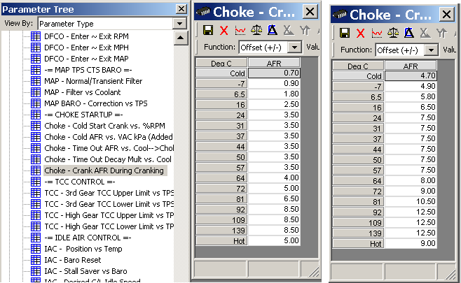

I believe I got it. Last night In the flag : "Crank AFR During Cranking" I bumped it up 4 all the way around and it started and ran right off the bat this morning. 36 Degrees. Still takes about 4 cranks to start but its been that way as long as I have had it running. Is there a flag or skalar that can shorten the crank time? My head starts hurting after looking at all the possibilities. My Jeep CJ with a 360 that I TBI'd last year starts after 1 crank. Not because of something I did on purpose, just lucky I guess. On this truck I believe I started with the factory bin AKDY or AKDX, not sure which. I raided my local pick n pulls and picked up 5 or 6 7747 ecms when I was doing my CJ.
The one on the left was what it was....right is what it is now.
Yes, that original table is quite rich. As for the long cranking, does the fuel pump run at key-on, engine-off? If you used the fuel pump oil pressure switch, that may be what is triggering the pump. Once oil pressure is over 4 psi.
