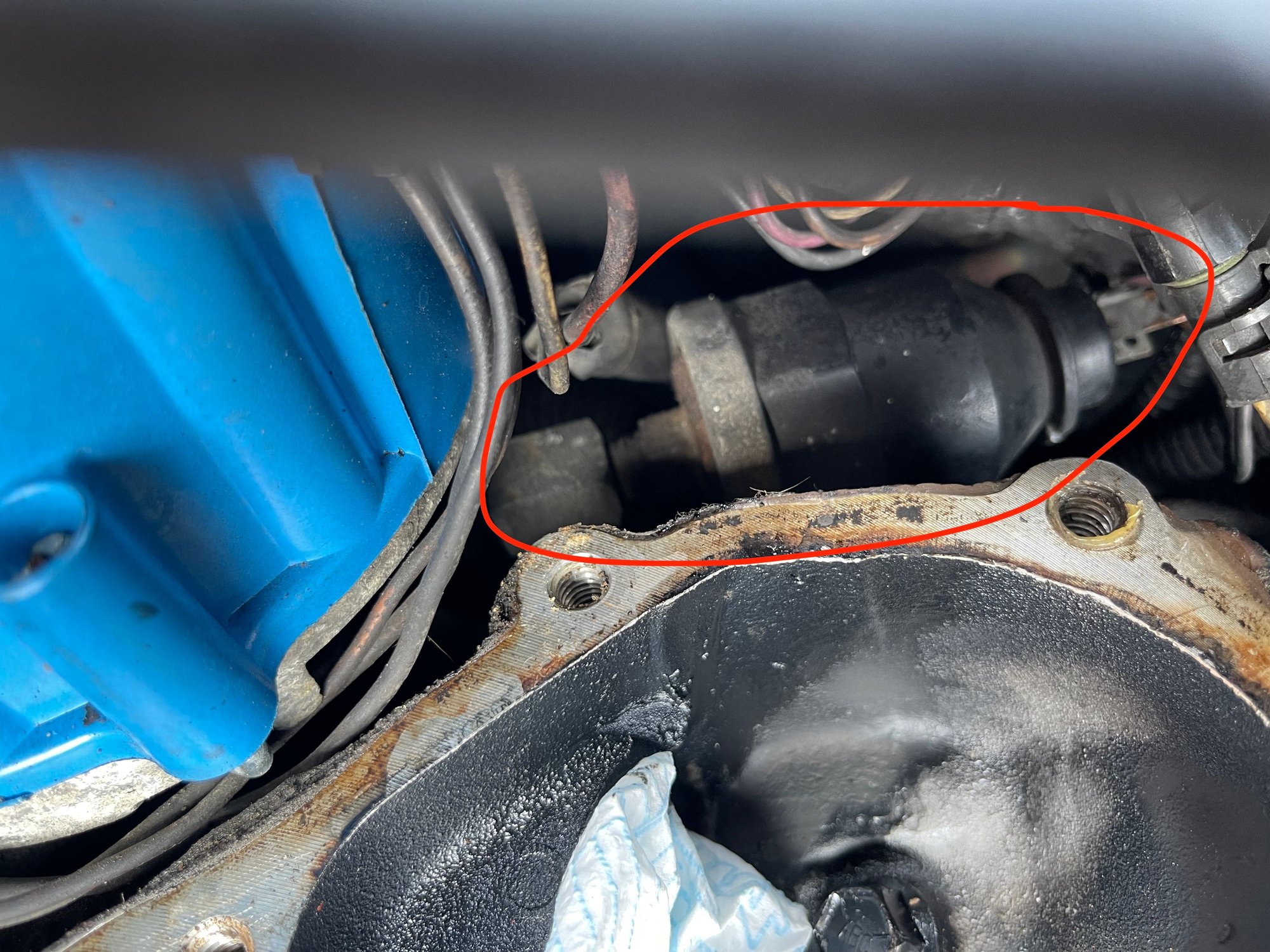

1) Whats this next to the distributor? It has 3 pins on it, but has been unplugged on my car.
Whats this?

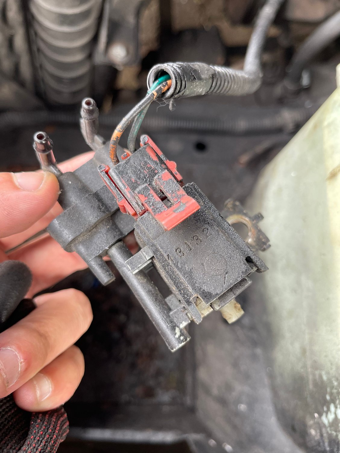

thanks for the reply LU5. The previous owner has actually removed the charcoal canister and has capped off all the vac hoses that go to it!
All I’m left with is a hard line that comes up the drivers frame rail and terminates in the engine bay venting to atmosphere. There is also this part which is plugged in but has no vacuum or other lines going to it:
As for codes, I will need to look into that. I assume it’s pre obdII so will need a special reader?

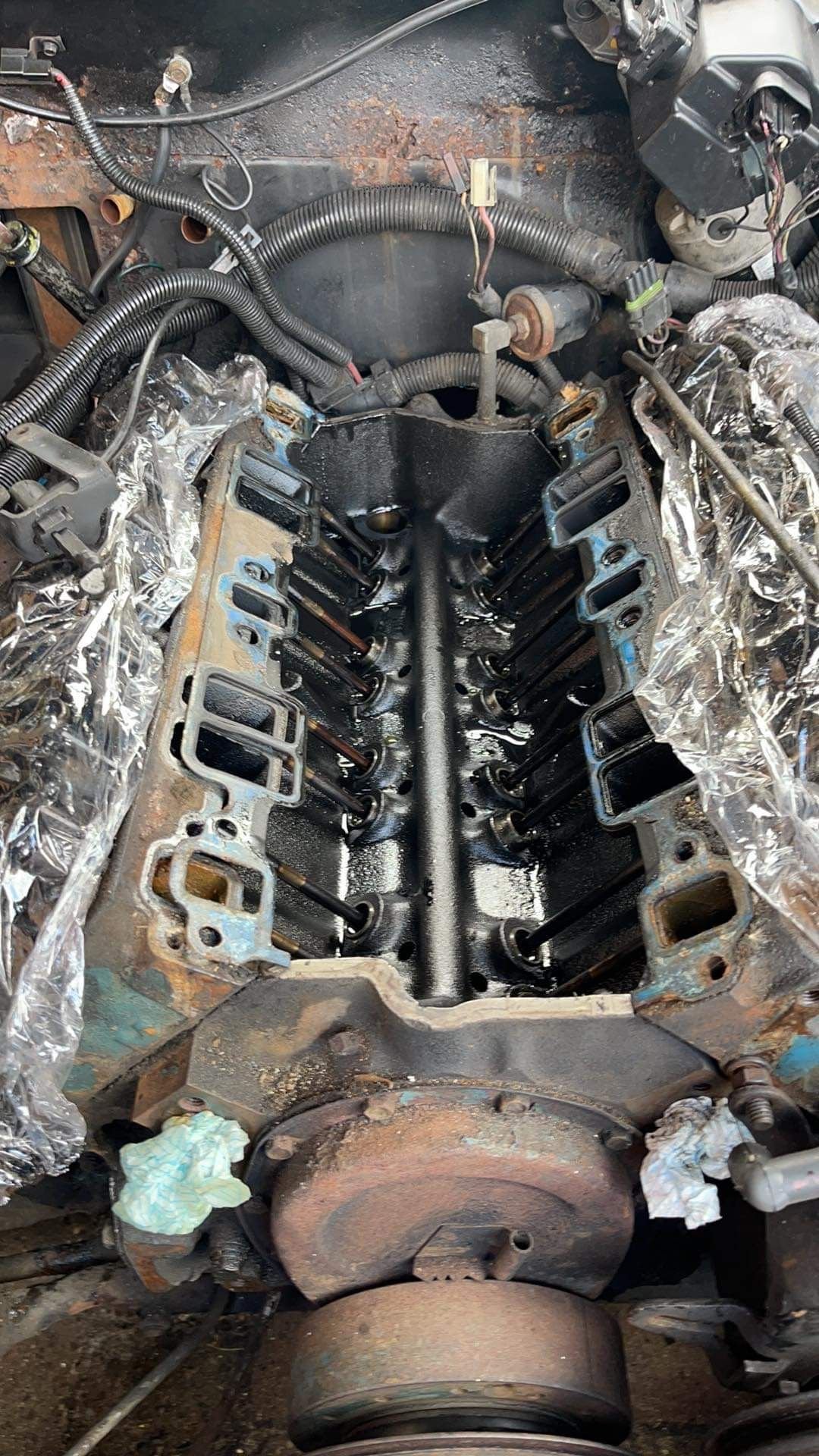

well I made good progress today
Have got all new gaskets to seal this all back up and have deleted almost all of the vac lines that were for emissions, cruise control, a/c. Did a compression test on all cylinders (150psi across the board) and will start putting it back together tomorrow

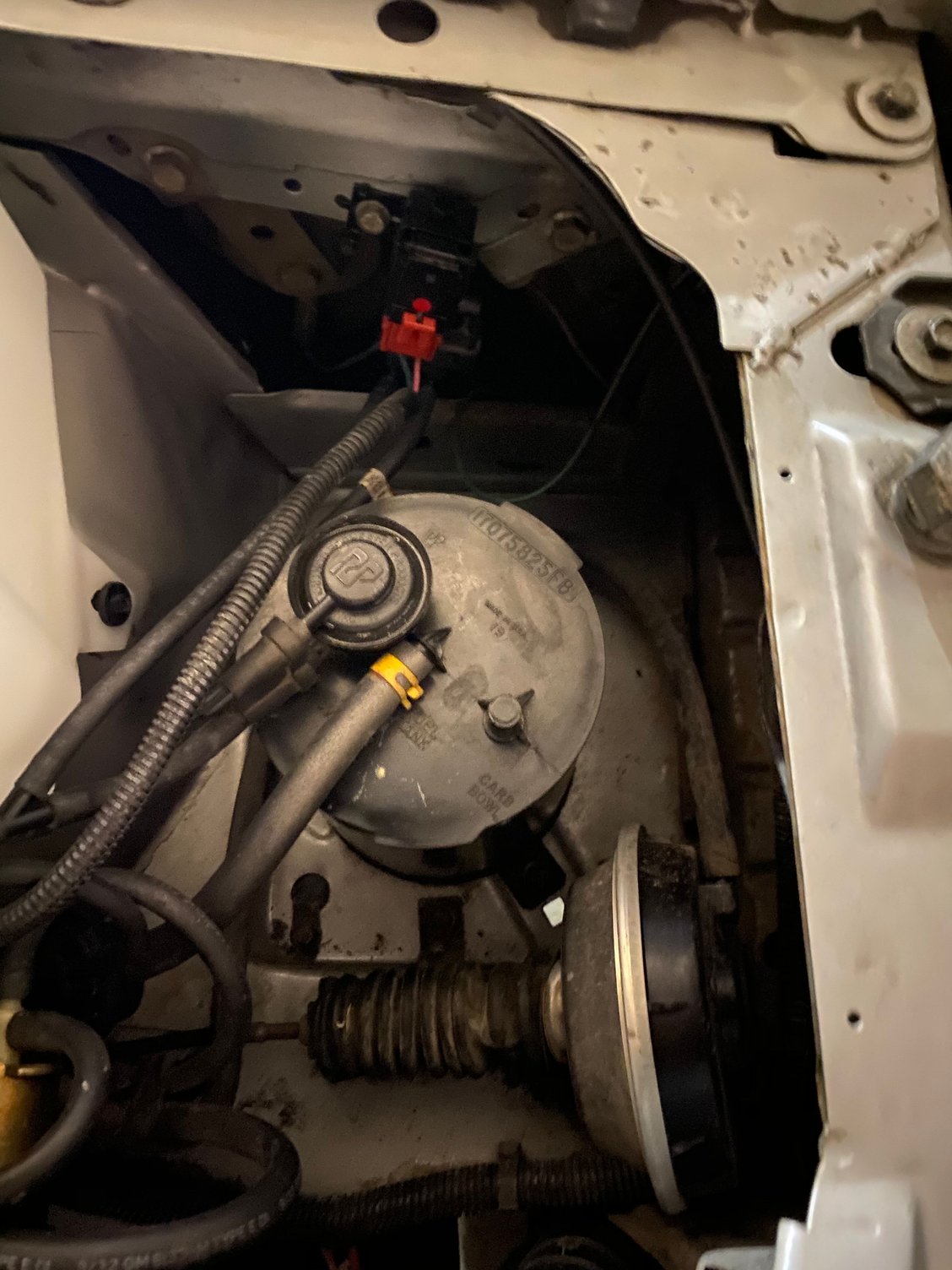

That was pulled right off the canister and with the canister gone its definitely going to be causing you some issues. The Cross-Fire engines are engineered to run their best with all the emissions control equipment intact and proper operation from the computer reading input from the engine and related sensors. That doesn't mean you can't run it without the emissions system/evaporative system (canister) but you'll have to spend a lot of time trying to tweak it to work. You will be further ahead returning the emissions system/evaporative system back to 100% stock. Not to mention the resale value of your Trans Am will be more with the emissions system intact and functioning properly. I recommend this 1982 Firebird Service Manual, it has everything you need to keep your 1982 Trans Am and it's Cross-Fire system running properly, it was the manual the mechanics used back in the day at the Pontiac dealership service departments when servicing 1982 Trans Ams and Firebirds:
https://www.ebay.com/itm/322393177201
I'll take a picture in a few hours of my canister and the wiring and post it here for you. If you need a canister, I may still have a spare one (I'll have to check), however it may need to be restored. This requires cutting it open at the seam replacing the charcoal (with fish aquarium charcoal) and sealing it back up with a sealant/glue.

Here's the picture of the canister and the wiring you'll notice that solenoid with the two little hoses connected to it is mounted in the area on the inside front part of the front fender and you can see how it's connected to the evaporative canister. You'll notice that the canister number is 17075825FB which is the original canister that the 1982 and 1983 Trans Ams and Camaro Z28s with Cross-Fire used (carb equipped cars used another model canister). I am still looking for a spare canister (17075825FB), I have a few more old part boxes to go through in my garage which I'll go through in the next day or two to see if I can find it. If you need me to take any more pictures of anything in the engine bay or anywhere else let me know. Also the link to the 1982 Firebird service manual above is a rough one, I found one that's a little bit more money but appears to be in much better condition: https://www.ebay.com/itm/334093361660
