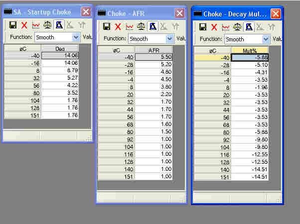

So threads are telling me to check FP... Looks good turns on for two seconds then drops and getting TBI pulsing while cranking. Since it starts nicely with a little extra manually "injected" fuel I'm thinking whatever controls that initial squirt needs to get jacked... Here's my tables - suggestions on which one and how much? Thanks.

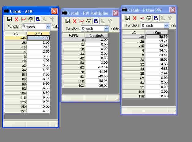

Re: "84 Xfire Cold Start Issue
... or maybe one of these.
Skip the choke tables, they are after-start fuel.
Have you checked the fuel pressure? It needs to be between 9 & 13 psi, the higher end is better. And once cranking is the fuel pressure OK?
Can play with the prime PW, but since it is a one shot deal, need to have fuel pressure at first crank. So if you key-on, wait for the pump to turn off, no prime fuel will be injected.
Leave the PW multiplier table alone, that is for the crank to run transition.
Which leaves the crank AFR table. They are the actual cAFR values. So lower is more fuel.
RBob.
RBob.
Thanks for response. FP is there @ ~ 20 psi. I jacked the prime PW way up and made sure I didn't hesitate cranking. It started in a couple of seconds a major improvement. So it's one or the other. I know what to mess with now - thanks again.
