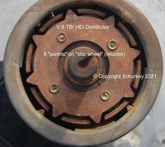

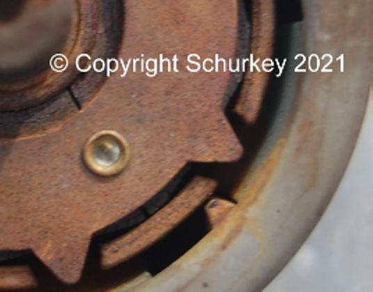

Have you verified the magnet on the TBI distributor? REALLY common for them to be cracked (usually but not always through the riveted area) and providing the ignition module with faulty information.
