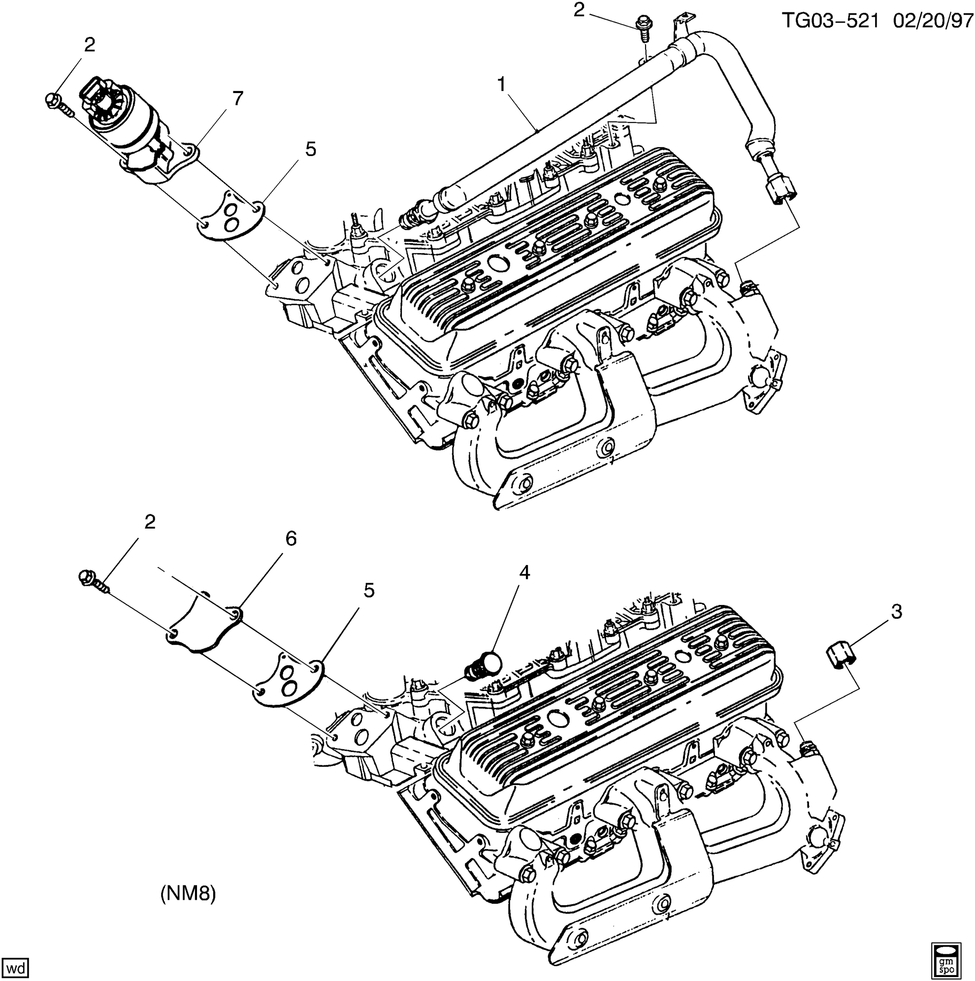

Needed to be tuned when it was stock. I never got less than +2-3 mpg, 20 whp and 30 wtq gains tuning a stock engine. With tri-y headers, high flow 3-way cats, LT4 roller cam, 1.6 rockers, RPM intake manifold without EGR and a 2" bore 454 TBI my L05 actually ran cleaner tuned than it did stock. It also made 250 whp and 310 wtq with the stock heads and 8.75:1 compression ratio. The emissions standards on that were for the non-catalyst equipped non-feedback carbureted stock engine with dual air pumps. One of the nice things about using the later TBI truck engine, no air pumps needed. That was using the emissions dyno in training mode to see what the emissions output was like after dialing the tuning in. Anybody causing failing emissions from tuning needs to learn how to tune. EGR was always a joke too, GM did away with it on pretty much everything that had it in 2003 without changing the engines just altering tuning. The 4.3L, 350, 4.8, 5.3, 6.0L, 8100 and others all dropped EGR in 2003 and most had factory block off plates. The factory GM block off plates actually had a smog guy arguing that I had deleted the EGR on the stock 2003 L31 350 powered Tahoe I owned later on in the 2014 time frame.
Factory GM EGR block off plate on a 2005 Silverado 3500 L31 350 for example.
