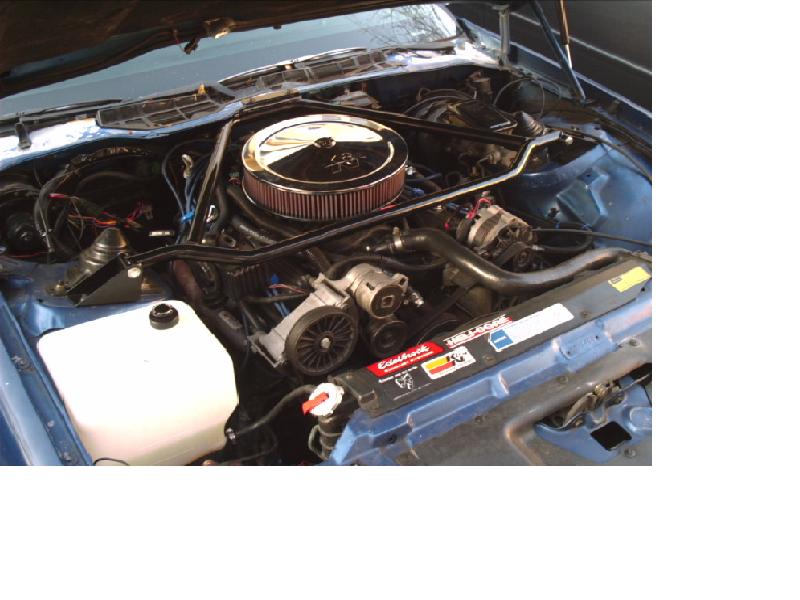

here a pic of my engine bay, it is kinda hard to see where the AC was but i will get some better pics in a day or two.
