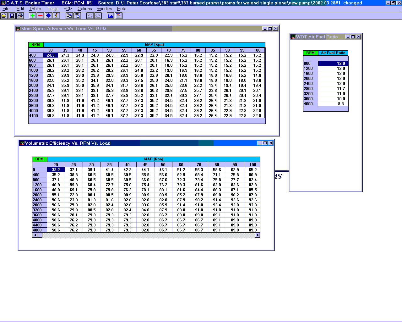

ok gents this is the problem:
the blms are tuned and the truck runs great with the combo i have below. it has the lower curve tuned for somtime but when i go wot this is when the engine begins to loose power and start missing and sputtering. i thought it was because of the stock fuel pumps so i finally brokedown and purchased two walbro fuel pumps 255. these babies can pump the fuel. i adjusted the pressure to 15psi on the tbi. i still have the same problem with the missing at about 3600rpm and up. my feel is the engine is leaning out, the o2 count drops below 500mv and if i backoff the throttle abit it stops. with the alum heads, single plane this unit is getting too much air and not enough fuel imo. could the 454tbi just not have the capacity to feed this combination? i even checked my spark curve which has 22deg advance at 4000rpm 100kpa. i even dropped the woth afr to 10 at this rpm, no change. even maxed the fuel to 100 on the fuel curve at lower right corner of the ve curve, and nothing changes. injector constant is 120. i am lost with this, like i said the engine wants more fuel at the top ends. at the lower rpms is runs great with nice response. should i change fuel pressure and to what. the cam is degreed in to 6deg advanced for max torque. could this be causing this? i have not done a plug cut but from what i remember with the old fuel pumps it was running lean at wot. the old pumps had 12psi. getting back to the cam i don't think the advance is causing this because it doesnt happen when i rev to 4000 with no load (vehicle is parked). it has something to do with load. really believe it is a fuel problem.
i attached a screen shot of the ve, spark, wot afr.
91 chevy 4x4 sbc 383 stroker, 64cc 23deg trickflow alum.heads c/w weiand xcelerator single plane, adapter, cam is an extreme 4x4 comp. Cam. 12-235-2 grind ( .447/.462 lift, duration 210 218 lift @50, 111 lobe separation) . unit has hypr. Flattop floating pistons, eagle cast crank, 5.7eagle rods, bal.to 0.5grams, 10.2:1 comp. Headers c/w 2.5” flowmaster exhaust. 16147060 pcm, $85def
454tbi 80lbinjectors

This won't help solve your problem(s) but your VE table reaches around 93% at 2400 rpm... which is where the engine used to make peak torque with the stock engine and cam. With your engine and 210/218 degree cam, it's more likely that you reach max VE near 3500-4000 rpm... so the 100% load column should be modified to reflect that. And that means the whole table needs some tweaking. IMO.
Your spark advance table vs load vs rpm also seems a little unsmooth. Again IMO.

Just like everybody else has pointed out...your VE table doesn't look right. What is your VE #2 table? Remember that the table 1 and 2 are added and shouldn't total more than 100, if it does it's ignored and thought to just be 100.
I would crank the fuel pressure up a LOT and mess with the VE table, set the BPW to something like 130 and just adjust the VE tables. Drive in drive, try to avoid overdrive. You can also just try and adjust the AFR to an even lower number to verify that the car is running lean. What is your pump shot tables looking like? Would you post the bin file here so I can look at everything else.

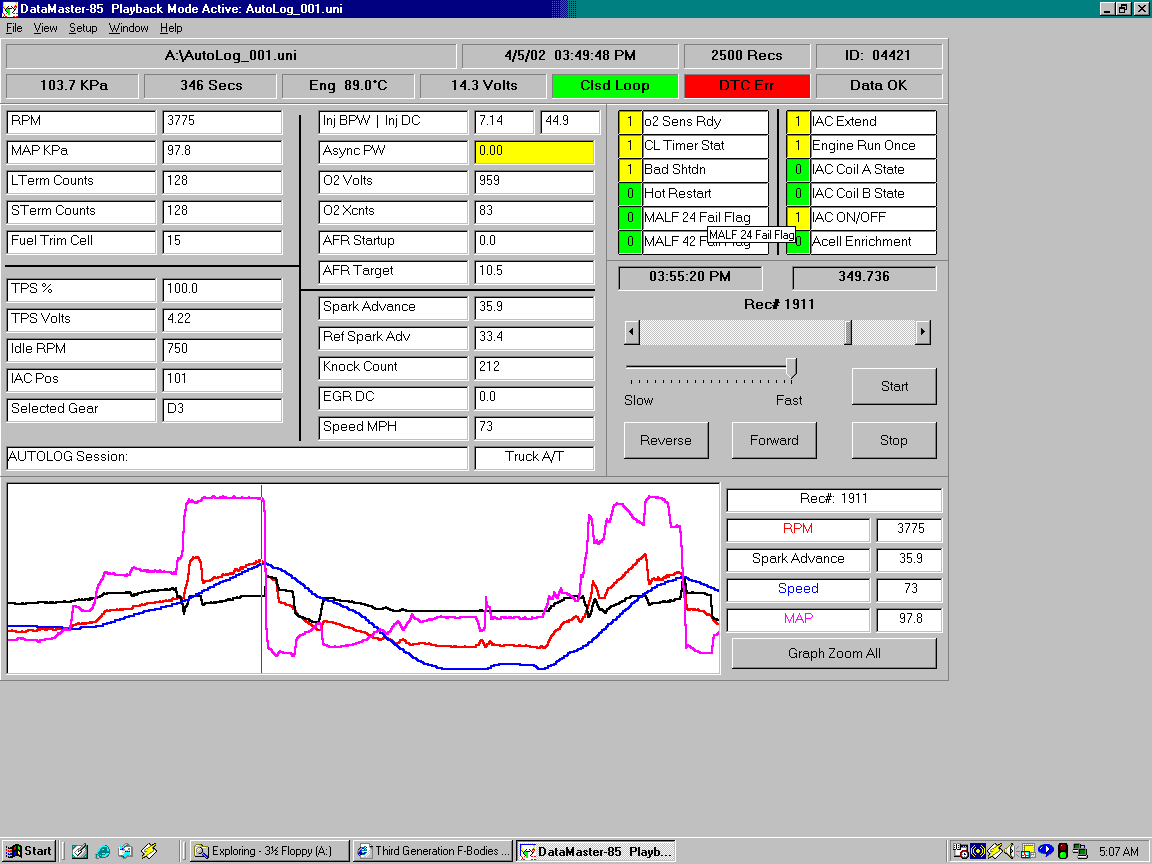

. 383 tbi scan
ok gents, hear is a scan at wot for short run. notice the knock count (ouch!!!), 02 is rich, injector duty cycle never gets over 45. need your thoughts. i am going to post the other wot short run after this so look at this screen shot.
note: the o2 never drops below 850, also the red vertical line is where the data coms from on the chart.
IMO:
Your fuel table is too lean. So, when at WOT, like your pix of scan tool shows, your BLM and INT are locked at 128. This FIXES your ECU to run at your table values, which I argue are TOO LEAN!
ie, You are encountering LEAN KNOCK at WOT that will never be cured unless you up the FP and/or up the BPW at WOT to make the motor run at 13AFR or less! The DUTY CYCLE shown has nothing to do with feedback of rich or lean at WOT,as the BLM's and INT are locked at 128. AS such, your BPW value used is a default from your tables, which are lean!!! before you ran my curve, I hope you turned your EGR advance OFF (0 degrees in entire table and/or disabled EGR!!!) and turned your PE advance off (0 degrees in entire table)!!! If not STOP DRIVING THE CAR NOW and fix it...
Comments?
Comments?
yes all are turn off many moons ago. i ordered a new mallory 4309 regulator which will give me the fp i need. as you can see i didn't push things. i even tryed to put a different spring for another 454tbi and i got to 17psi but thats it. will keep you posted on my ventures. how can you tell from the scan that i am running lean other than the spark knock from the fuel curve you gave me?
You can't tell from the scan that you are running lean. Its a guess based on the symptoms and specs you report.
The only way to tell if you are lean is:
A) A WBO2 sensor. This will show gross deviations from the AFR's where NA engines usually run. The stock O2 volts mean nothing.
B) Performance testing. GTech/ Vericom / Dragstrip (MPH)/ Dyno
If you increase fuel delivery and performance increases, you are lean.
First thing to do is go back to your previous Spark Table values. You have a fueling issue, so you don't want to be changing two areas at one time. Take care of the fueling problem first.
I wouldn't bother working the fuel tables or BPW until you have the new FPR installed because any changes you make will have to be redone.
After you have the new FPR installed and the pressure is set to 25 psi, see how it runs at WOT. If the missing dissappears you are on the right track. Take some performance measurements for a baseline. Without measurements you are wasting your time.
Now its just a matter of juggling the VE table, WOT AFR and BPW so that you have the right amount of fuel. If the VE table is maxed at 100, Duty Cycle is under 90% and you are still lean, the BPW needs to be raised or the WOT AFR table needs to be lowered. Since you are already at 10.5 on the WOT AFR I'd raise the BPW first.
You want to keep an eye on the DC at 5000+ RPM's and make sure it stays under %90. Optimally you want just enough FP that the injectors have to run around %85 at peak HP. This will provide you with enough dynamic range to keep the injectors stable at idle, low speed and WOT.

It sounds like you are changing too many things at one time. I would go back to the BIN you were using before putting in Fastbroker's spark values.
1. Raise the FP back to 20psi and set the BPW to 128 (because your Duty cycle is so low).
2. Make a 30% reduction in the idle and cruise areas (20-60KPA x 0-3600rpm) of the VE table and check the BLMs. I wouldn't spend too much time getting them perfect yet because you may have to raise FP again depending on WOT. Just rough them in so the exhaust isn't burning your eyes.
3. Grab out your GTech or other performance testing device and get a WOT baseline. 3 runs should make for a nice average. Record you runs on the Datamaster. If you don't have any method for performance testing, go get one. A shop with a chassis dyno and WB02 would be a good starting point. Then you would know immediately if WOT is Lean or Rich. This will knock a bunch of time off your testing.
4. Now you have to try to increase performance. Start by richening things up in the prom. Use with the VE table and WOT AFR table. Test performance. Repeat until its running its fastest.
