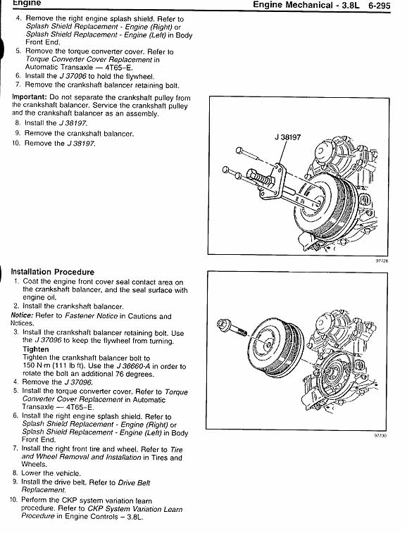

This is from my 2000 Impala 3.8:
Ron

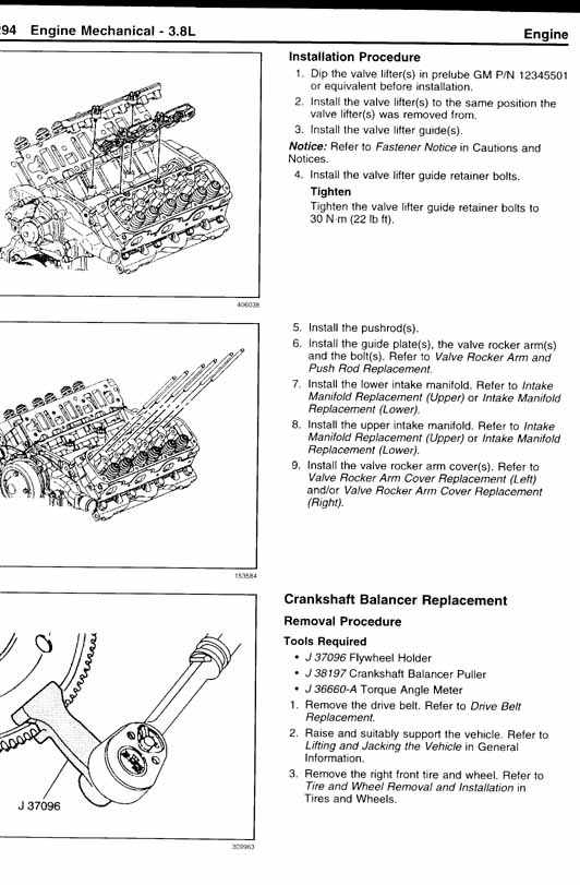

part 2 of 2.

The slots are not threaded, and are a thickish sheet metal, that's all. Got the Haynes back this morning, at the beginning of the front cover removal section it says "a special tool is required to remove the damper from distributorless ignition engines" - lots of help, no picture, description, etc. Then in the text it says to see the previous section when you get to the part about removing the damper. Go to that section, it says "remove bolt, the damper should come off by hand", and has a picture of the distributor-type damper. Oh, well.
The '91 looks a lot different than the picture of the 2000.
