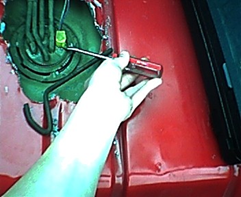

Here is a picture of the electrical connection I am referring to. It's the one the screwdriver is pointing at with the yellow cap. I pried it off with the screwdriver but now I can't get it to stay connected to the plug on the underside.
Yes, I did the cut-the-hole-in-the-trunk method, and no comments about how badly it's hacked up. :-) Once it's completely done I'll recut a perfect square and file it down, and make an access panel and label it "Fuel Pump". But, one thing at a time. :-)

Wow; I've never seen a hole cut like that. How'd you cut it and not go thru to the tank? (I've had to change the pump twice, and had to drop the tank twice... what a pain.)
Why did you pry the connector off in the first place? I wonder if you broke something.

The hole looks actually worse than it is. Looks like I took a chainsaw to it. I actually just drilled holes and cut the metal and then pried it back like a can of tuna using vicegrip pliers. I'm going to cut clean edges with some tin snips or something and then file it down to make a much nicer cut after I'm done.
Why did I pry the connector off? That's a good question. I suppose I didn't have to. :-( Other than to make sure I didn't cut the electrical lines on accident. I guess I could superglue/epoxy the yellow connector back on, but how am I going to get the electrical connector on the underside to stay on
I'm a friggin' genius. :-)
I guess I could try supergluing at the bottom of the pronged connector and see if I can't get that to work. Still doesn't solve my problem of getting the thing to seal to the tank though. Blah.

Try looking at the thing to see if you can find something broken on the connector; I can't remember "exactly" what it looks like, but is it a common GM weatherpack connector that you could find at a parts store? Or is it more of a "pass-thru"? Maybe you could make your own pass-thru...some wires, thru a grommet (where the connector was), and fill the grommet with something that resists gas? I think Ultra Copper gasket maker (in a tube) is gasoline resistant?? Hopefully the gasketmaker or grommet doesn't somehow fall thru into the tank... maybe you could lay some fiberglass matting over the grommet as a "base" to lay the ultra copper over?

I'm just wondering if you stretched a piece of it that was originally "tight", and made the connector lock together, or broke a little plastic clip, or...
Well, I'm hoping that I haven't _already_ knocked something in the tank since it doesn't seem to want to stay. Is that really dangerous though? There's nothing it could get sucked into because of the strainer that hangs into the tank, and if there were something it'd obviously be resistant to gas and wouldn't break down into the gas, so I should think it wouldn't be a problem.
Dangerous for who? Dangerous for the pump, no. Dangerous for you (gas fumes collecting under the car), yeah. But you know what I mean about making your own pass-thru, right? That's what I think that broken connector is/was... a handy way to pass wires thru the metal sending unit top. If you can replicate it somehow... just make sure you get it to seal off.
