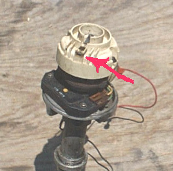

Yea, you've got to loosten the clamp at the bottom - & maybe give the shaft a little bump -but you had it out, right?
You want the little metal thing on the distributor rotor to line up with 1 plug wire, when 1 cylinder is at the top on the compression stroke. So you kinda have to guess where it will be when you put the cap back on.

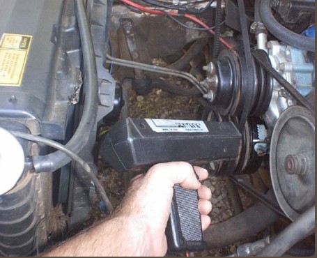

AutoZone or any good Auto supply place should be able to sell you a good 'medium priced' Timing light. I paid about $30 for mine but I got it a long time ago. U dont need the best but U want a decent one - all it is is a strobe light that slaves off your 1 plug. They last forever & they work on all types of engines. (Except diesel)
Dont forget that 1 plug is passenger side on our v6s.
The timing mark is on the Harmonic balancer just below the water pump. On most 2.8's there are 3 marks - one SHOULD be wider than the other two. Mark that one with some white paint / chalk etc. right above it is a scale with some numbers, thats what you use to read it.
(see attached photos)
Attached Thumbnails Dissy reinstall/ engine cranked after removal-distributor.jpg

Looking down on front of motor -
Attached Thumbnails Dissy reinstall/ engine cranked after removal-timinglight2.jpg
