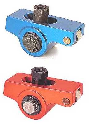

Are Harland Sharp and Proform the same alum. roller rockers? I can't see a difference in the photos - Jegs.

Proform in the blue and Harland Sharp is the other.

If I was to make an uninformed guess, I would say Proform doesn't 'make' anything. Like Sears doesn't 'make' Craftsman. My Craftsman welder is a Century welder painted black instead of red, stickered and packaged Craftsman. If these pictures tell the true about the actual rockers, then I would think these Proform rockers are Harland Sharps that are painted and packaged differently. Why would they be so similar and not be the exact same thing? Why would Craftsman make a welder, and other items, to be an exact replica rather than just contract to buy from proven manufacturers?
Has anyone had their hands on both the Proform and Harland Sharp?

Found a phone number to get some tech info on the Proform rockers. Called them and asked if there was a rating on what the rockers could handle. The gentleman looked it up and said they are safe to 350-400 pounds of spring pressure and the HD are good to 750 pounds.

if looking into higher ratio rockers... the Harland Sharp 1.65 actually check 1.7-1.72, something to keep in mind

they might be the same ..but
proforms don't have lifetime warranties like HSs do.. and I have broken a proform..
