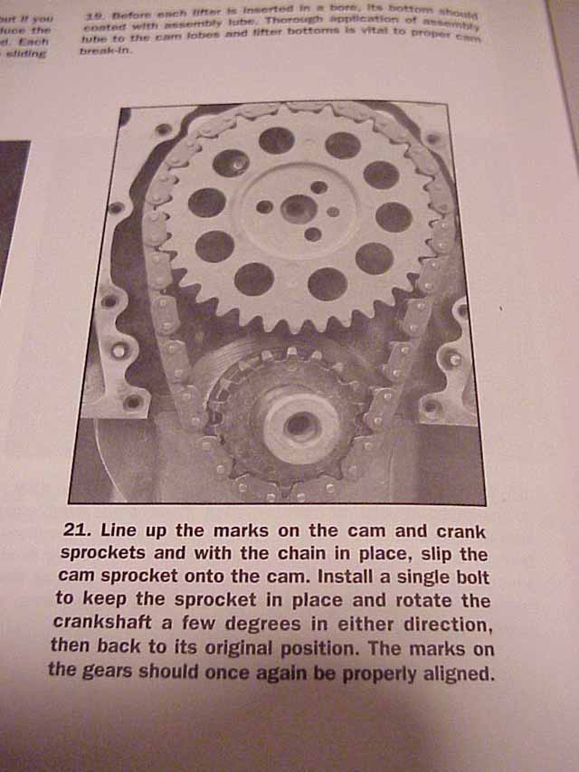

Old Jun 8, 2002 | 10:04 PM
ronterry's Avatar
Joined: Nov 1999
Posts: 1,507
From: Elizabeth, Colorado
Car: '94 Corvette
Whhhhhaaaattttt ???

now im confused. which way should the marks realy be alined? or is there to ways?

Old Jun 9, 2002 | 12:05 AM
Morley's Avatar
Posts: 4,099
Both dots pointing AT EACH OTHER, crank dot at 12 o'clock and cam dot at 6 o'clock.

Engine: 406Ci Vortec SBC
Actually it doesn't matter. Either way will time the cam to the crank. The cam turns at 1/2 speed of the crank. But the easy way is, cam dot @ 6o'clock and crank dot @ 12 o'clock.

Transmission: 700R4/VIG 3200
It doesn't matter if they are dot to dot, or both 12 o'clock. If they are dot to dot drop your distributor in pointing toward the #6 terminal on the cap, if they are aligned 12 and 12 o'clock, drop the distributor in pointing toward the #1 terminal on the cap.
Or. . . align them dot to dot just to make sure they are exactly correct, then turn the crankshaft exactly one revolution and drop the distributor in pointing toward the #1 terminal on the cap.
That is exactly correct....just remember if the dots are:
12 and 6= #6 TDC
12 and 12= #1 TDC
For installation purposes, lining up the dots at 12 and 6 is much easier to see than trying to line them up at 12 and 12.
