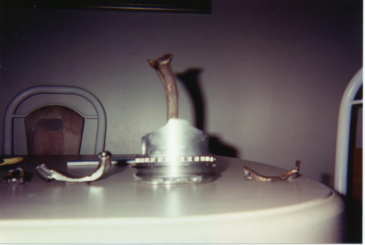

here's an example of a thrown rod. When this happens, just plan on savalaging your exhaust, intake and heads if you're lucky enough to not crack a chamber like I was was. The rod cap is on the left and a rod bearing is on the right.
