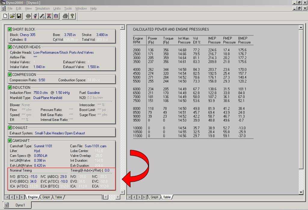

First off, I'm thinkin of getting one of 2 summit cams, the k1100 or k1101.
Are these decent cams for the price?
If not what would you recommend for about the same price?

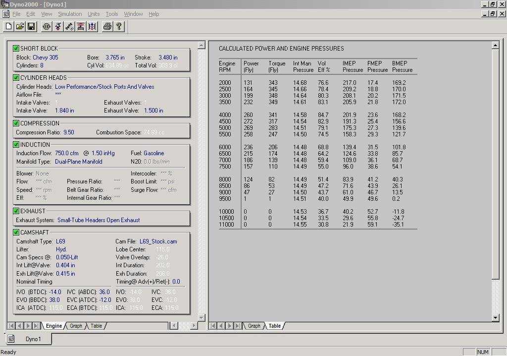

This is what dyno 2k says my L69 had.
Attached Thumbnails Dyno 2000/cam question-screen05.jpg

Here's the sum-k1100.....
Attached Thumbnails Dyno 2000/cam question-screen07.jpg

and the sum-k1101.
btw, what is the stuff at the bottom mean exactly, what I would really like to know is.
What does the initial timing need to be set to?
And how much advance does a vaccum advance distributor give at most?
Attached Thumbnails Dyno 2000/cam question-screen06.jpg

They are all way too tame for your 305.
Get a Crane PowerMax 260 or 266. Or a Comp XE256. All of these cams will run circles around the Summit stuff.
IVO BTDC=intake valve open in degrees before top dead centre
etc.

I don't know 'Sitting Bull', I dig the torque numbers coming in at 2G's with that k1100...That sucker would be a little screamer around town.

The timing is for the cam if its advanced or retarded not the distributor.The other four numbers is the specs on the cam lobes.Then they open and close the valves.
Ron
DD2000 produces wacky torque numbers. Even the peanut cam shows well over 300 foot pounds of torque and that just ain't true.

You guys got to realize the numbers are from real thermodynamic formulas. They are gross out puts, with a perfect running engine, with no internal frictional loss. As someone whos worked out the math, desktop dyno is pretty close. Knock 25% off or so and you'll get numbers you can compare to gm's factory ratings.
Dont use it to get actual numbers, use it to compare changes with parts.

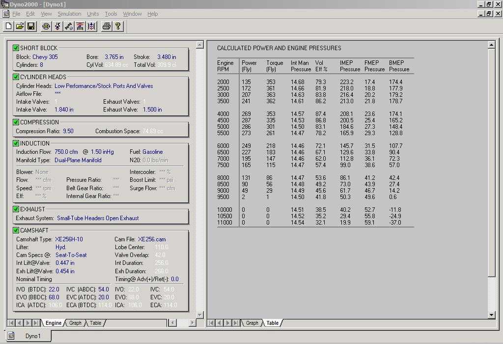

Well this is the XE256, tell me what you think....
Attached Thumbnails Dyno 2000/cam question-screen01.jpg

Looks to me like it thrashes both of the Summit cams by a substantial amount, eh?

What about the XE250?, I'm looking for some low end torque.
And what other mods do you suggest I do before I put her back in?
Thanks for your feedback guys!

OK, here is what the gurus have told me.
-with a 305 you must consider your rear end gear ratio--if you have 2.73s you must go mild with your choice
-a looser torque converter will allow a lumpier cam--if you have the stock 1400 rpm stall converter you must go mild again
--you must keep lift below the .460 range if you have stock springs in the heads
If you have 2.73 gears and want low end torque then the Comp XE 250 and Crane PowerMax 260 are the ones you want. BUT ... the Comp cams are ground on a 110 LSA which is really meant for a 350 engine, not a 305. The Crane 260 is ground on a 112 LSA which works nicely with a 305.
If you have 3.23, 3.42 or 3.73 gears you can step up one grind to the Crane PowerMax 266 with a 114 LSA or XE 256 with a 110 LSA (not recommended for the 305). Of course, the higher the lift and longer the duration, the lumpier the idle and soggier the bottom end torque.
I have a 305 with a Performer intake, QJet, ported and polished heads, headers, Crane PowerMax 260 and 3.42 gears, and I find this cam is still a bit less torquey than the factory peanut cam on the bottom end, i.e., below 2500 rpm. But then it really walks away from the old cam and the 3.42s really compensate on the bottom end too.
All in all, I'd suggest the Crane PM 260 with .427 and .454 lift.
And if you can get a 2000 rpm stall torque converter, everything will work even better yet
Now I suppose you are going to tell me you have a stick???
