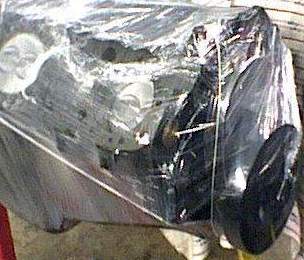

"Where can you find a well built 350 shortblock for 1k$, I've been looking for one."
Where are you? I can ship one to your door for $1000 US+shipping. Pre paid
I am right on the Canadian/ NY border
Shipping will depend on how far away you are.
This is a 350 performance short block
It has:
4 bolt main block
heavy duty performance cast flat top pistons
0 decked block
reground crank, resized rods
new cam , lifters bearings, rings, pistons, oil pump, oil pan , timing cover and frost plugs.
The cam specs are 224/234/.465/.488/112
It is painted and shink wrapped for shippment.
Come see the falls,and pick it up.
email russ_q@yahoo.com
