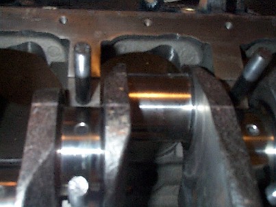

Here you can see where the block was clearanced for the rod: along the oil pan rails and also at the bottoms of the cylinders. I'm using rods that are already clearanced, and I still had to clearance the block.

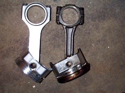

Compare the 383 piston with a 6" rod to the old 350 piston and rod. You can see that the rod bolts don't protrude nearly as much on the Eagle rod. Also you can see that the wrist pin has been moved up on the 383 piston. This one was moved up .25" for the longer stroke, and .30" to compensate for the longer rod.
I think you can use a 350 piston in a 383 if you use a 400 rod, which is 5.565" long instead of the 350's 5.7". I don't know much of the details on that though.
