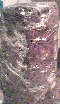

I would pay $500 to $700 (canadian) for a set of 492's
that are ready to go but unported. And not cracked!
thats $300 to $500US.
really depends on the condition, Why does he want to keep the "hardware" ? Is he trying to dump the heads?
Questions you need to ask.
I have a set of fully ported 305 heads with new 1.94x 1.50
valves 3 angle valve job hi perf springs pinned studs etc
Painted bagged ready to go for $600 canadian.
They are for sale......
thats what??..... $375+/- US money.
There are lots of good deals out there.
