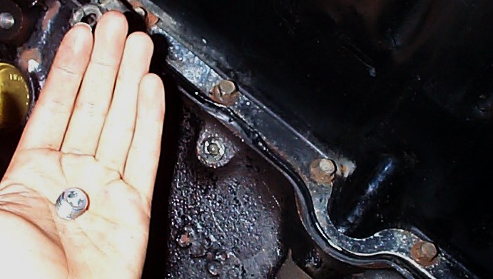

The machine shop that did my block went ahead and put the little freeze plugs in both sides of my block, like where the knock sensor is supposed to go. They are supposed to come out with an allen key, but when I tried to remove it, it stripped out the plug. I thought I could move the knock sensor to the other side, but the plug on that side is about to strip out as well. What the heck am I supposed to do now? How the #@?^@# do I get this thing out? And I refuse to run my car without a knock sensor. The engine is already together, and the machine shop that did the work was through the local parts store. IE, it would have to be shipped out to go back to that shop. What now?

Will WD40 or some sort of penetrant really help? These plugs were put in recently by the machine shop that did my block, it's not as if they've been crusting into place for years or anything. It looks like they used that brown gooey gasket shellac to seal the plugs into the block. Perhaps I should use something that will break that stuff down? Oh and here's a picture of the damage so far. The one in my hand came out of the place where my oil sender is supposed to be. At least I managed to get one of the plugs out.

Yaay!! I got one out! errr, my buddy actually got it out. The plug on the driver side was just starting to round out, so I stopped messing with it. My buddy came by, heated it with a propane torch, then put a little bit of Comet (yes, the kitchen cleaning stuff) in it, then removed it with the same allen wrench I had been using. Apparently the Comet keeps the allen wrench from slipping as easily, so he got it out without rounding out the plug. So I guess I'll just rewire the knock sensor and put it in the driver side of the block.

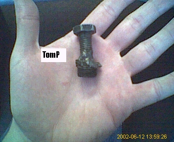

Same thing happened to me when I was doing a 2.8/2.8 swap for my buddy. There was a pipe plug on the $100 donor motor, where there should've been an empty hole for the fan switch. We tried grinding a bolt down into a square, and using that... well he didn't do a perfect job of grinding, and we wiped out the square hole. Nothing worked until I went home and got my MIG welder...
Did you try using a flathead screwdriver and some vice grips?
