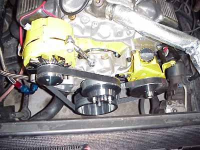

Had the same problem!!!
I bought a set of March Performance serpentine pulleys for 200 umpteen dollars.
The alignment is perfect! & the pulleys are 6 ribs.
Summit Racing Price:
MCH-6380 High water flow/Long water pump $191.95
MCH-624 Matching Power Steering Pulley $72.39
Ron

BTW: before I did anything to my old pulleys, I used water pump pulleys shims, and washers to get my old pulleys to line up. It wasn't till I starter pushing >6000rpms that my damn alt belt would wrap up on my water pump, and I was at risk of destoying a very expensive race motor, and aluminum water pump. That's when I put up the money for new pulleys!!!
Ron
