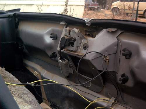

d00d take the whole assebly off and put it on like this. found the pic on another post with very little info.
then sell the motorized one to someone who wants to fix it. I still have to sell mine. Anyone wants it, its only $20 for the broken assembly. You pay for shipping also, wont be much its realy small. I keep the switch and that stuff.

While you are at it, don't forget to cut the mount for the slam-style latch from another car while you are at the pick-a-part yard so you can weld it into your car. For you'll notice on closer observation that the mounting for a 1982-85 slam-style latch is completly different than a 1986-91 hatch pull-down unit mounts. The 1991-1/2 to 92 is also different. If all that hacking and welding sounds easier than repairing your existing pull-down unit, I guess we have a different opinion of the task.
