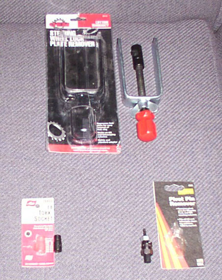

Arrggh! Went to quite a few different stores and NO ONE, not a single one carried a Lock Plate Depressor. Can anyone please list a few places that SHOULD carry this part. I don't want to attempt this job without the proper tools.

You don't need it. Find a buddy. One of you can push on the lock plate while the other removes the retaining ring.
By far the biggest ***** of the entire project is reinstalling that ring. That tool would make life MUCH easier. In my case, I pushed on it with a 2x4 while my father put the retaining ring back in. It took a few tries, and had I know that there was a tool available, I probably would have bought it. But... if you can't find it, it's not absolutely necessary to have.

Fruity,
Sorry, I didn't answer these questions earlier..
Autozone has both the lock plate remover and the steering wheel remover for loan.. I think one is $15 and the other $25. You'll get your money back when you return them..
You can muscle it out with a friend but the right tools make is really easy.. like you said, "do it once and do it right."
I'm surprised NAPA didn't have one.. =o' They usually have everything or know where you can get one....
Apparently Pep boys has the tilt steering pin puller for $9. At least that's what I was told by another person who used my tech article to fix his tilt steering..
Both You and Vader were right, assuming you take your time and clean/degrease/locktite the parts that need it it should only take about 2 to 3 hours.
It took us around 4 1/2 hours because we didn't have the pin puller, and we still didn't get to the other 3. I'll really have to fix it sometime this week. Honestly though, Both Vader, and Bruce provided excellent directions and with the 3 right tools this job is easy as can be. Unfortunately if you don't have the right tools you'll spend days on this project.
Since I pulled it apart twice in one day I expect that it'll only take about 1 to 2 hours if I'm lazy when I fix it permanantly next time. I'll also take pictures so that they can later be added to the article that bruce submitted to the board.

Does anyone else know where I can get a tilt steering pin remover? Is there an online place I can get one at?
So far, I've been to:
NAPA
CarQuest
Autozone
Pep Boys
...anywhere else I can go?
NAPA
CarQuest
Autozone
Pep Boys
F-One and the Tilt Krew,
If you go back and read my post with the instructiojns, you'll find that all you need is an 8-32 bolt and nut. That should set you back a whole 50¢ - if the hardware store is overpriced.
I use a screw, nut, a ½" 12-point socket with ¼" drive, and a washer or two to jack the pins out without damaging anything. If your car happens to have a metric thread in the pivot pins, you'll just have to find the right bolt and nut combination. My '94 still has an 8-32, however.
Joined: Sep 2002
Posts: 2,967
From: Elk Grove Village, IL
Car: 1989 TransAm GTA
Engine: One sweet modified 355 TPI.
Transmission: The kind that shifts....
MWahahahaha!!! I have successfully fixed my tilt column!! And even come up with a small, cheap and easy way to get the locking plate retainer clip off! I used some nice strong thread and tied it into a slip knot. Then I looped it on the ring. Using a small flathead screwdriver I pulled on the string so I could get the flat head underneath the ring. Once it was under the ring it was easy as pie.

If anybody wants to try this.Ive done it myself for removing/installing the lock ring.First you will need 2 sockets a 1/2 & 9/16,a large dia washer(not too thick)w/a hole big enough for the steering shaft.Put the 2 sockets side by side,but seperated by the steering shaft.Put the washer on the shaft over the 2 sockets.Then use the steering shaft nut to push the washer/sockets/lock ring plate down.This will give you room to remove the lock ring using to small flat head screwdrivers or ?..Its a little tricky,but its worked for me many times over.Installation is in reversal of removal.
Joined: Sep 2002
Posts: 2,967
I'll just go rent a lock plate remover for free..thats much easier. Thanks for the tip though. Perhaps I may need it in the future.

okay can someone please help me,ive torn apart my column as in the steps above,everything has been easyier than i thought so far. Im at the point where i have to pull out the pivot pins, ive made the tool as decribed above and everysingle time ive snapped the bolt! This really suck,over a period of 2 days ive got through 39 bolts now!!! This is terrible,is there any other way to get these out!!!??? please help!
Joined: Sep 2002
Posts: 2,967
How have you snapped the bolts? The pins are in there pretty tight but not enough to twist a bolt and snap it. If thats your case buy the tilt steering pin remover from a Mac man, or a snap-on man. It'll cost about $20.
The pivot pin puller works just like a steering wheel puller, and exerts pressure on the side to pull the pin out.
Is the socket big enough to clear the diameter of the pivot pin?

hehe,well,yes it was big enough to clear the pin. And long story short,i bought a snap on pivot pin puller for $50 (canadian) and broke it! The pin was in so tight it mushroomed the collar on the tool and stripped out all of its threads!
I did finally get it out with wd40,prying at the pin with a screwdriver from the inside of the column and using the first ghetto rigged tool! It was coated in loc tight! thats why it wouldnt come out
and guess what,snap on wont even warranty the tool!
**** me off!
**** me off!
